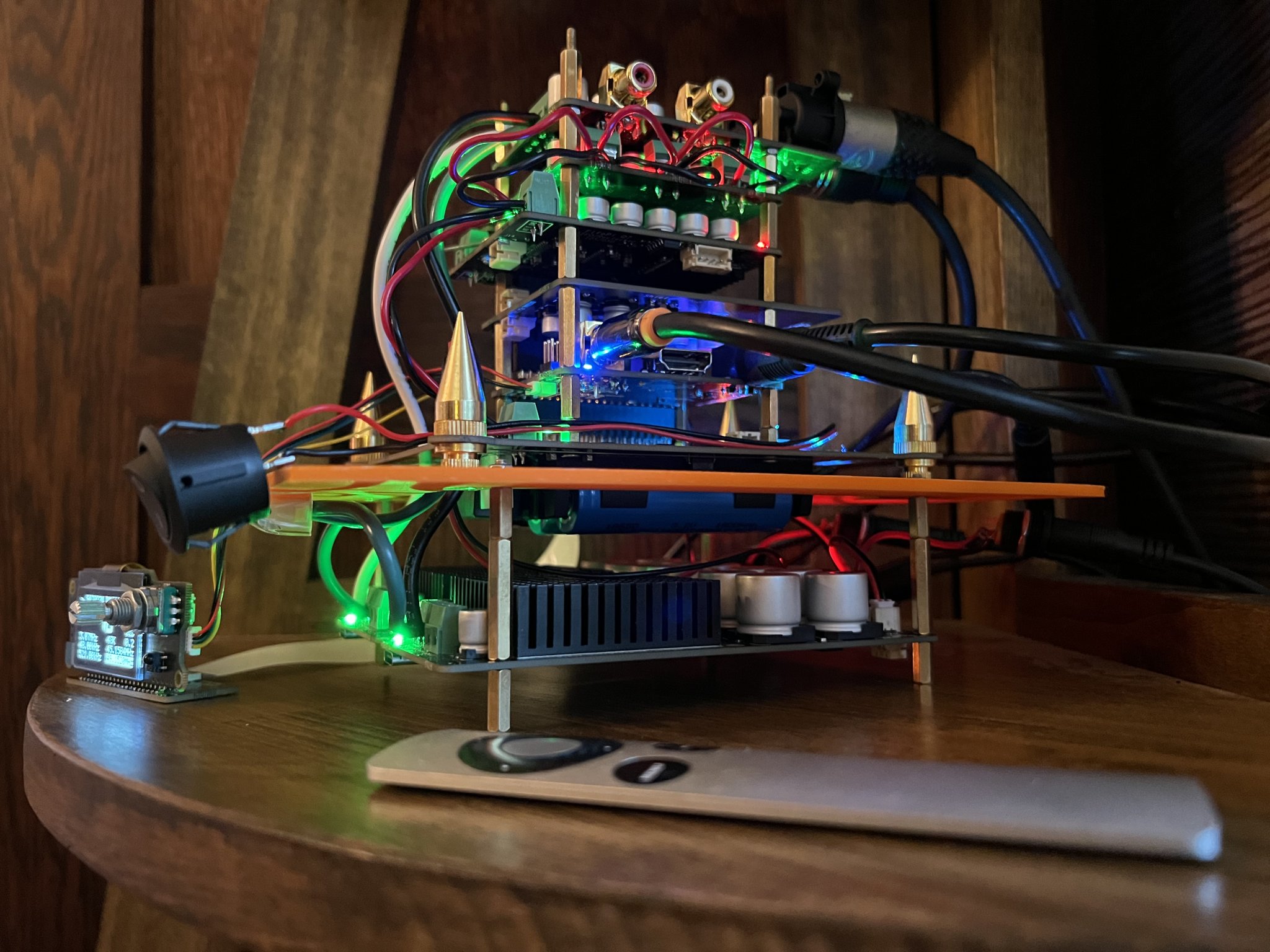

I would love some feedback on this build. Shortened up the power cables feeding the analogue stage.

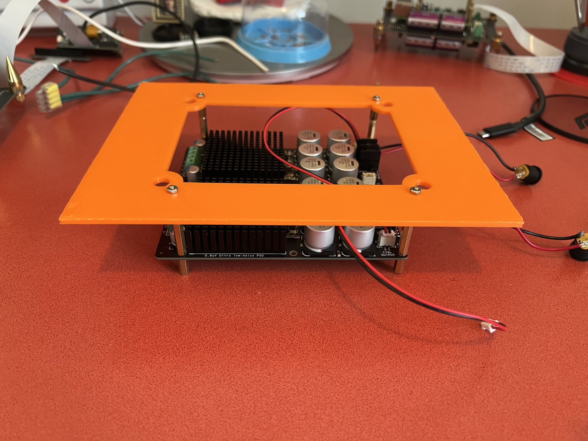

I made a plate on my 3D printer to separate the LinearPi Duo and the DAC stack. Are they too close??? I don’t really feel heat over the linearPi duo heat sinks???

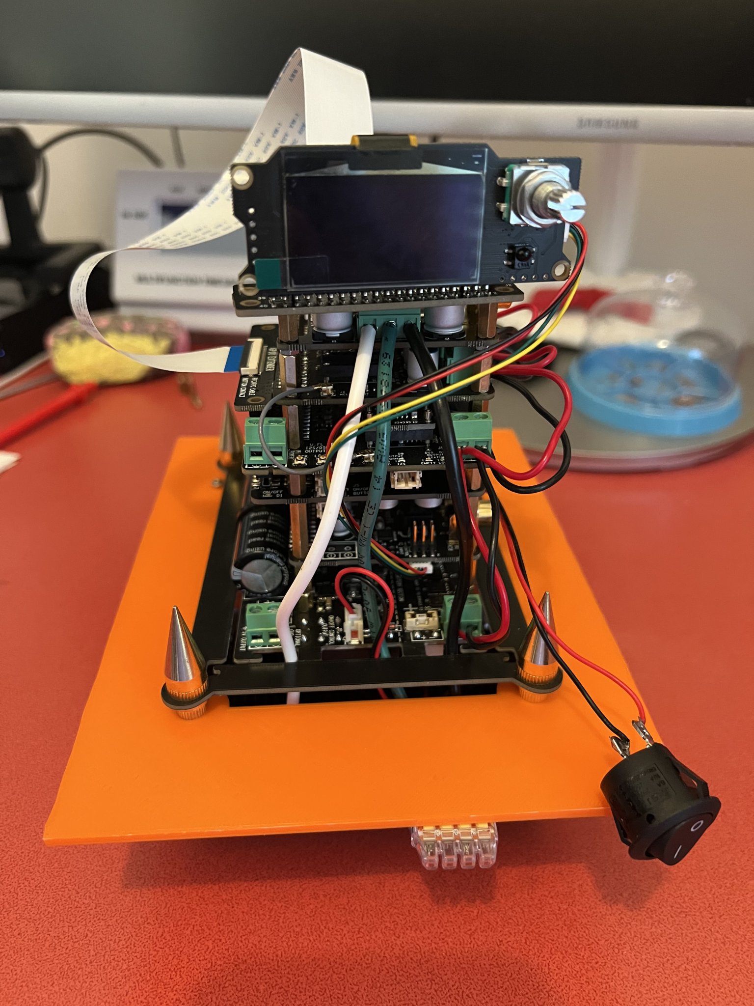

@WladimirMXPHello friends,
wow didn't expect so many questions, I'll try to answer them.
The tower consists of:
PurePi
Rpi 3b (non-plus, just v1.2)
3mm copper cooling/shielding plate
Now onto Ians' boards:
ShieldPi Pro
Isolator II
FifoPiMa with Accus
Teradak shielding/filtering board
TransportPi AES
and obviously UcConditioner
DC cables are OCC copper/silver NEOTECH CU-AG-20-20 and now testing Mundorf Pure Silver/Gold 18AWG.
Plus there are some more important tweaks thorough and special care went to vibration isolation/absorption.
Also as @badd99 pointed out, Gentooplayer with Diretta is an important piece of it as well, especially when tweaked with kernel selection and other more tweaky tweaksBenefits of having Diretta is like instantly having the best LAN cable out there and btw Diretta is free for playing redbook format. Other than an endpoint like this (or any other Rpi), you just need to set up a second source PC or RPi, connect those two on your network or directly as an server ("host") & endpoint ("target") and play
Could you please provide Teradak shielding/filtering board link and more details on that? how is this supported in between?
After having ShieldPi Pro, do we still need shielding plate? will that be additional support?
