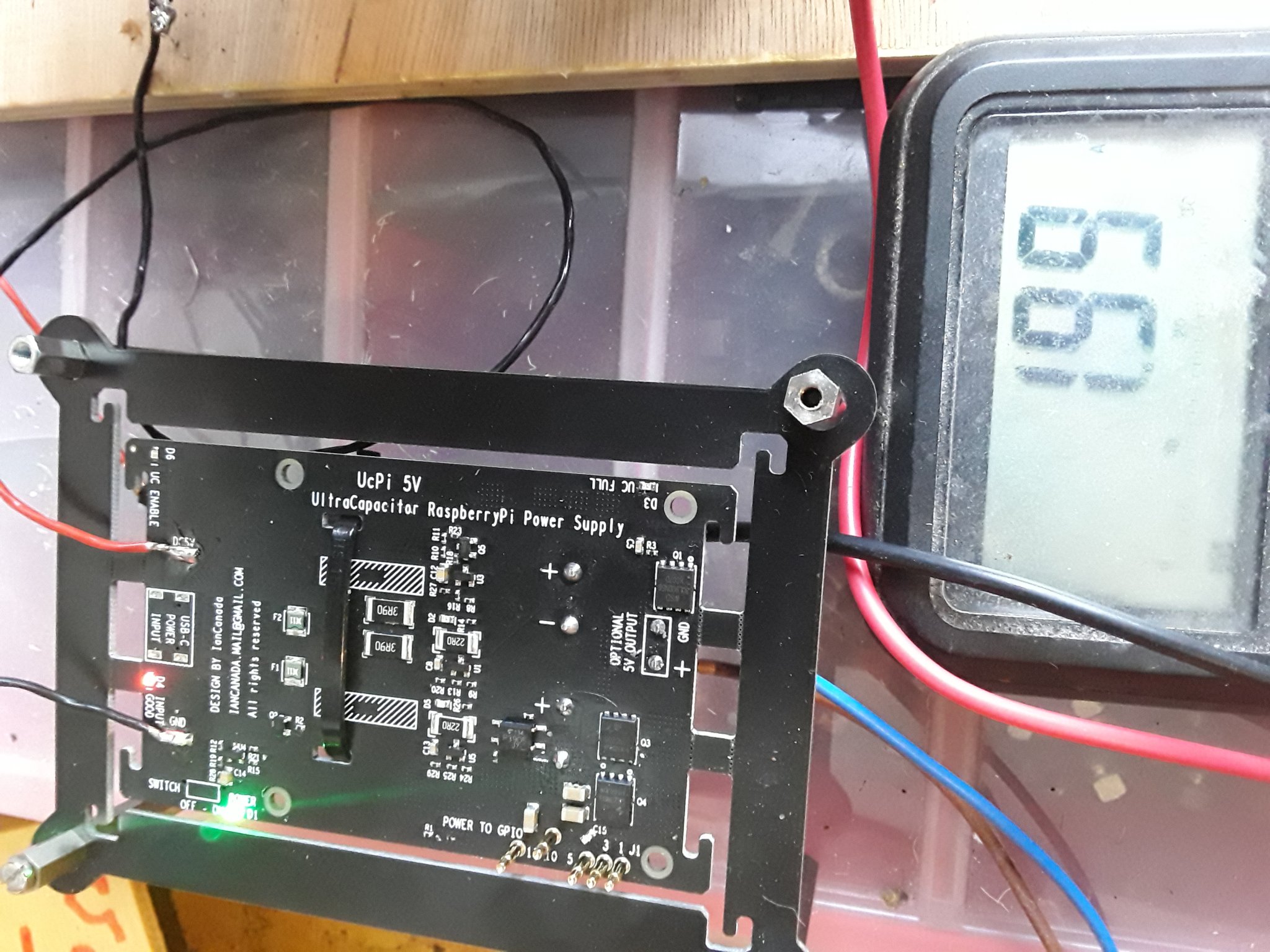

Hello,
I had to recharge batteries of my digital meters.
With the switch on the pure pi board in on position ( so connected to a 2A load created by a resistor string in my test set up) and ultracaps drained the top load was around 2,8 A in on position going down to only 2A in a few minutes..
So if you have a remote switch it would be nice and let the charged caps function as a kind of powerbank?during start up . I dont have a Christmas tree nor an ssd
INDEED if you use a serious output board and a serious supply the wire in between those two should be 5 inches. Probably they wont dissipate any heat so can be mounted on top of each other.

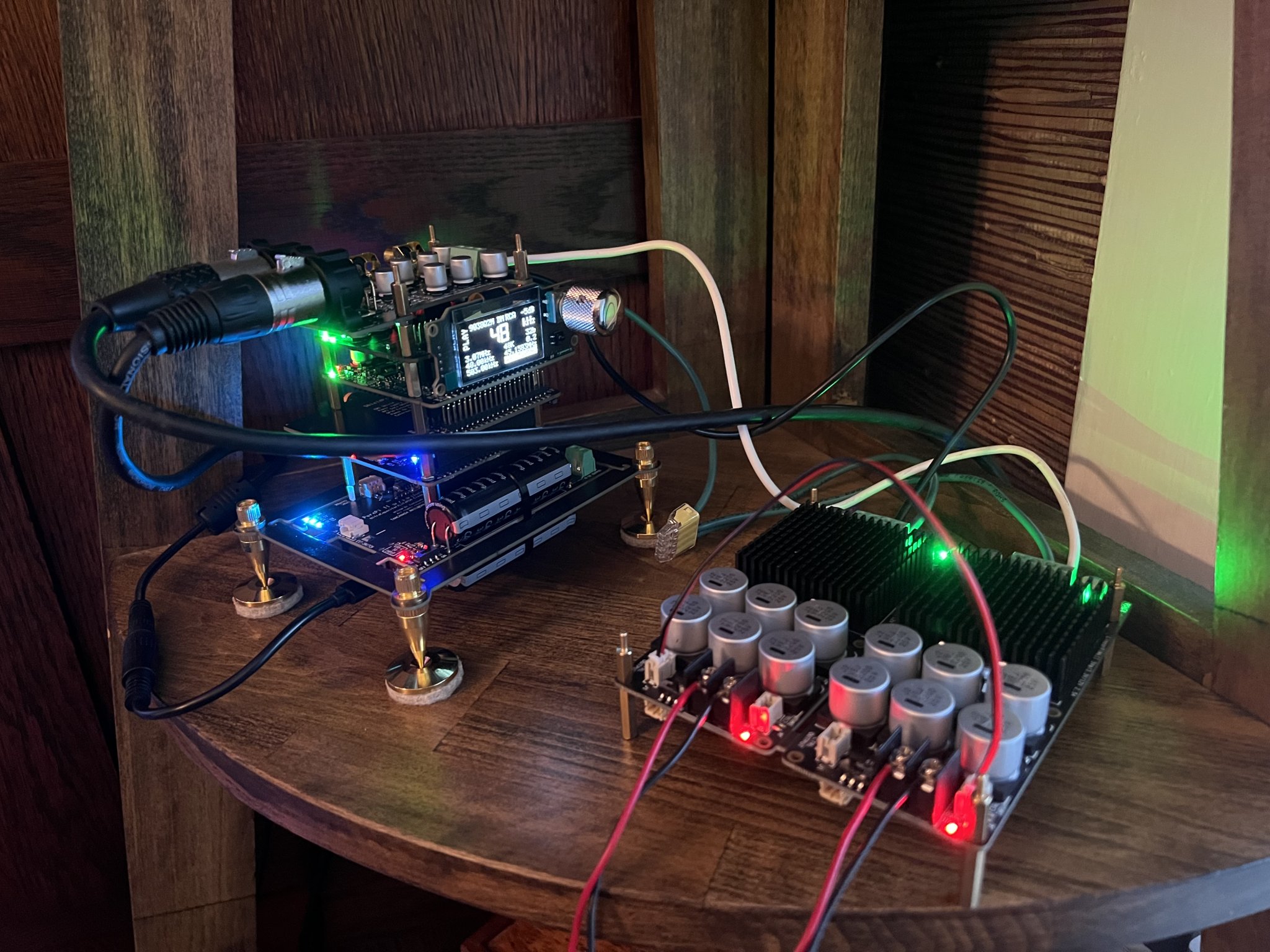

When I switched to cheap 3A supply no issues. The guide for RPi4 says 3A is max draw.
I realize most of you don’t run screens and drives or you do on a separate system. My prep of concept was SSD and screen attached to the Volumio streamer.

I have just got this working finally on a PiLess DAC Stack recently posted above. My comparison is the the output stage of a Cambridge Audio DACMagic 200M with same amp and speakers and sources. The input source is a Denon 200USB turntable going through an ADC audio converter from turntable Lineout to a RCA S/PIDIF output running into IAN DAC Stack:
Then into two Focal Audio 50 professional monitors (powered monitor with XLR inputs).
What stands out
1) Neither too warm and mushy, nor ice-picky harsh, but very in between showing all the details of the source with neither of those drawbacks.
2) Soundstage. Instead of just hearing where the instruments are...you can pick out where the high hats, crash rides etc are - they reveal themselves in different spots. Like the drum kit has its own soundstage within the soundstage.
3) Bass. The bass runs in the music really pop and the clarity of the low frequencies to me stand out as the biggest difference I hear.
This is really incredible as my source turntable is not really a hifi piece of gear, and the ADC is really just because it's the only way I have to get something into this DAC stack until I rebuild my streamer stack as I have had shared components. Eventually I'l have a hifi turnable im building and a Phono Pre-Amp with optical out for convenience (as I'm using my DAC as the pre-amp and my main source is FLAC via the streamer).

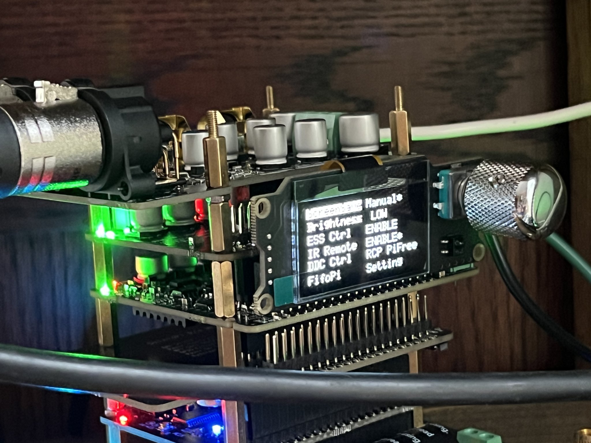

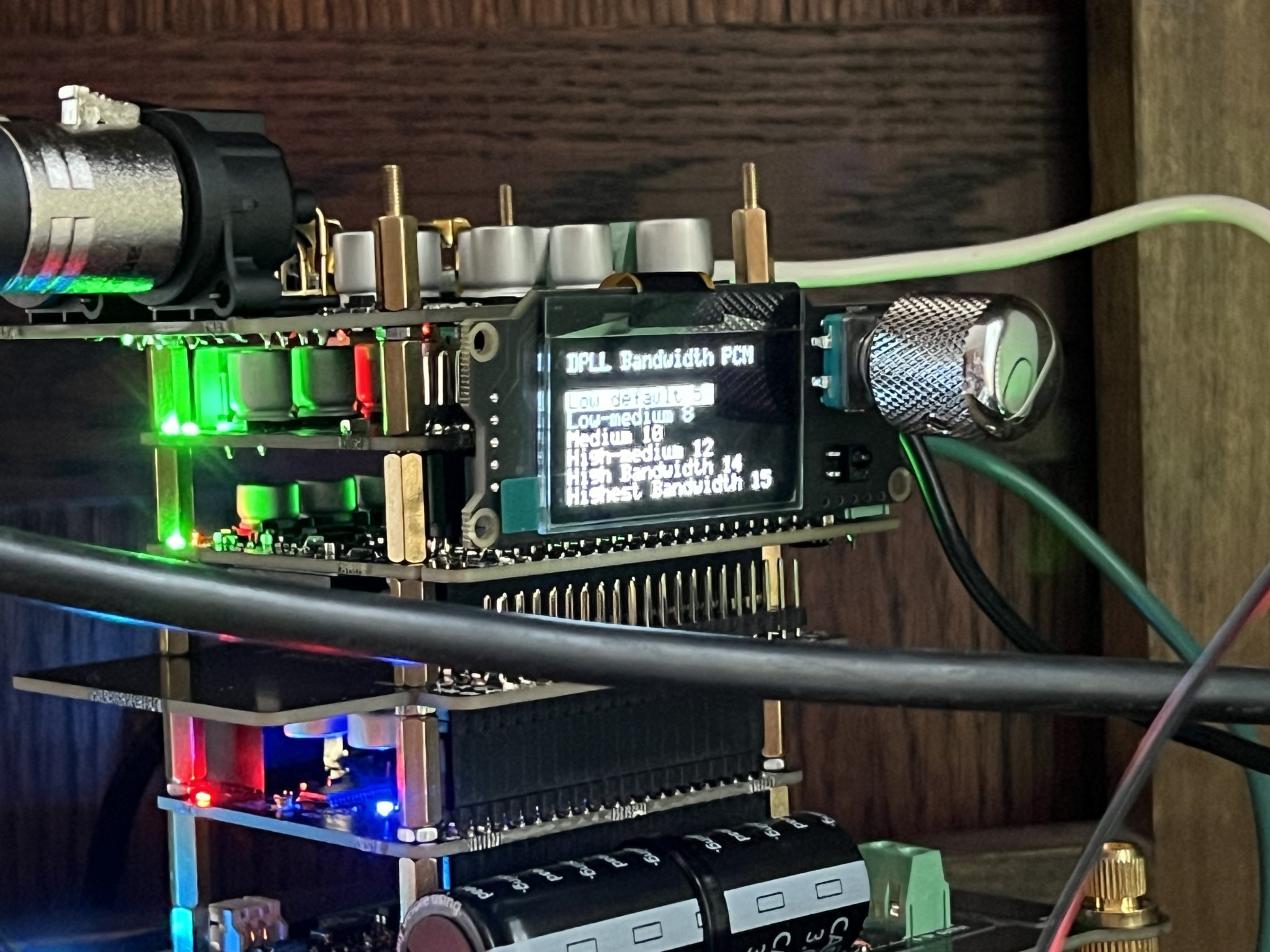

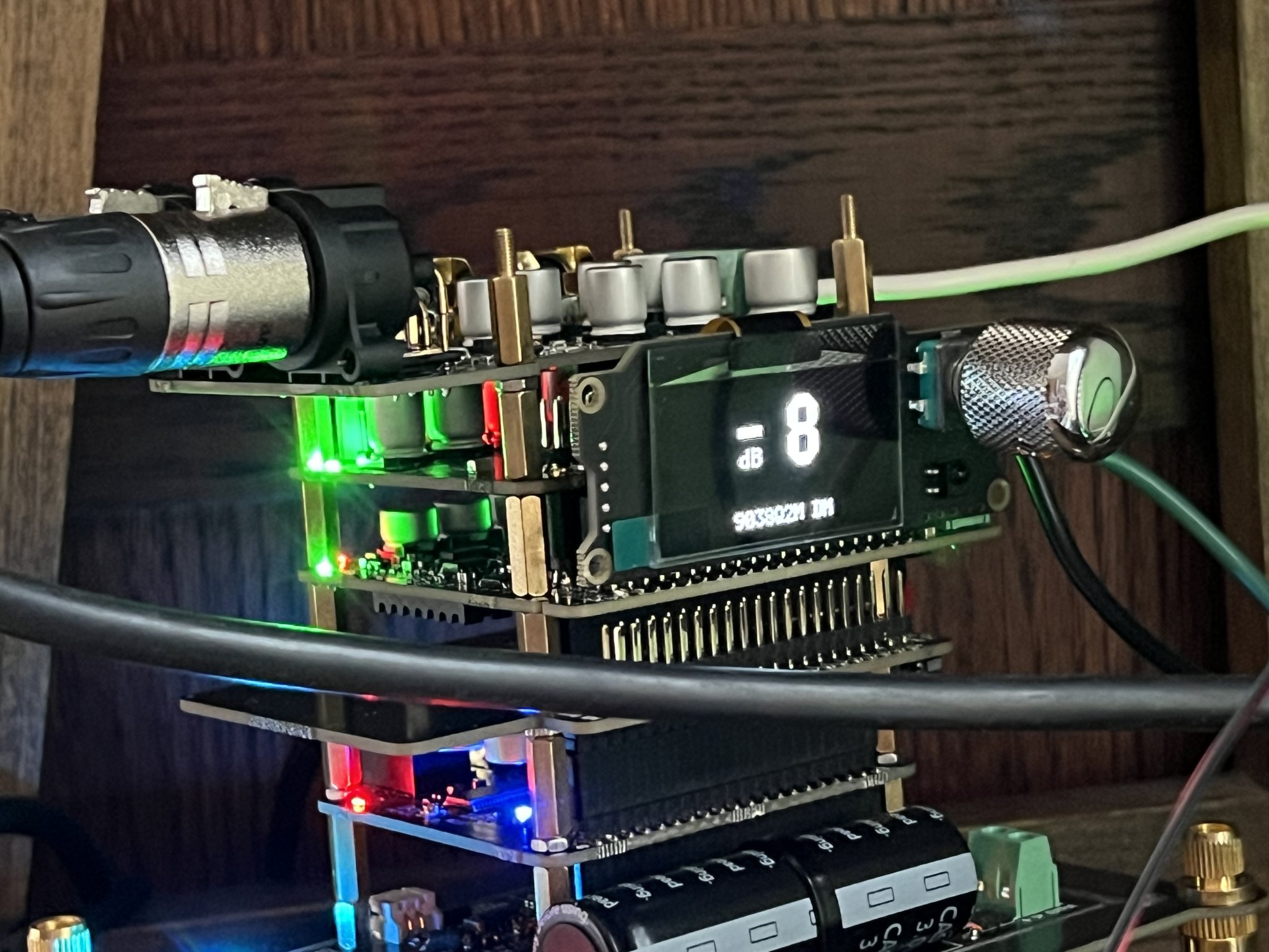

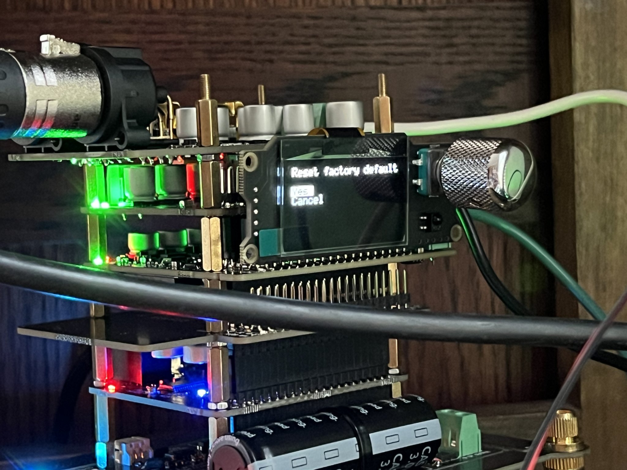

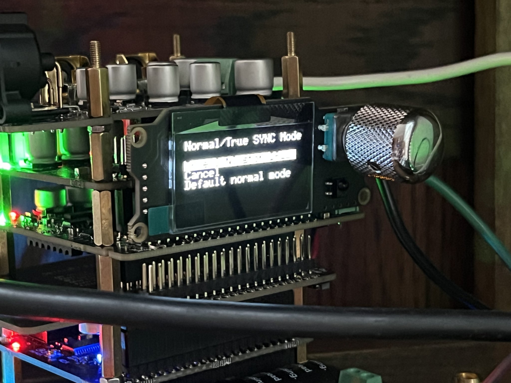

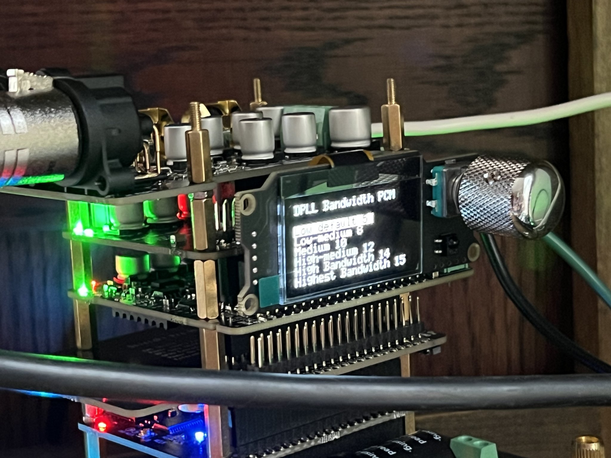

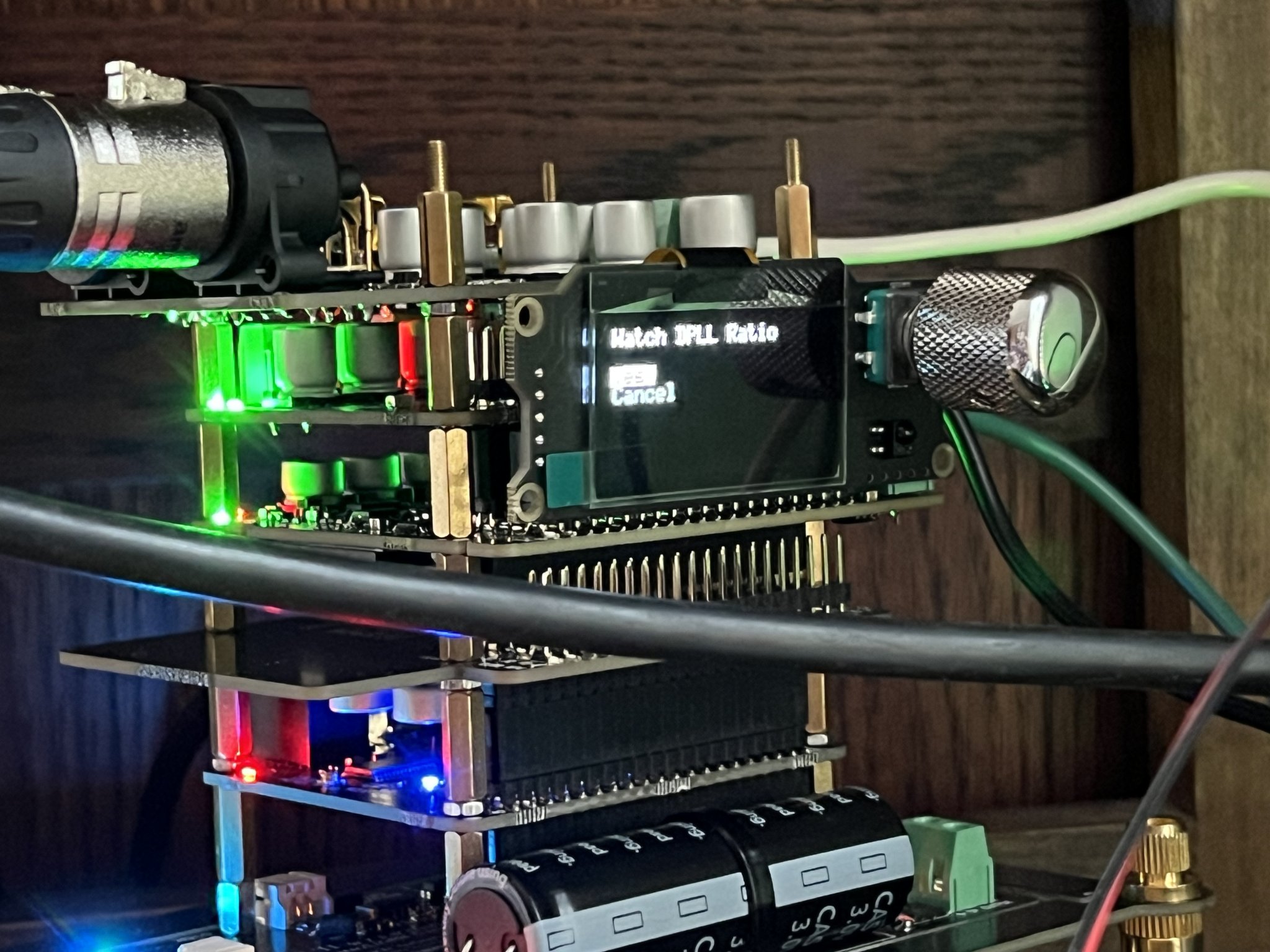

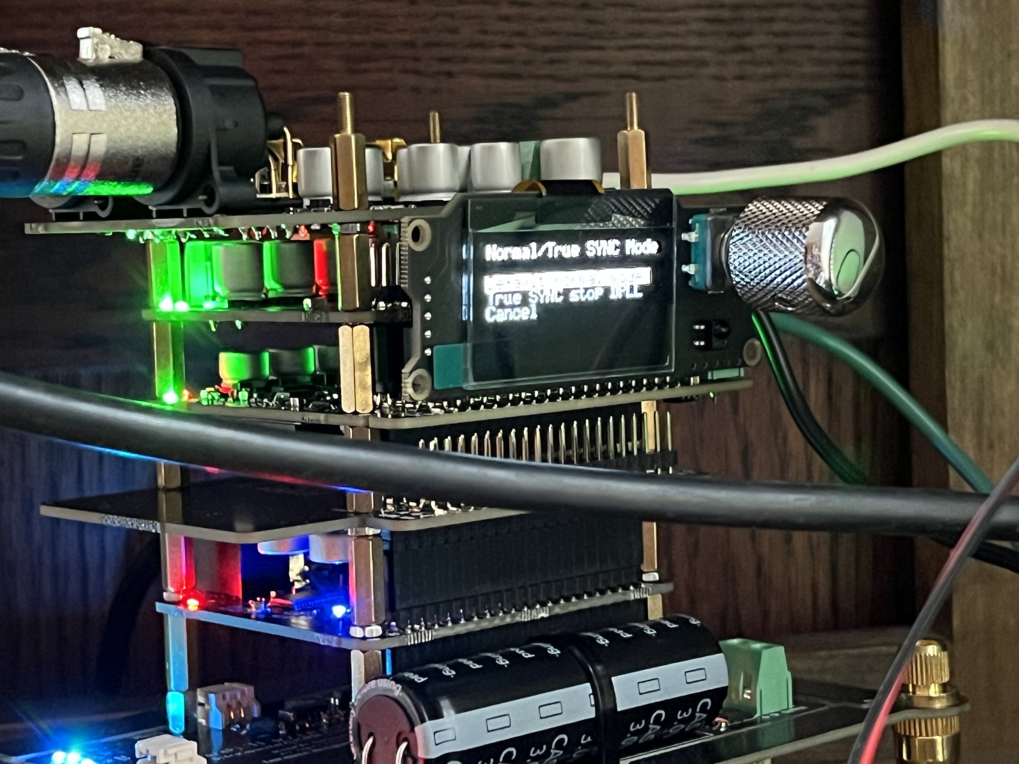

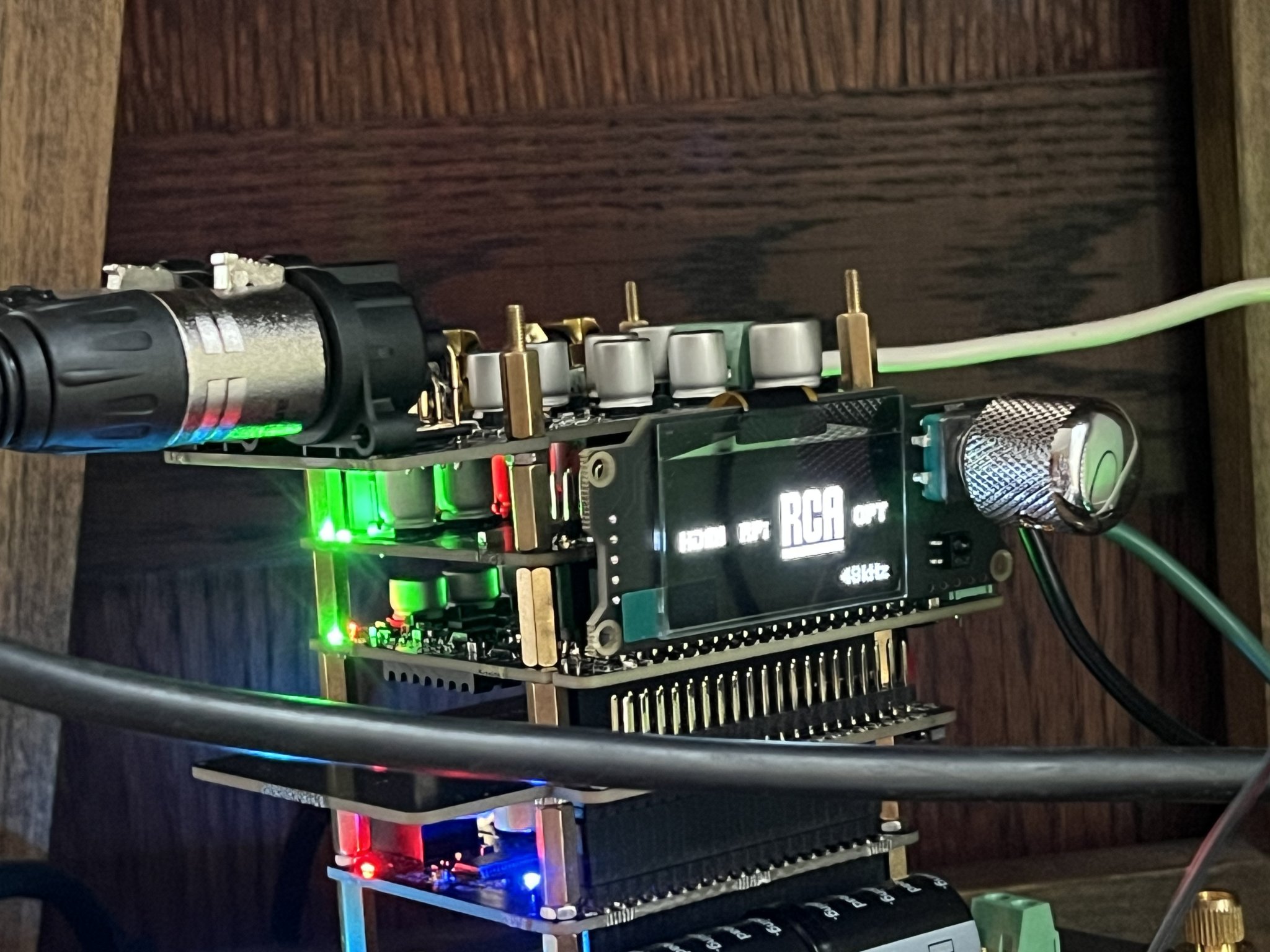

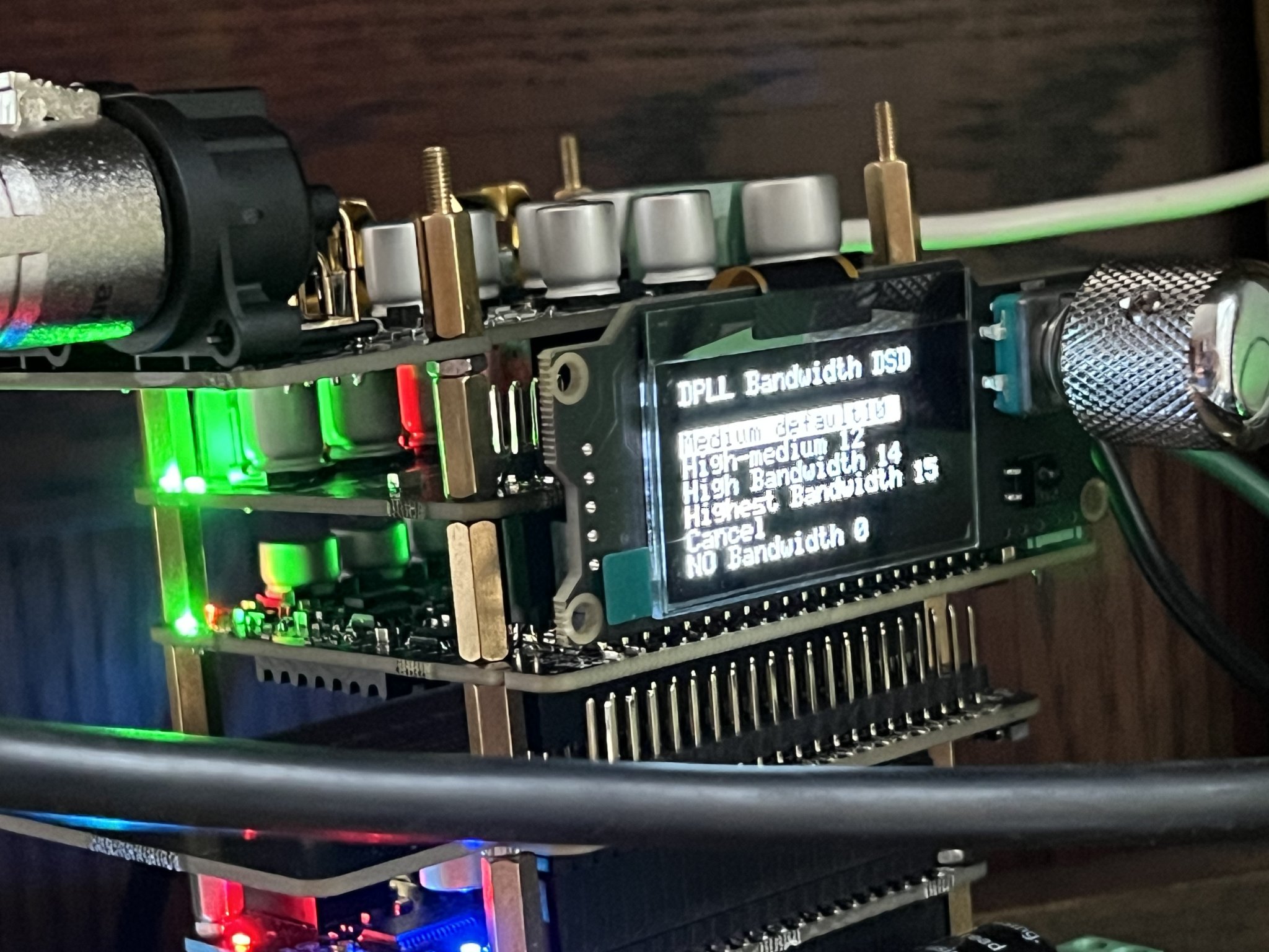

Hi all,

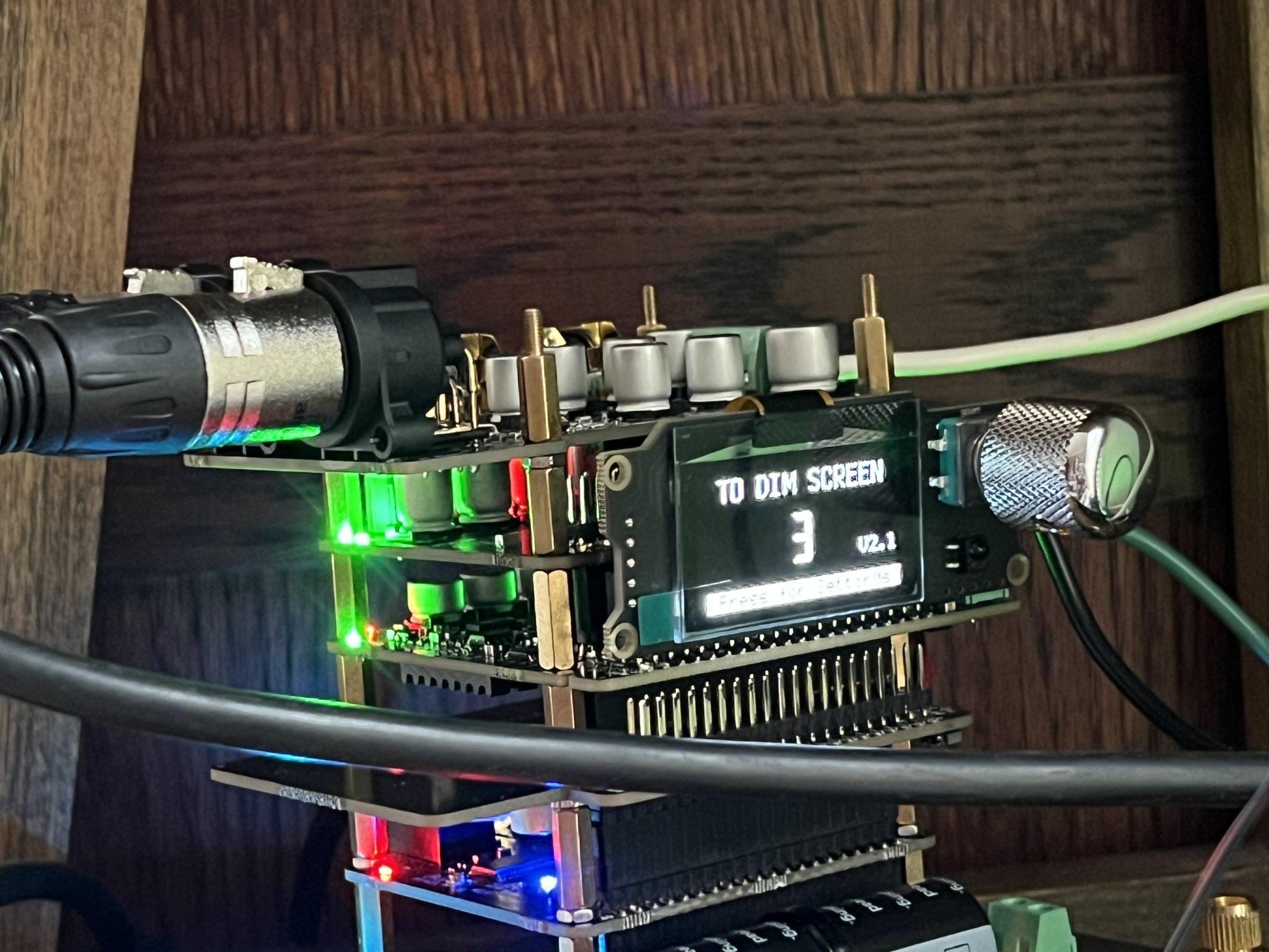

The new MonitorPi Pro can do a lot. Here are some screenshots. I have this running on the PiLess DAC Stack that I recently posted.
Main Screen
Press Up or Down on remote and get Volume control instantly there
First Config Screen
Press Center Botton to mute screen (and I think connect a jumper to also mute music)
Press left or right to select source

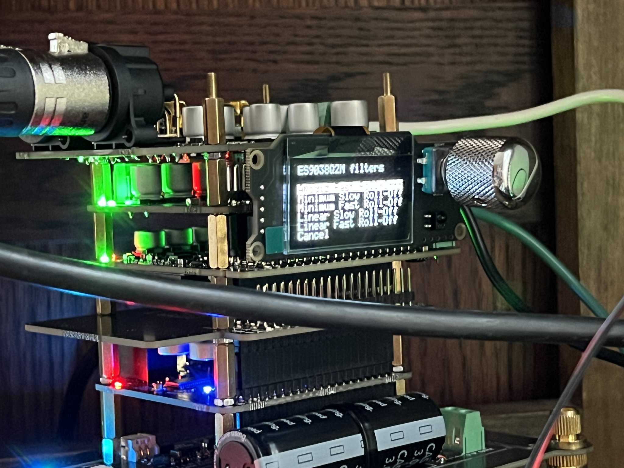

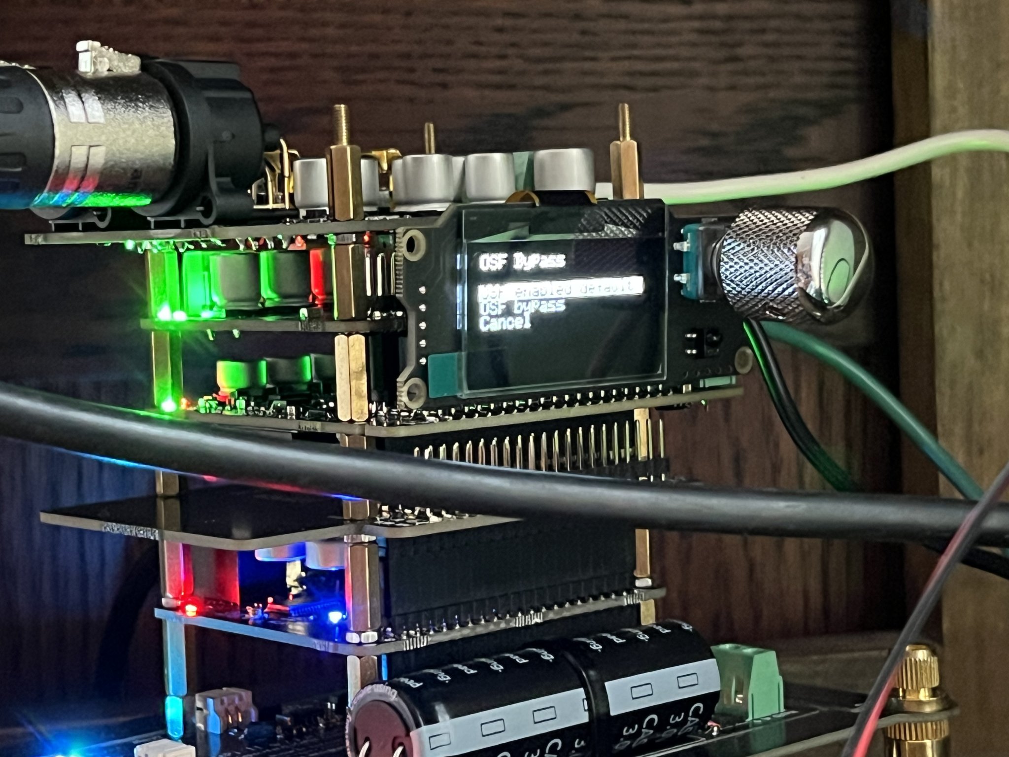

Once into a source (volume mode) press centre button twice to get ESS config screens @iancanada - is this saved per source?
There are more screens. This is just scratching the surface.
You can also use the knob on the MPiPro.
Main Screen
![IMG_8183.jpeg IMG_8183.jpeg](https://www.diyaudio.com/community/data/attachments/1119/1119670-48579d2436f0141ab107030eef521a4b.jpg)
![IMG_8184.jpeg IMG_8184.jpeg](https://www.diyaudio.com/community/data/attachments/1119/1119671-19f6dfbf9a962fd4213095e646d4f1b3.jpg)
![IMG_8185.jpeg IMG_8185.jpeg](https://www.diyaudio.com/community/data/attachments/1119/1119672-cd2601782ef585a37c57e37afa80aa96.jpg)
First Config Screen
![IMG_8203.jpeg IMG_8203.jpeg](https://www.diyaudio.com/community/data/attachments/1119/1119669-ca0024760bb4e2e1cb0434af1ee3f332.jpg)
![IMG_8186.jpeg IMG_8186.jpeg](https://www.diyaudio.com/community/data/attachments/1119/1119673-d49e5049f780e28e8db3d52af510c2fe.jpg)
![IMG_8187.jpeg IMG_8187.jpeg](https://www.diyaudio.com/community/data/attachments/1119/1119674-6e0264c1b2a6c12456087ae0055c4da6.jpg)
![IMG_8188.jpeg IMG_8188.jpeg](https://www.diyaudio.com/community/data/attachments/1119/1119675-d46c86f2c58f56e2528da69b4053b8ef.jpg)
![IMG_8190.jpeg IMG_8190.jpeg](https://www.diyaudio.com/community/data/attachments/1119/1119676-cd775a195eba0531541e9fca582b318c.jpg)
![IMG_8204.jpeg IMG_8204.jpeg](https://www.diyaudio.com/community/data/attachments/1119/1119685-d9ff0a6466df4adf2ec9d4389da428e2.jpg)
![IMG_8195.jpeg IMG_8195.jpeg](https://www.diyaudio.com/community/data/attachments/1119/1119677-97410244aaaec52a7528bcc2e98bedee.jpg)
![IMG_8196.jpeg IMG_8196.jpeg](https://www.diyaudio.com/community/data/attachments/1119/1119678-22c12e50d0d740c3a50fee19f9137a57.jpg)
![IMG_8197.jpeg IMG_8197.jpeg](https://www.diyaudio.com/community/data/attachments/1119/1119679-2dd5301dab212e265a84f3825282f2e9.jpg)
![IMG_8198.jpeg IMG_8198.jpeg](https://www.diyaudio.com/community/data/attachments/1119/1119680-75e21e5933aeb75334a01c22d1ce561c.jpg)
![IMG_8199.jpeg IMG_8199.jpeg](https://www.diyaudio.com/community/data/attachments/1119/1119681-bb9ac9e2b7f08706d13f6bb1fbebb667.jpg)
![IMG_8200.jpeg IMG_8200.jpeg](https://www.diyaudio.com/community/data/attachments/1119/1119682-802f6a7b8ab129aae970142d435e53cb.jpg)
Yep. There is another layer of "veil" lifted off the music. I hear it mostly in the vocals I think but it is overall more clarity yet again.

I also tried the filters. I'll have to wait and really listen. Not much difference to me, but the true sync mode was definitely change for better.

Hello,I was able to do this. I definitely heard a discernible difference - I think for the better.
I think this means I can't play DSD but I haven't yet got into that format.

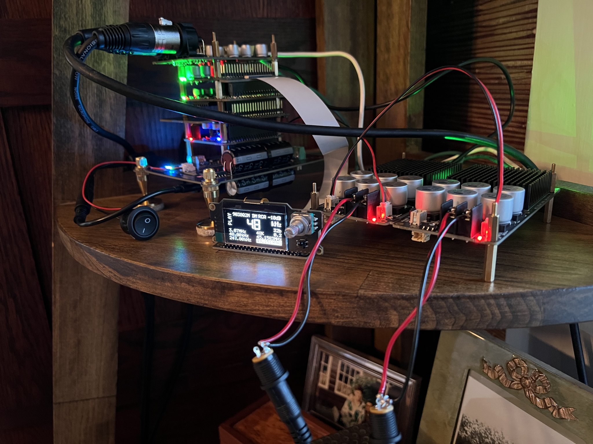

I have wired a switch to the PurePiII and made everything else slave to that switch.
I have put the GPIO extender on to get the screen and switch to test for enclosure.
The only thing i can't figure out is the MUTE function on MonitorPiPro. When I used it on the streamer stack I could mute the player, but here it's just a DAC - how do I setup to just mute the sound - does anyone know. I don't see it in the manual for MPiPro, but I will re-read it again.
