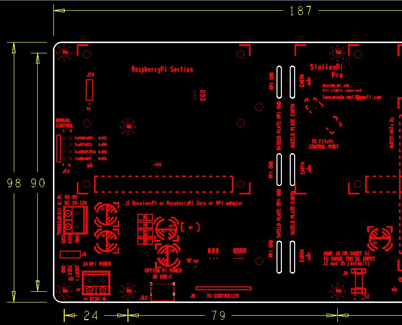

Please download the dxf fileHi Ian,
@iancanada
I 'am redesigning my DAC-box. Since it is build in an existing box I 'am not able to measure the mounting holes from the StatoinPi-Pro.
Luckily the manual has a layout published. However it is not complete. One number from a hole is missing.
Please see my attachment and the yellow mark on it. One number is 24 MM (horizontal); do you have the second number (vertical)?
Thank you, Jan
https://github.com/iancanada/DocumentDownload/tree/master/Adapters/StationPiPro

Hi Ian,Please download the dxf file
Yes I found that file however also there is this number not mentioned in the drawing.
See attachment.
Thank you, Jan

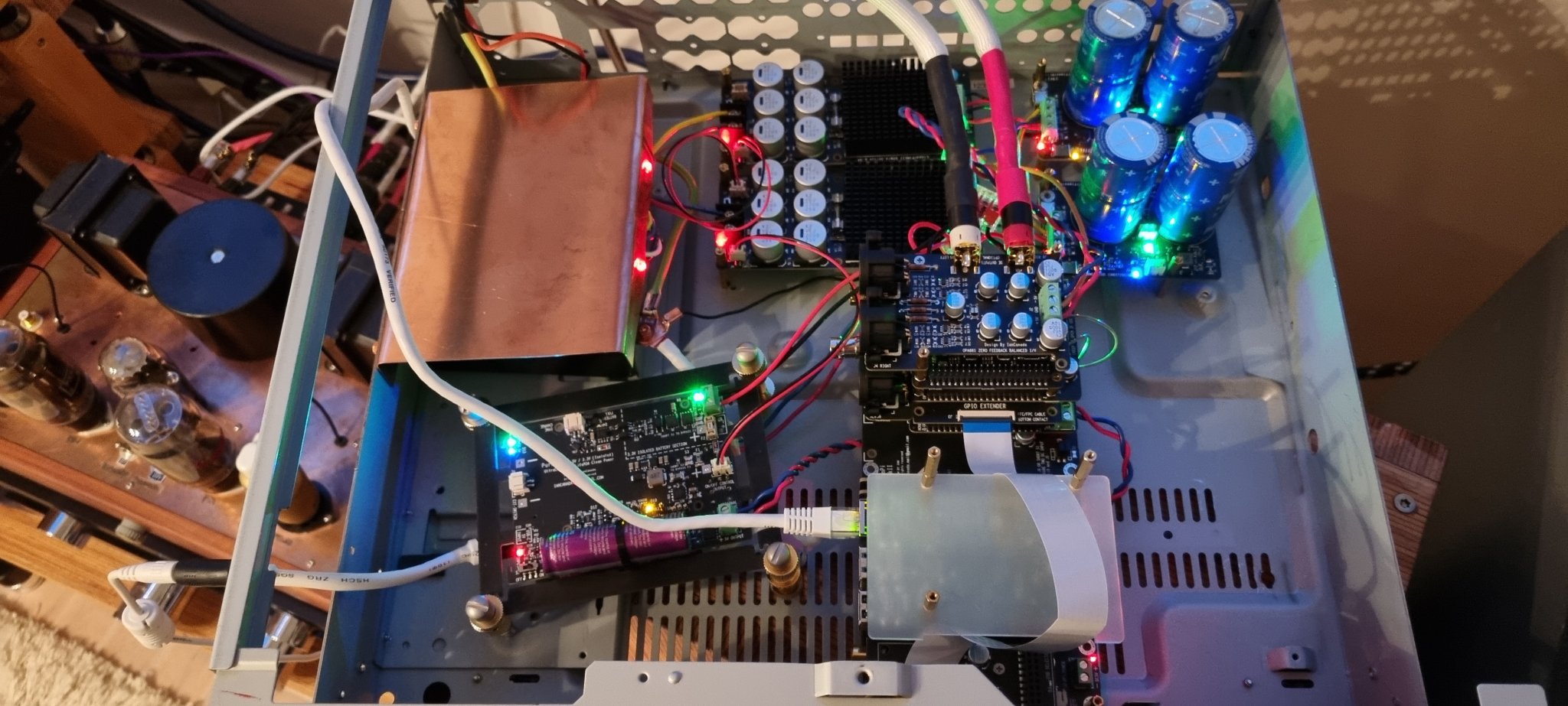

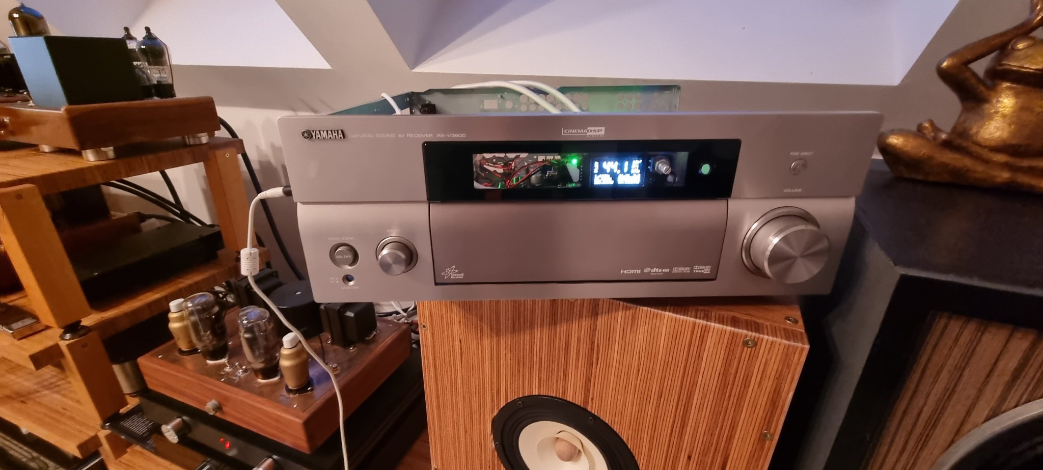

Some feedback from an Ian DAC-builder newbie...
Quite impressed from the first 15min listening (yes, all components where already powered on the last 4 days).
Still using "stock" clock on FiFo Q7 and RCA, as no XLR in my tube-hifi-chain...
So let's see in some weeks how it compares to my Weiss DAC 502 MKII and Lumin Streamer with upgraded PSU (Hypsos Ferrum) and than the grand finale DAC test with my lovely Abbas Audio 3.2SE DAC...
for fun and initial testing I used my old Yamaha Receiver case ;-)

Good job. Congratulation!Some feedback from an Ian DAC-builder newbie...

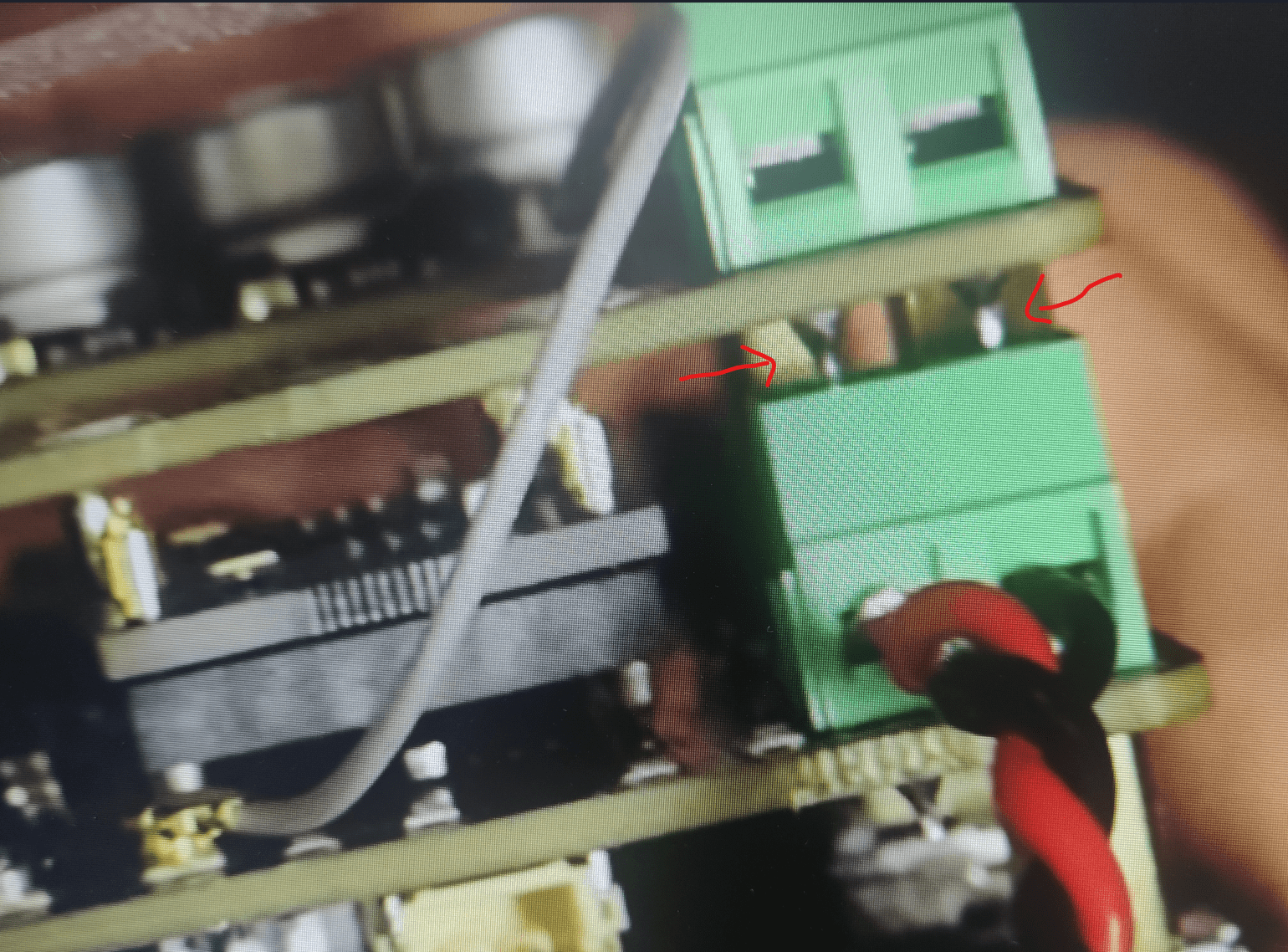

Need clarification.... while stacking the cards (between HDMii Pro/AES & FifoQ7) I see soldered material of HDMI/AES board J3 bottom side is touching Q7 card J3 connectors. attached pics....
I think they should not be touching and it's not safe? Shall we need to reduce the length of the excess solder to have gap? or is this by design and ok to continue?
Please advise.
