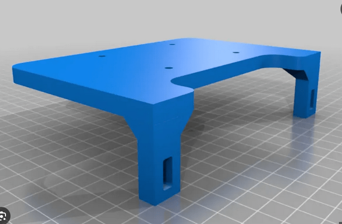

Hello Aiello, something like thiswhat exactly do you need; i have c02laser; cnc, 3d printer and much more,
This is of printables, I'd have to check the size .
It looks particularly sturdy if pprinted witht he right materials. Could possibly be slimmer.

Hello,
If you are going to have a 3D printed object than you mIght as well not have an L shape but a T shape so you attach it with 4 bolts instead of 2. If you have some skills the mounting holes could be round instead of oval which give a more solid construction.
If you make the big flat area A reasonable thickness you could make some threaded M4 holes on three sides which will allow you to add some new parts( screening material for instance) . Once there are several boards connected it will difficult to add holes especially if they need to be exactly positioned.

which parts do you want to install?Hello Aiello, something like this
Pete
Anything that takes my fancy, really. The plastic makes it easy to drill different holes. If there's a bit of thickness I could even tap them. Right now It would be a StationPi, two of Ian's linear power supplies, and a TransportPi digi. I haven't decided where to go next. Probably a more run of the mill power supply for the Pi itself.
I could even use it as a 'foot' for the Waveshare touchscreen.
I like the 'feet' being on one side because then at least one side will always be flat. It may allow for better positioning.

Hello,
Could be a nice opportunity to give this bracket some vibration dampening properties. You could make the flat part with some kind of cavity that can be filled with lead shot, sand through a threaded hole and then closed with a bolt m10. I used this technique for a tubular rack. Yes you need a rather big hole to fill it up.
You could give it two feet on one side and one foot on the centre on the other side. OR use two bigger feet with each two mountings holes.
Not every plastic is good for making a threaded hole. I have used pom material for my diy turntable but i had professional tools at my disposal.Typical stand off for boards is usually m3 which is not easy to make for an average amateur.
Can you print a threaded M3 hole?

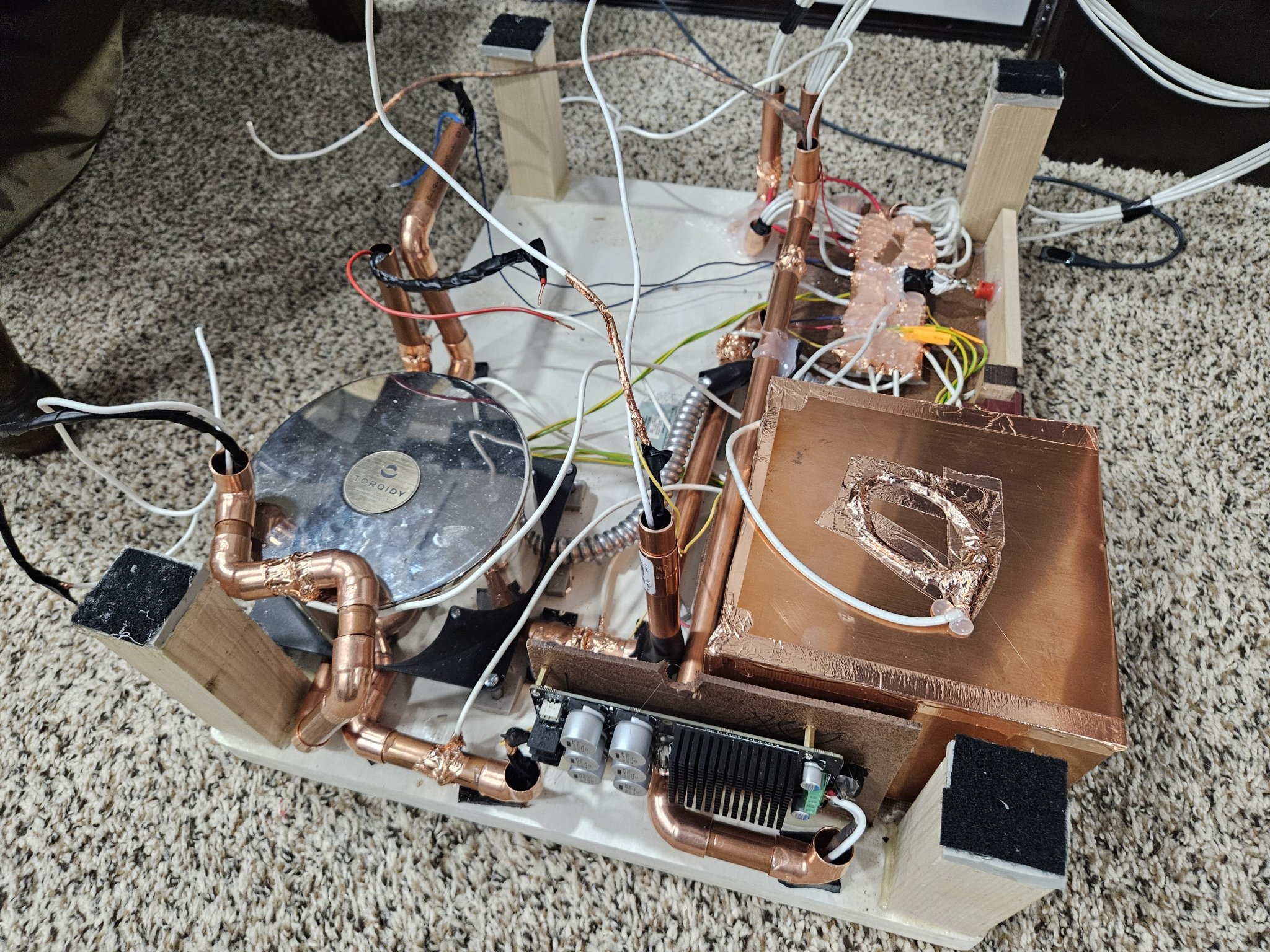

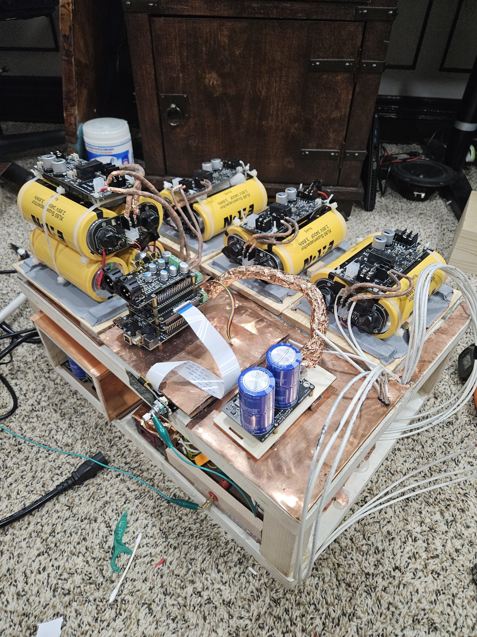

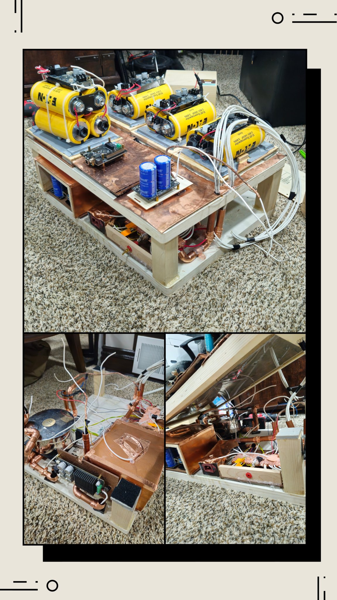

My Best Effort As The Do-Everything-A-Little-Right Ian Canada Build
This is so far, the whole build will be moved and live in a custom grainte case I am having made for me. This weighs 80lbs as is, without the added grainte

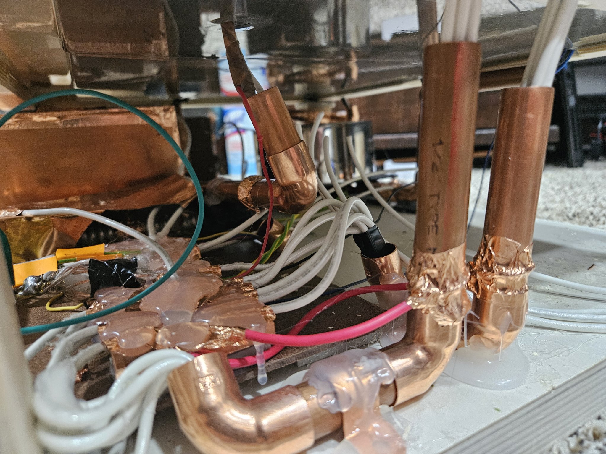

1.Everything is grounded. Like everything. Every Positive lead has copper foil added to it with a ground wire to ground bus bar, then added PVC tape or PTFE tape depending on importance of that lead (leads to UCpure do not need PTFE for example)
2. Star ground internal system, which is best, then to a dedicated home audio grounding system.
3. Every wire, every pin, every contact, every piece of everything that is connected, and I mean everything, was treated with deoxit red multiple times using a dremel, then deoxit gold if it was a gold contact or pin, then deoxit blue for shield. I got every single connector as shinny as jewerly. Every UCpure screw even. If it touches a wire or a contact in any way, shape, or form, it was treated.
4. Everything has its own dedicated copper plated enclosure (Pics show rpi in its own, the top all has their own as well, however not pictured here). Everyone is grounded with their own home run to the internal copper bus bar (that was also treated with deoxit) to create a true star ground. You dont want to share grounds until the end. It makes a difference.
5. Everything is on their own layer of sorbothane for vibration
6. Every copper tube is on sorbothate. The Toroidy transformer is on its own sorbothate. Sorbothane everywhere, everything can transmit vibrations, any wire in our out of anything. The IEC is on sorbothane for inlet AC power cord vibrations!
7. There is sorbothane between top and bottom rack, without any screw for physical connection (would transfer vibrations)
8. Every wire is run thru copper grounded tubing, wires that are not are ground wires
9. Extra white wires are for all the top grounding enclosures and wires (not pictured)
10. Inlet IEC is pure copper and treated with deoxit
11. Inlet cabling is 12 guage solid core pure copper, in aluminum conduit, grounded, further shielded with copper thats grounded
12. All wire for power supplies and supplies to Ian parts is pure copper, sold core, 14 gauge, in PTFE, wrapped with additional copper foil layer thats grounded, with final layer of skived PTFE tape (skived is the real deal PTFE)
13. 0.5" very heavy aluminum panels are used between top and bottom layer, they are epoxyed into the top layer. There is then individual bottom copper plates, which are all grounded, on the top.
14- SC-Pure clock pins treated with deoxit red, yellow, blue with dremel shinny as can be. Held secure with tack around the base of the clocks for snug fit and then added sorbothane layer ontop of the clocks. I even dexoit treated the little master clock cable, lol.
14. The entire 80lb frame as pictured sits on 3 5" in diameter 1" sorbothane doughnuts for final build to rack isolation.
(I need to still copper cover and ground the monitor pi pro...temporary location in pics)
I measured almost ZERO EMI or RF, no matter where you measure around the gear, top, bottom, near any wire, any item, the pi, the dac stack, ect. My EMF, even using the Toroidy power supply (dedicated electrical shields between each output that are grounded individually, added EMF shielding, in epoxy, and then stainless steel enclosure for EMF I can measure 300-400 on my EMF meter. Now, directly above it (measure highest EMF directly above a toroidal) with the aluminum and copper, I measure down to 10 or so. This drops off to 2-3 once you move very slightly from dead center above.
If I disconnect the ground from the copper bus bar (out with 16 cable OCC braided cable to Gr research Tube connector) to the audio dedicated ground system I can measure 300-400 for EMI and RF all over the board. Even when the Ucpure is in "pure" mode the AC lines without the above grounding steps are measured in the 200's. Connect the ground back...boom almost 0 everywhere.
I think I thought of everything you can. I run audiolinux on my rpi5 and thats a whole talk in itself as how much my audiolinux server and audiolinux pi are tweaked to perfection. My networking is all home clocked on GPSDO OCXO and I made every xlr and cable, with OCC copper braids, added foil, ptfe layers, and repeated multiple times, each layer with their own dedicated grounds. I use a Lush^3 USB cable which is killer for Pi to DDDC which I can lift grounds, one side ground, both, connect shields in parallel, series, ect
I dont think I can really think of what else I can do. It will look very nice and high end once its in my custom CNC granite case.
I thought about added shielding between layers of all the Ian parts, but I dont think it is needed here. I cant measure any EMI or RF around or between any of the boards. This is likely due to everything being grounded already and noise from the stack goes out via its grounding.
I spent a LOT of time laying out this build, thinking of everything, measuring, moving things, testing testing testing. I can tell you all of this work IS WORTH IT and the sound compared to my video showing the test build is VERY REAL and this thing sounds WOWOWOWOW....without any wire burn in either.
PS - Don't mind the mess and random HDMI cable that normally is not there, I just was excited to get it playing again after 3 weeks of many many many hours spent getting from test bench build to this.

@badd99
Thanks for sharing. Your build is badd ***!
I took a similar route in 2013 when I laid out my streamer DAC but it pales in comparison to your efforts. I wanted to keep all the noisy stuff at one side, in its own copper clad case, dampened and away from sensitive stuff. It was an epiphany when I realized this could be 3d.
I appreciate your use of grounded copper pipe. Also the big copper bus bar. I found star grounds and a massive copper ground buss to work well.
I love the use of granite for the outer chassis. I used solid walnut. If I did this again, I'd replace all the walnut with granite in my streamer, monoblocs and open baffle speakers. That will never happen but I can appreciate what you have done. Hope it sounds as good as I imagine it will.

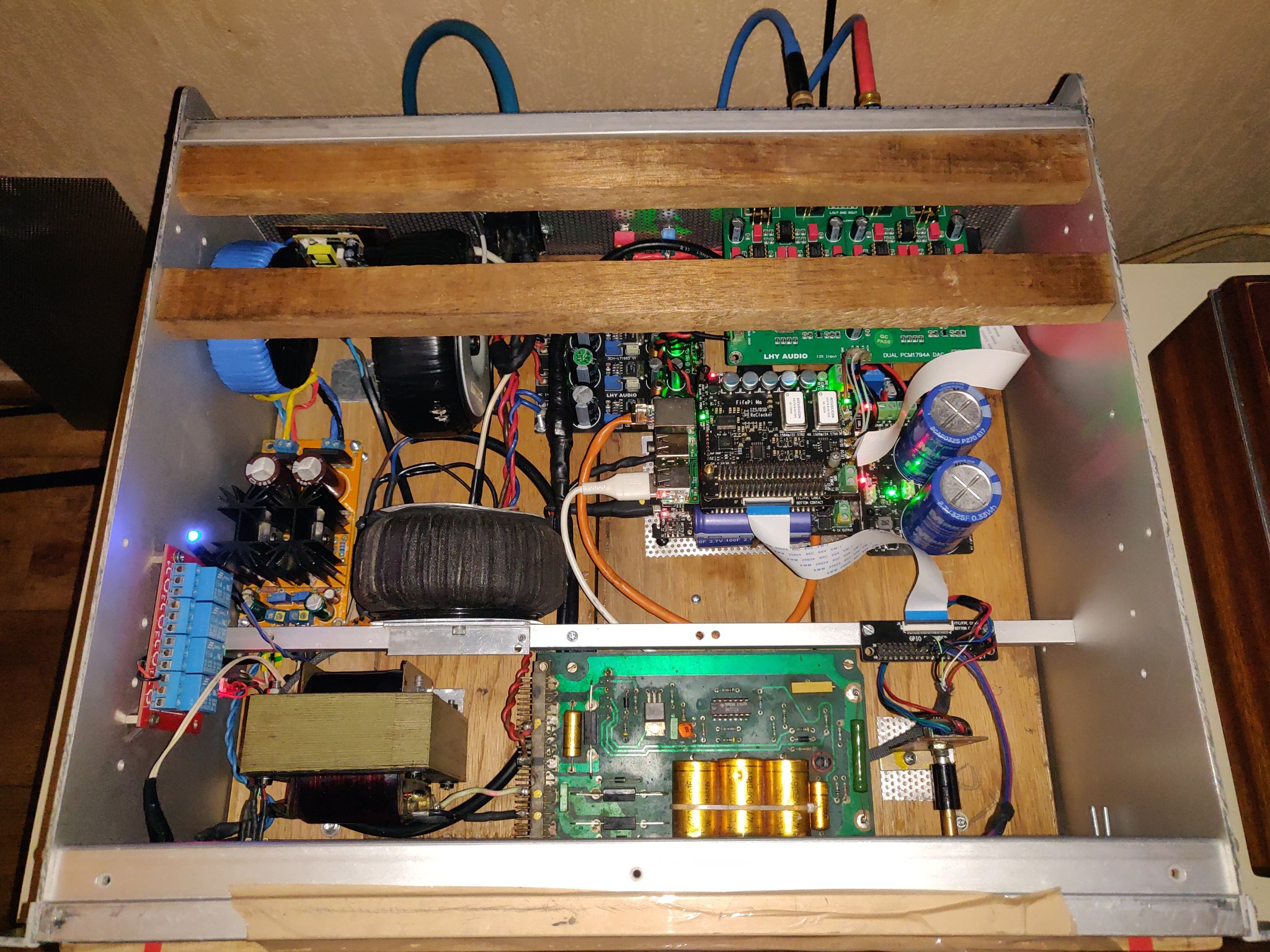

Just purchased the parts for this and also have the Gustard r26 DAC. Are there any issues connecting the streamer to the DAC? What IS2 cable works between the HDMI Pi Pro and the Gustard R26? I am using Roon with Ropiee software on the Raspberry Pi. Does anyone know the right settings in Ropiee to make the connection?Hello all - hope everyone is well.
I have, following much input from Ian Canada and inspiration from Gabster managed to put together the following stack:
This combination has comprehensively outperformed both the PIAES2 streamer / DDC and the internal streamer in the Gustard R26 DAC. I am very pleased with the improvement in sound quality that Ian's components have enabled in my system with the R26 as the DAC.
- PurePi II
- RPi 4
- FiFoPi Q7
- HDMI Pi Pro
- UcConditioner 3.3v
Attention now inevitably turns to the next incremental improvement and I have a few questions for @iancanada, if I may please:
Many thanks in advance
The copper piping serves as a brilliant and simple yet efficient Faraday shield. Your work on it is very impressive. Please keep us updated on how it affects the sound. Given your highly resolving system, I'm eager to hear your thoughts and impressions.
I have a question about the green connectors. All the screws are iron-ish or magnetic in some way. I was thinking about changing them to copper screws too. Have you already made this change? I began the process of replacing the entire connectors with PTFE ones, but it's quite tedious with all the desoldering, cleaning, and resoldering involved. Just changing the contact screws should suffice. lots of people such as Dany Ritchie or the guys at Purifi seems to avoid iron like the plague in all their builds. I respect their expertise, so I'll follow suit rather than experimenting unnecessarily.
I'm also making some changes to the Vishay Dale resistors on the OPA861 by replacing them with AN tantalum ones. It only requires four, so it's a relatively easy modification that could yield interesting results.
Lastly, If you don't mind, I might also borrow your copper pipe idea.

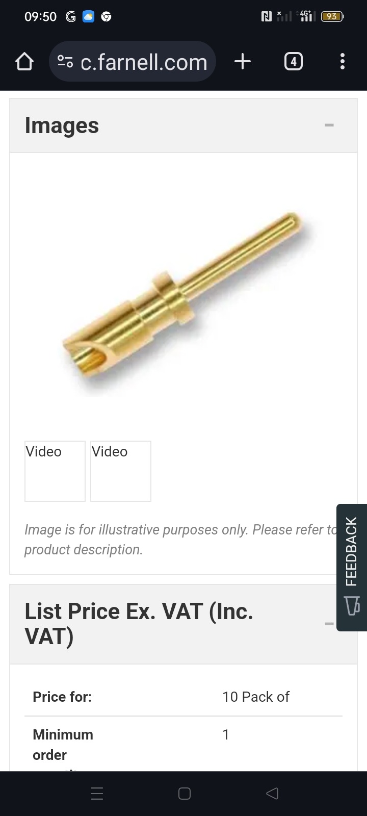

Why not skip the connector completely and use these from Bulgin. They are goldplated copper are solder the wire directly onto the board if you want disassemble it every year.
Greetings Eduard
