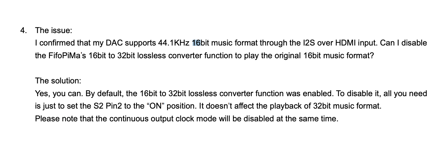

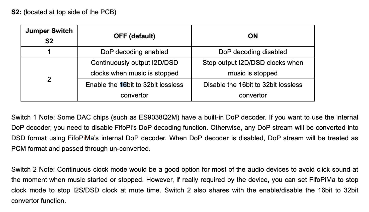

@iancanada can You please advice if there is any issue/ incompatibility (or could be) between combo: FifoPi Ma 1.5 +newest Transport Pi AES with DACs based on TDA1541? So far tested 2 of them, without positive results.In the FifoPi Ma manual i saw this. Maybe, 16 to 32 bit is enabled and needs disabling?
Thanks in advance
