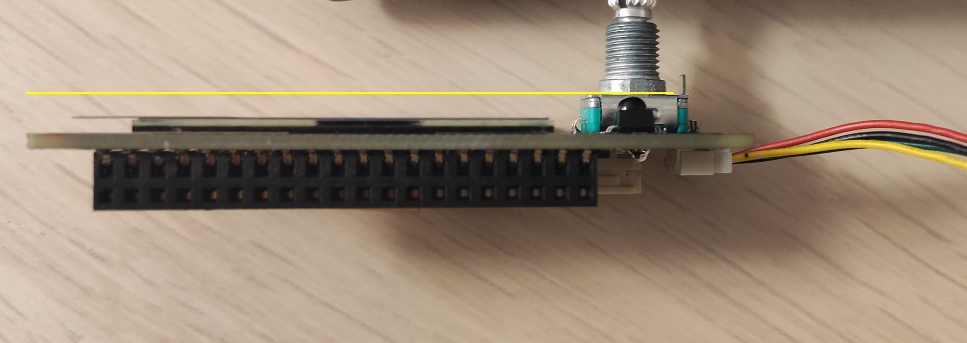

Yes, though it would be nicer to have a round hole for the rotary, since it already has it's own fastener.
I don't own the MonitorPi yet myself, but is the top of the display the same height as the rotary, not the shaft, the part where the fastener is max turned down too.
Having a separate opening for the display would be nicer.

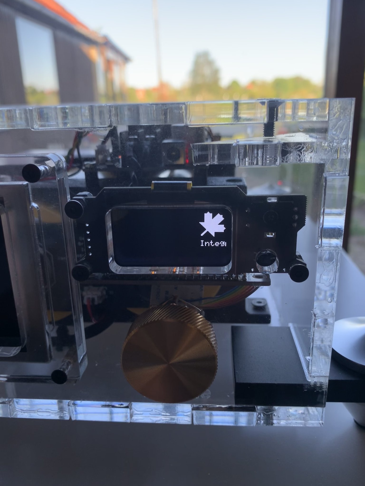

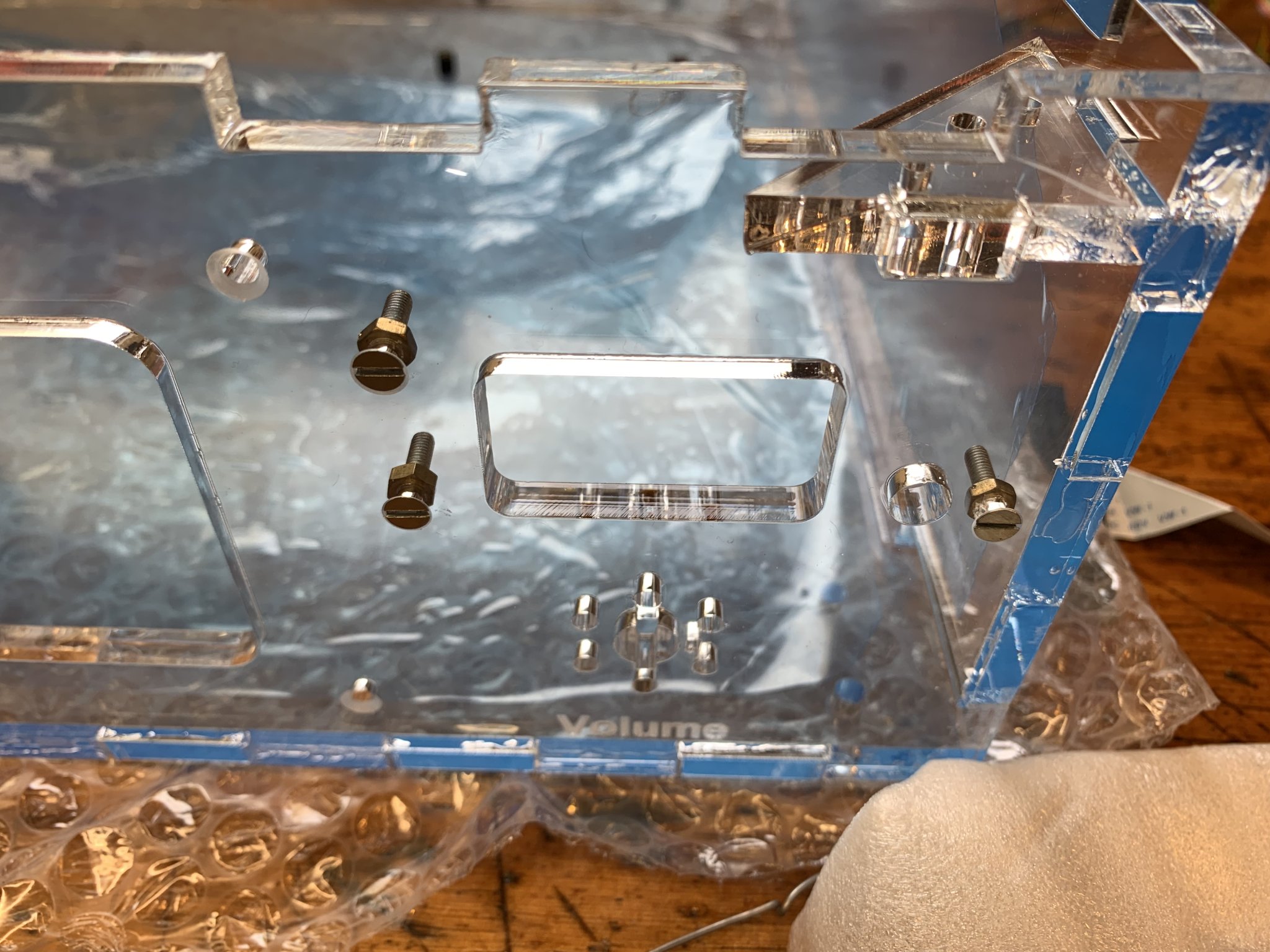

I would go for this “measurement”. I used that when cutting a hole for my MonitorPi pro.
I did it in 6mm acrylic with a laser cutter and was therefore able to cut the shape of the encoder as a hole.
It will also be possible with a CNC in metal. You just have a radius on the slot made for the two taps at the encoder.
Are you to cut the hole by hand by your self or to have it professionally made on a CNC or similar?

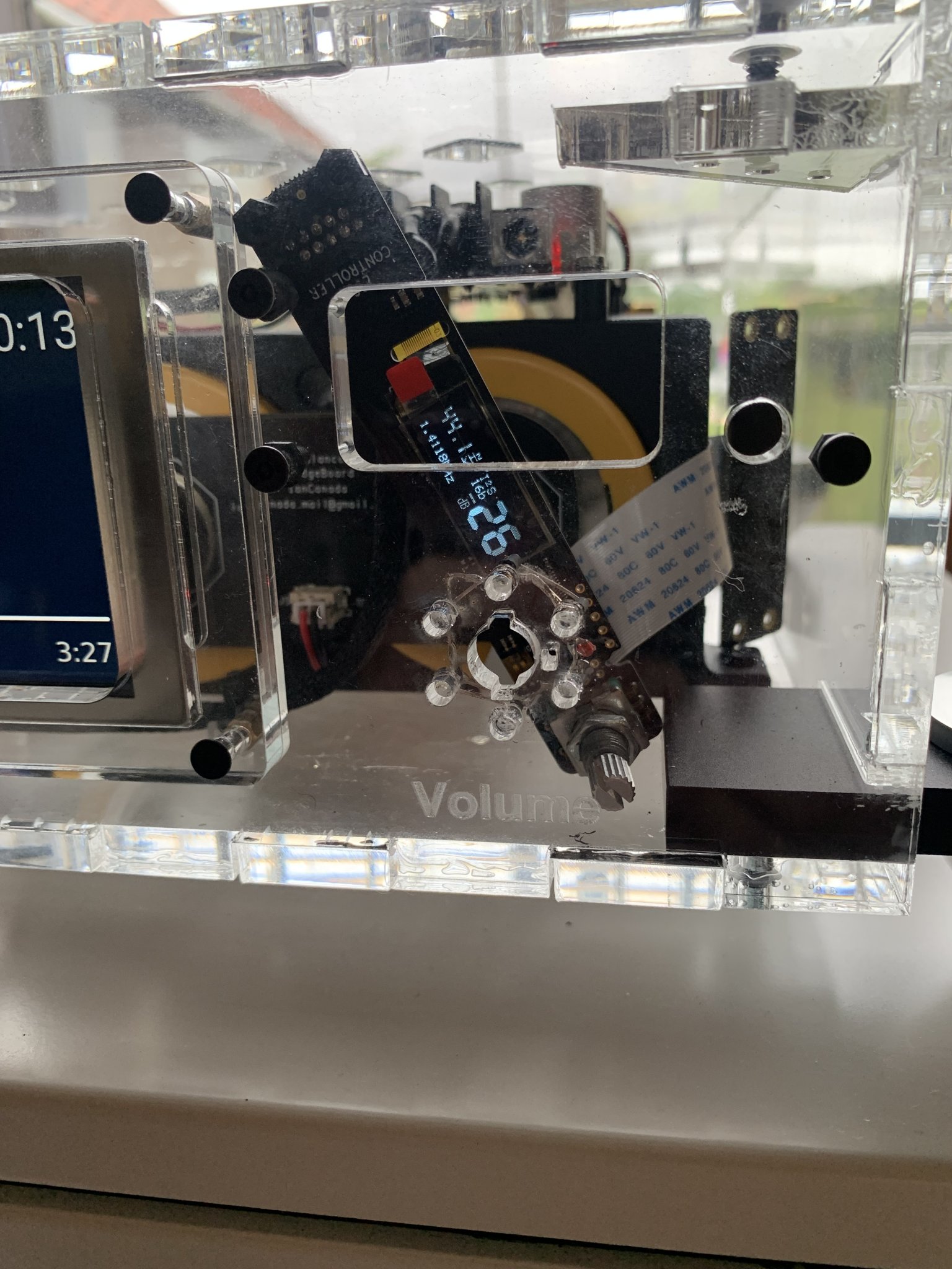

I also removed the encoder to a second location. The location of the encoder on the monitor pi pro limit the size and type of volume button and to me doesn’t look very good.
Here's how the hole looks like (I am waiting for a replacement monitorpi pro. The ESS controller is temporarily):
