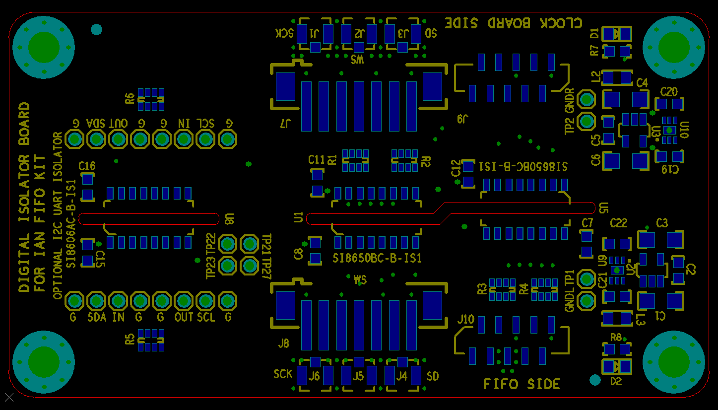

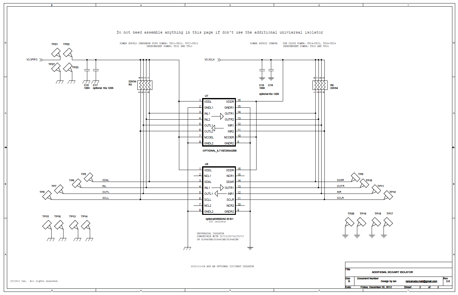

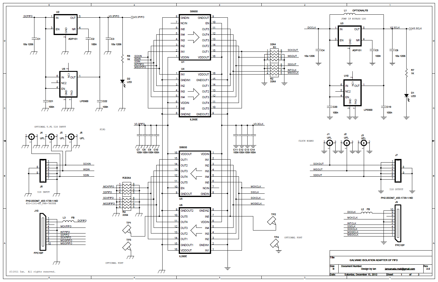

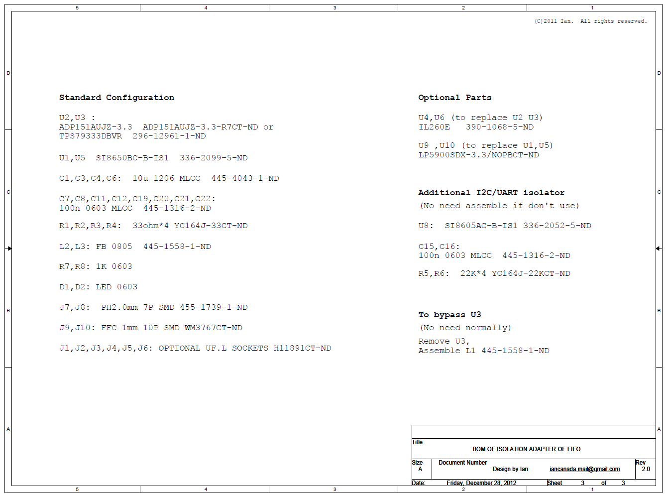

FIFO isolator board V2.0
1. Making it easier to assemble the resistor arrays.
2. 16-SOICN package ICs on top for better layout.
3. Including optional LP5900 LDOs.
4. Making SI8606 as optional I2C/UART isolator.
5. Including two power LEDs to indicate power good on both side.
Function and interface compatible with V1.0

nice work Ian! so U9 and U10 are TPS7A style DFN package regs? I just ordered some of these including the negative counterparts TPS7A3001 for my portable dac, I will be using them with a simple mosfet follower for higher current to power the buffers for added transient response.
