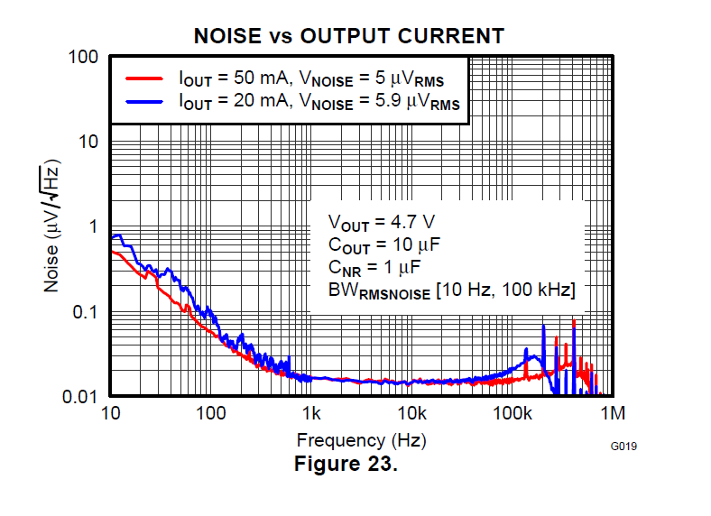

Hi Adrculda,
Here is the noise density plot of TPS7A4700. But the noise performance is still not as good as a decent battery pack. The whole goal of the FIFO is to reduce the clock jitter. It gains neither from the high efficiency nor from the compact size of a power supply. With the isolator board, the power consumption is just around 100mA for the clock board and half of isolator, the only thing helps is the low noise performance of a power supply.
Theoretically a switching power supply is not good at low noise application comparing with linear. The high frequency high power switching noise is very hard to be decoupled, even using multi-stages CLC filter, because there is no ideal capacitor and inductor in the real world. The EMI noise introducing from ground into DAC may even more difficult to deal with.
But I might be wrong. Please let me know if your can really find a switching power supply with competitive noise performance.
