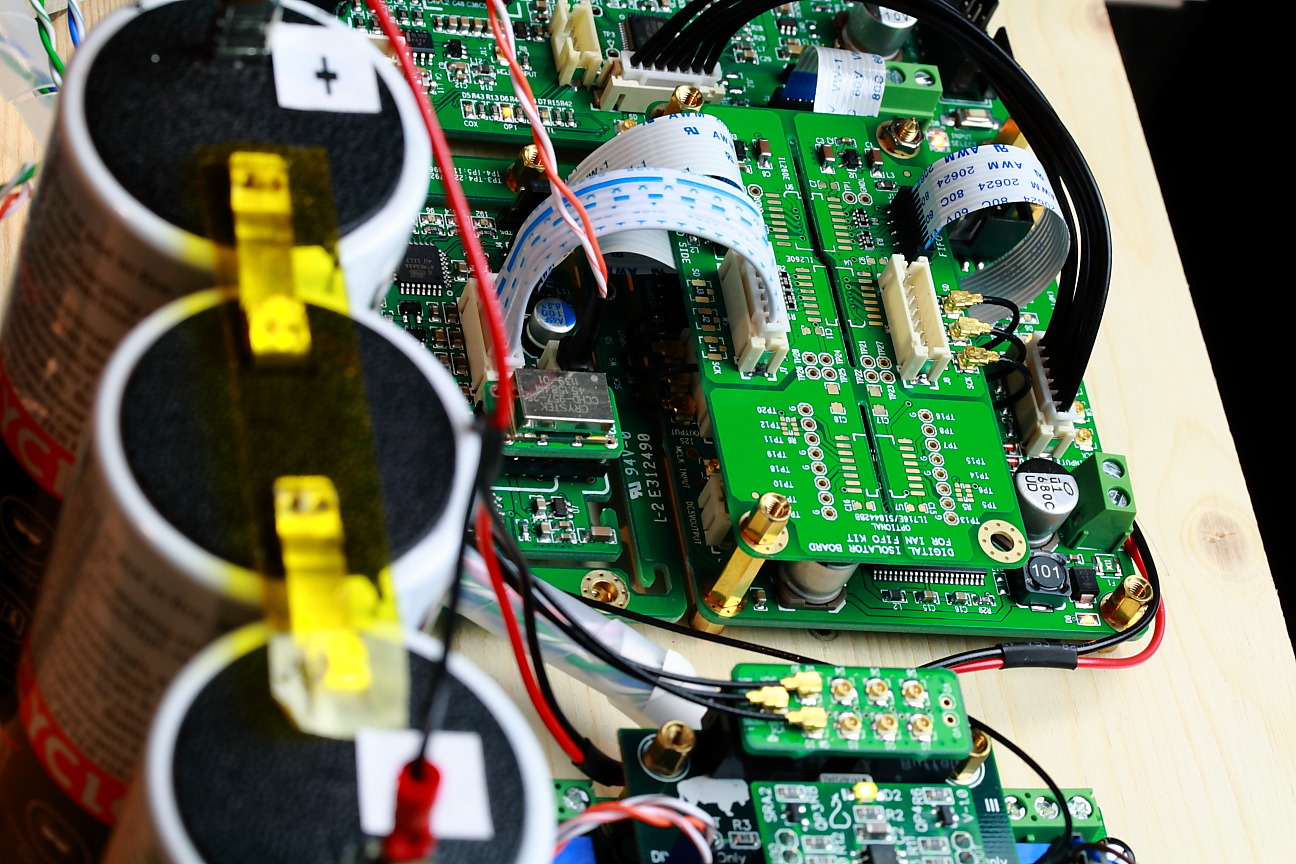

Greetings,
I finaly tried out the isloator board but I cannot seem to have a lock on the input.
I verified shorts on the resistor array and they checked out good with no shorts.
I don't know where to go from here.
any help appreciated.
thanks
Please confirm everything is OK without the isolator board. If so, you can lock the problem on the isolator board.
Please check not only the short, but also disconnect. The resistor is 33ohm. Please reference the schematics I posted. Also confirm the part number of isolator is correct.
Good luck.
Ian
MY BAD.
I think with the isolator in circuit, the clock has to be powered externally.
I could not find instructions on accomplishing this except something about removing L11
Are there any pads and what voltage is expected?
Yes, with the isolator board, you have to power the clock board externally. If you use the dual xo clock board, the power is 5V DC.
Ian

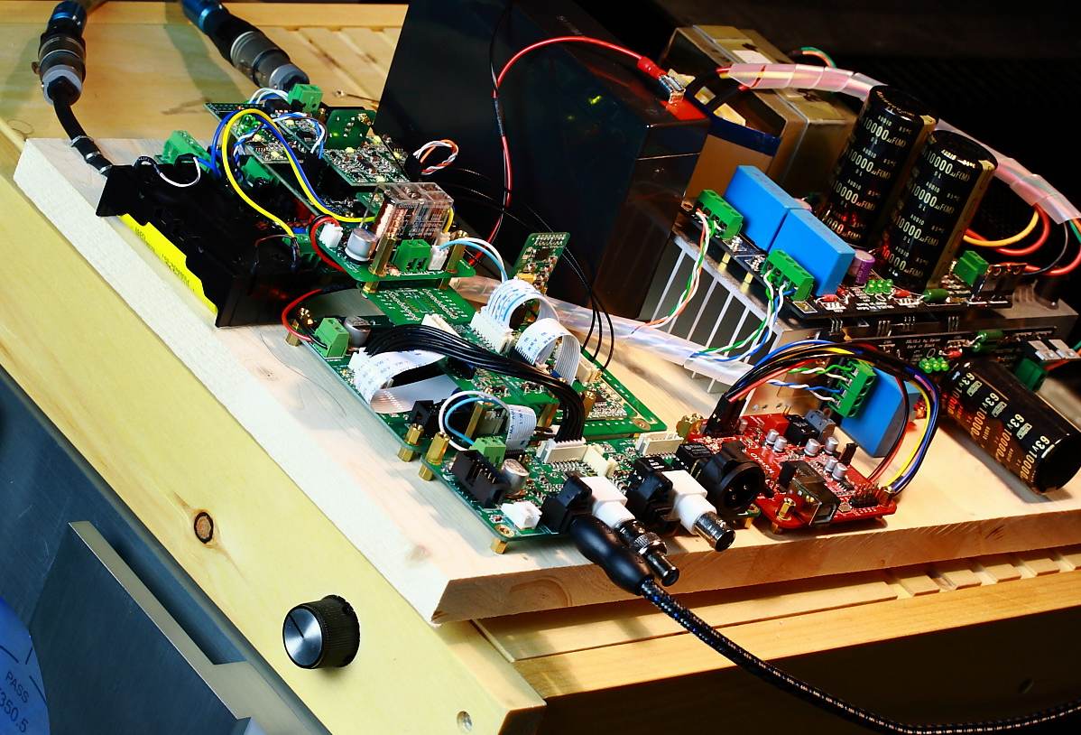

It would be nice if you can post a detilaed picture of your setup.
regards.
Please see the DC power cable,

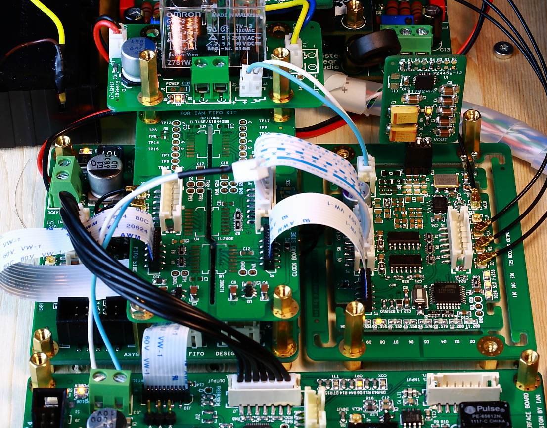

Hi Ian
I tested the isolator with power on clock board at 5v.
the input voltage on fifo side is 3.3v which is good.
the voltage on the clock side is 1.7v which is not good.
so I unsoldered all the regulator circuit on the clcok side and the voltage now reads 2.3v on the L pad of the regulator circuit.
everything else is still soldered in place. just the clock regulator circuit is removed. the L pad should read 5v.
any ideas?
regards.

Hi Ian
any ideas?
regards.
Could you show me a close picture of your configuration and your clock and isolator board?
Ian
