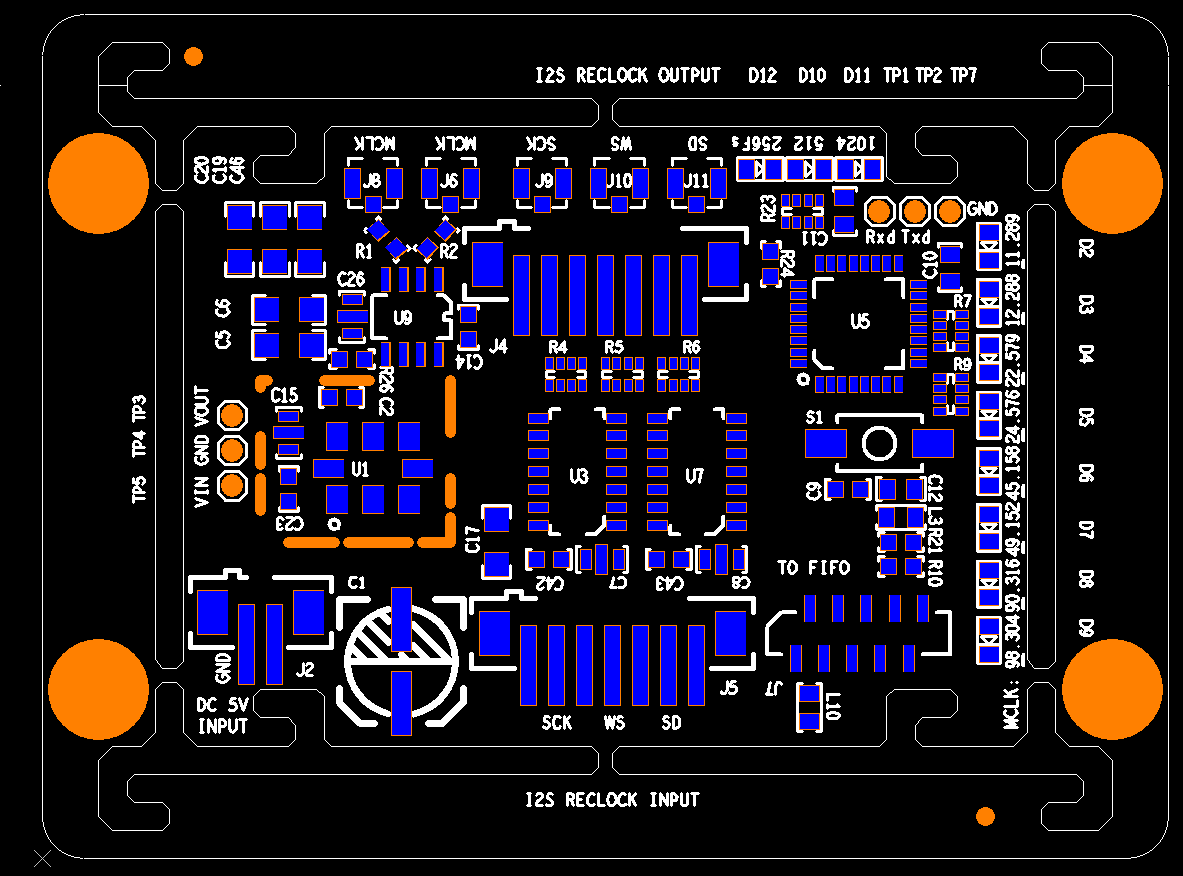

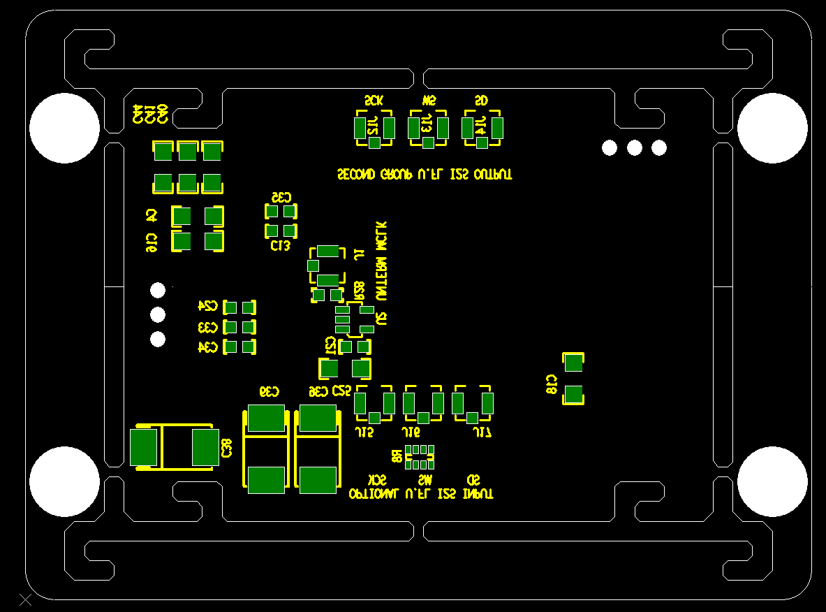

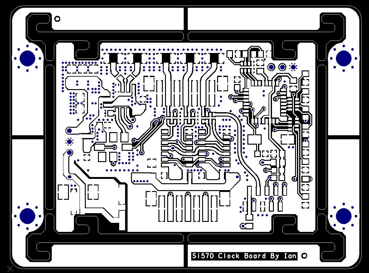

Si570 clock board PCB V3.0
Here is the Si570 clock board V3.0 PCB design. There were 2 previous versions, V1.0 and V2.0. None of them could become the finial.
Onboard LDO removed completely to make good use of external low noise high performance power supply, or battery directly. With on board LDO limitation removed, power supply selection becomes more flexible, different PSU solutions could be put into evaluation and then to decide according to actual sound quality and personal preference. More PCB space left that can be used for enhanced bypass capacitors, EMI filters and possible XO shield can. Layout design with better RF performance gains from the PCB space as well to meet the MCLK closing to 100MHz(based on less than 1ns actual clock raising/falling time, the frequency range could be extended at least more than 5 times which is 500MHz).
Inverted MCLK was implemented as the default clock phase according to ESS APN recommendation and actual listing test. But it could be disabled for further more evaluations.
An UART port was included on PCB for potential thirty party external controllers. Protocol has already been supported by the ATMeaga8 Si570 driver. UART isolator is highly recommended for connecting with the external controller if your clock board has already been isolated from the FIFO.
Most of the features we have discussed before are also included in this V3.0 design. I’ll order the PCB prototypes once again. Just hope it could be the last version before the Si570 GB.

Your productivity never ceases to amaze me Ian!
Thanks MisterRogers, I know you have been waiting for this littlt clock board for too long. I'm just concerned about the design is not perfect, that's why it's been revised for three times...

what amazes me is how consistently clean you manage to get with high speed designs on 2 layer PCBs....
great skill indeed
thanks...
Both double layer and multi-layer PCB could be excellent design if we take impedance control into account. However if there is no enough space to place wider clock traces on PCB, then we have to use multi-layer, like some ESS9018 DAC.
Ian
