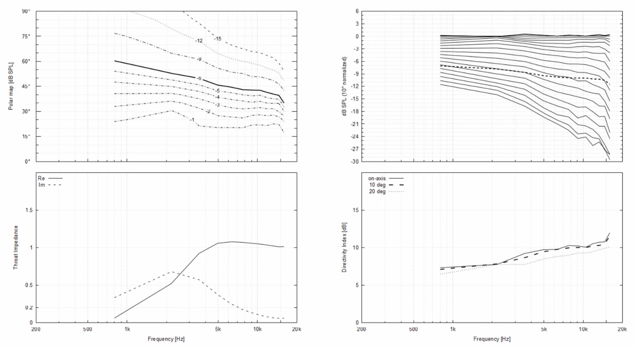

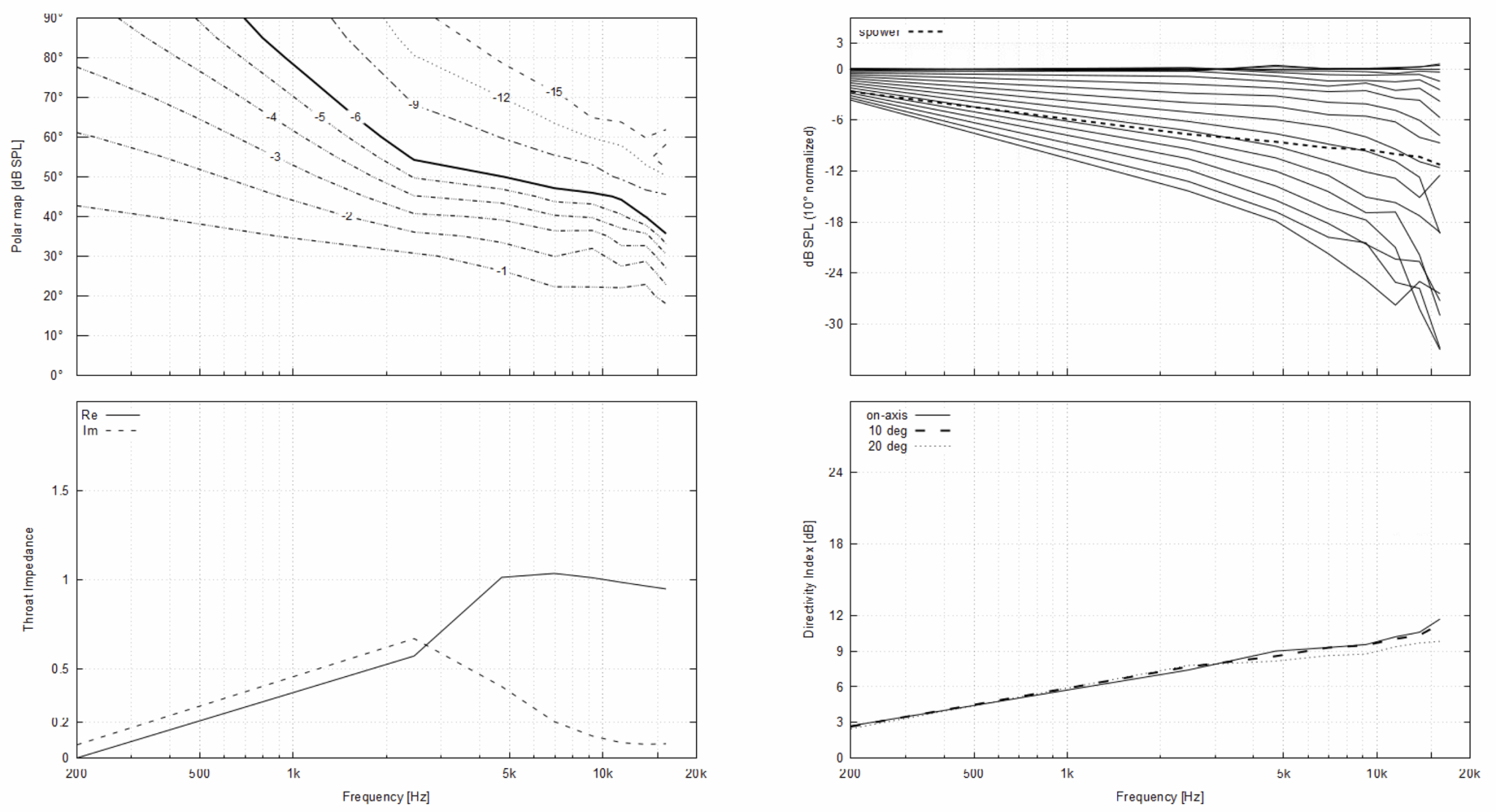

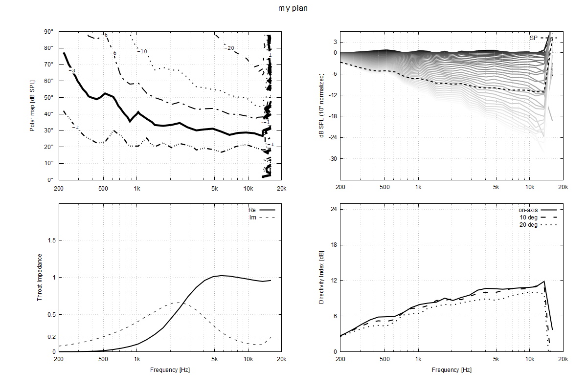

9 months later it is about time these speakers had a cabinet. Here's the plan and the reports for 10deg normalised horizontal.
Code:
; Enclosure Setting
my_plan = {
point P0 166 0 12
point P1 184 18 8
point P2 184 30 24
point P3 63.79 293 24
point P4 45 300 24
point PB 0 300 24
cpoint C1 166 18
cpoint C2 -163.8 30
cpoint C3 45 271.3
arc P0 C1 P1
line P1 P2
arc P2 C2 P3
arc P3 C3 P4
line P4 PB
Mesh.Enclosure = {
Plan = my_plan
Spacing = 0,20,0,344
FrontResolution = 24,24,24,24
BackResolution = 24,24,24,24
; Measurement Settings
Mesh.VerticalOffset = 0
; Mesh Setting
Mesh.AngularSegments = 56
Mesh.LengthSegments = 20
Mesh.ThroatResolution = 2.5 ; [mm]
Mesh.InterfaceResolution = 7.0 ; [mm]
Mesh.InterfaceOffset = 5.0 ; [mm]
Mesh.ZMapPoints = 0.3,0.5,0.5,0.95
Mesh.SubdomainSlices =
Mesh.Quadrants = 14
; ABEC Project Setting
ABEC.SimType = 2
ABEC.Abscissa = 1 ; 1=log | 2=linear
ABEC.f1 = 20 ; [Hz]
ABEC.f2 = 16000 ; [Hz]
ABEC.MeshFrequency = 1000
ABEC.NumFrequencies = 40
ABEC.Polars:SPLTH = {
SID = 0
MapAngleRange = 0,180,72
Distance = 3
NormAngle = 10
Inclination = 0
ABEC.Polars:SPLTV = {
SID = 0
Distance = 3
NormAngle = 10
Inclination = 270
; Output
Output.DestDir = "C:\ath4" ; current directory by default
Output.STL = 0
Output.ABECProject = 1
Report = {
Title = "my plan"
Width = 1200
Height = 800
NormAngle = 10
PolarData = SPLTH

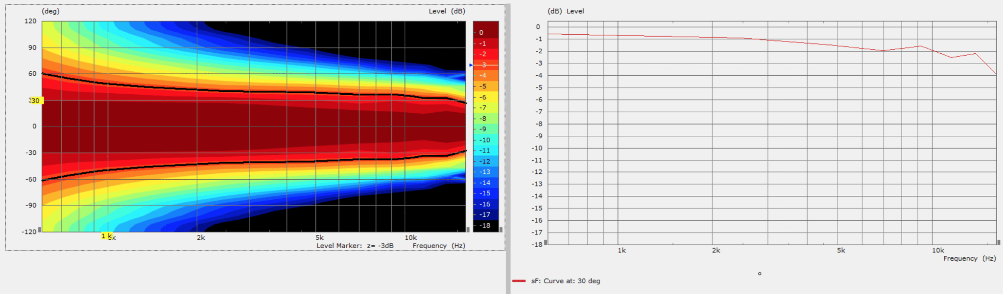

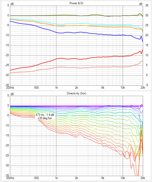

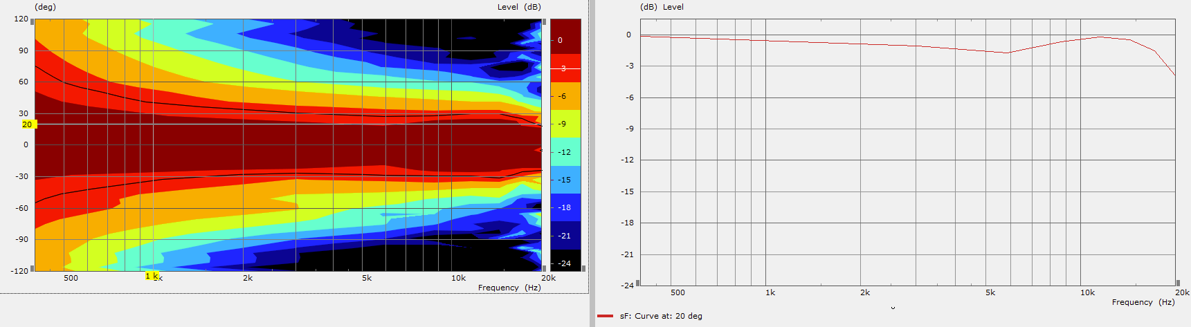

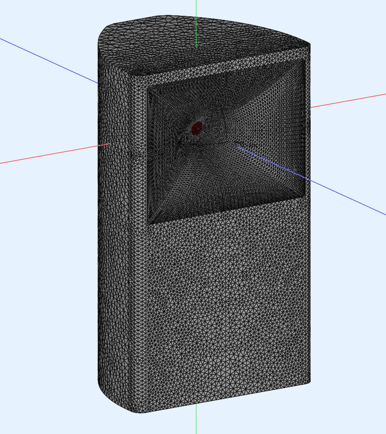

v3 of the ath4, baffle & cabinet design.
I'll render a square box too for comparison....
![1678831124435.png 1678831124435.png](https://www.diyaudio.com/community/data/attachments/1061/1061641-370c15d35b9881a763ecba6719c69c42.jpg)
- made a few tweaks to the ath4 shape to smooth out the DI chart as best I can.
- pinch at ~2k that I'm trying to understand.
- with further iterations hope to flatten the DI by ~ 10 degrees / flatten the -3db point.
![1678831148607.png 1678831148607.png](https://www.diyaudio.com/community/data/attachments/1061/1061642-dbb87d21d5455632ab0023c8ea6078d4.jpg)

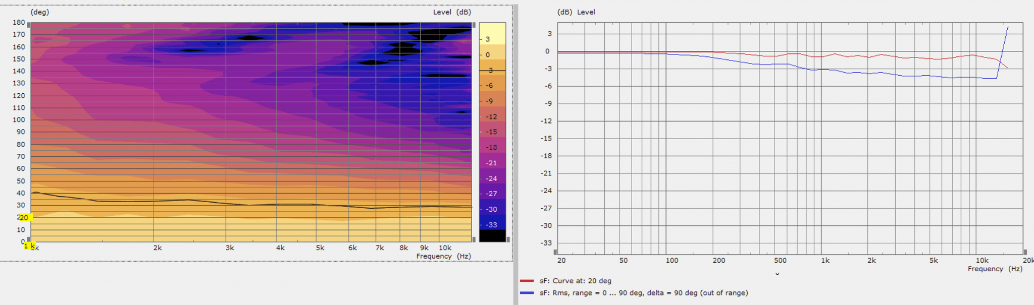

![1678832802045.png 1678832802045.png](https://www.diyaudio.com/community/data/attachments/1061/1061649-8b09647d3c18245f14db3d42759a2cad.jpg)
