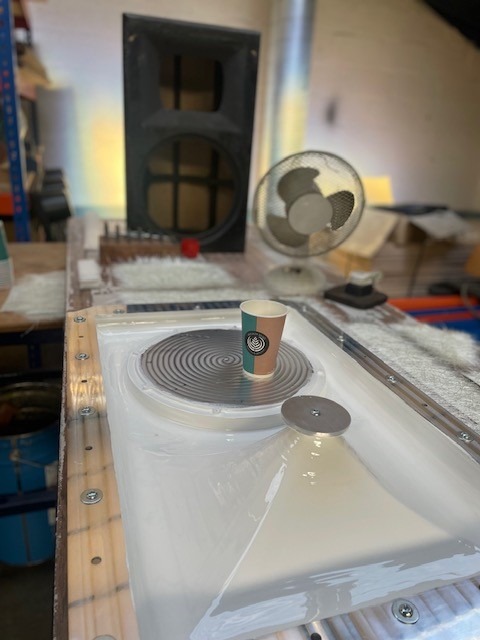

How do you manufacture the ring - looks really nice.

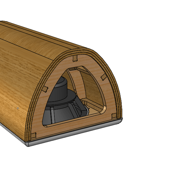

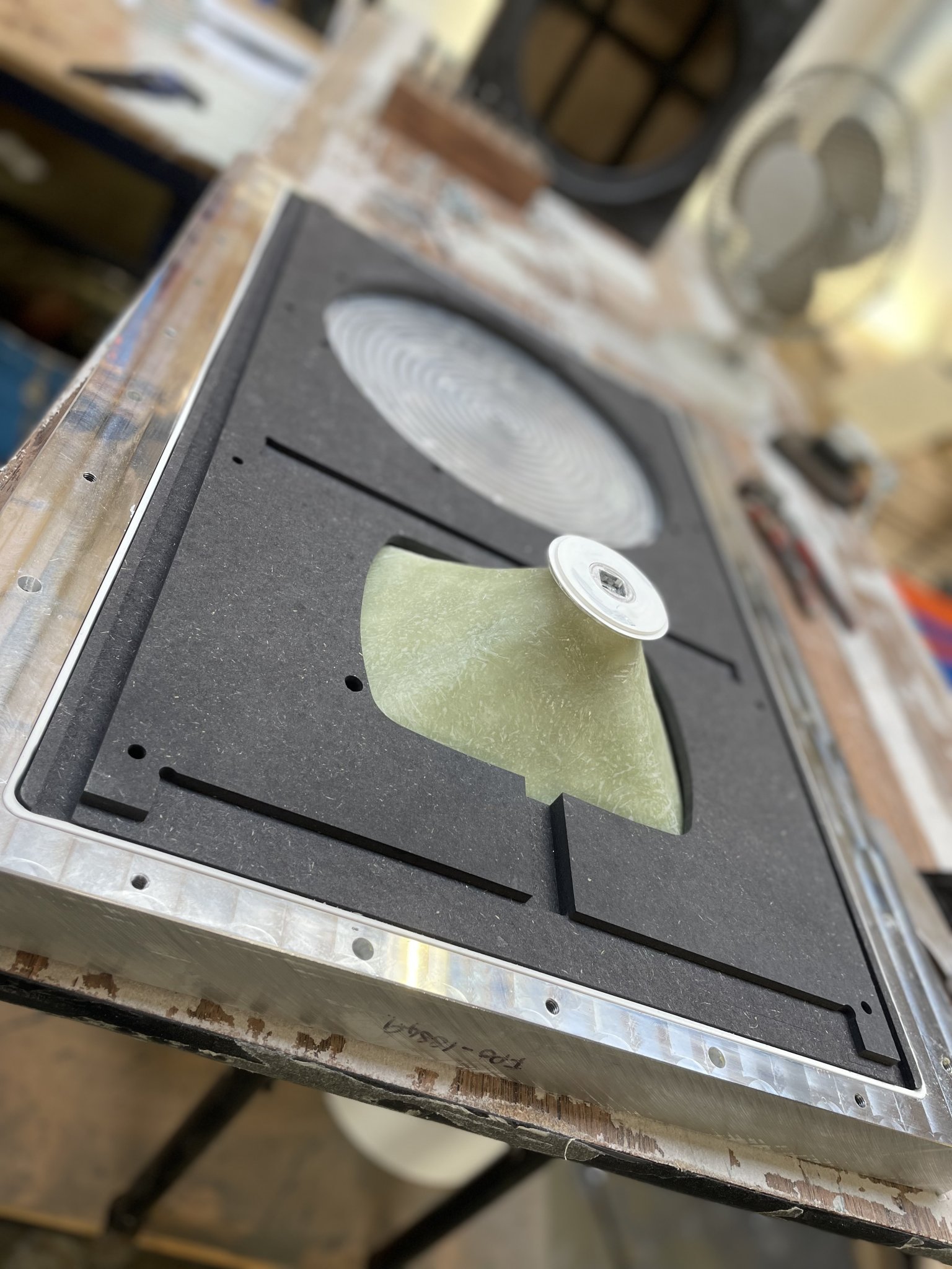

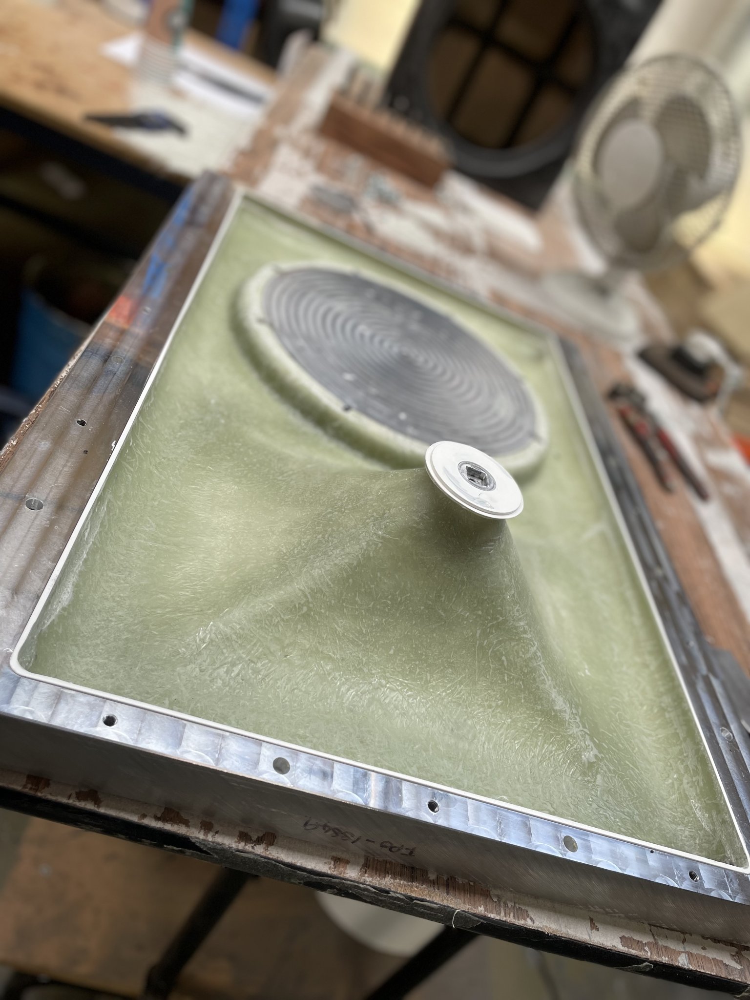

Gelcoat, glass matt, 1L resin. The 4mm thick baffle worked out at £70 plus an hour. I then bond in a machined 15mm ply in the back. It’s really quite a stiff inert baffle at that point.

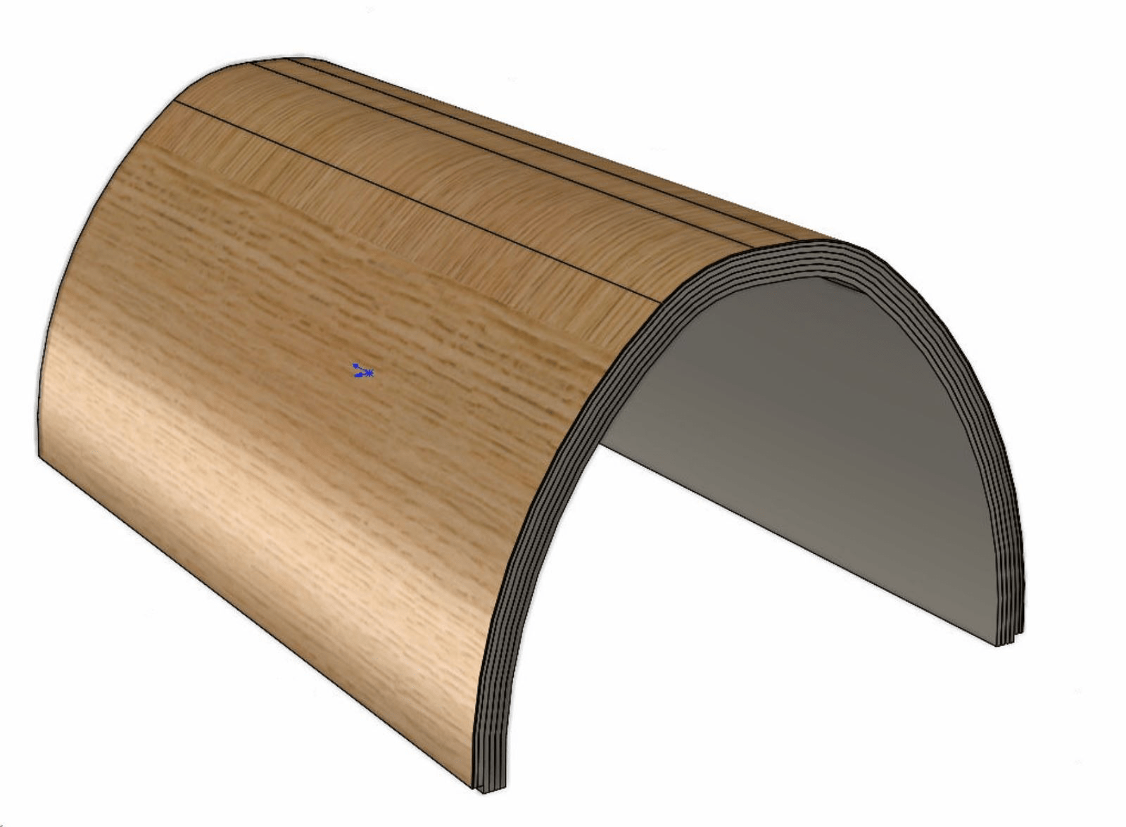

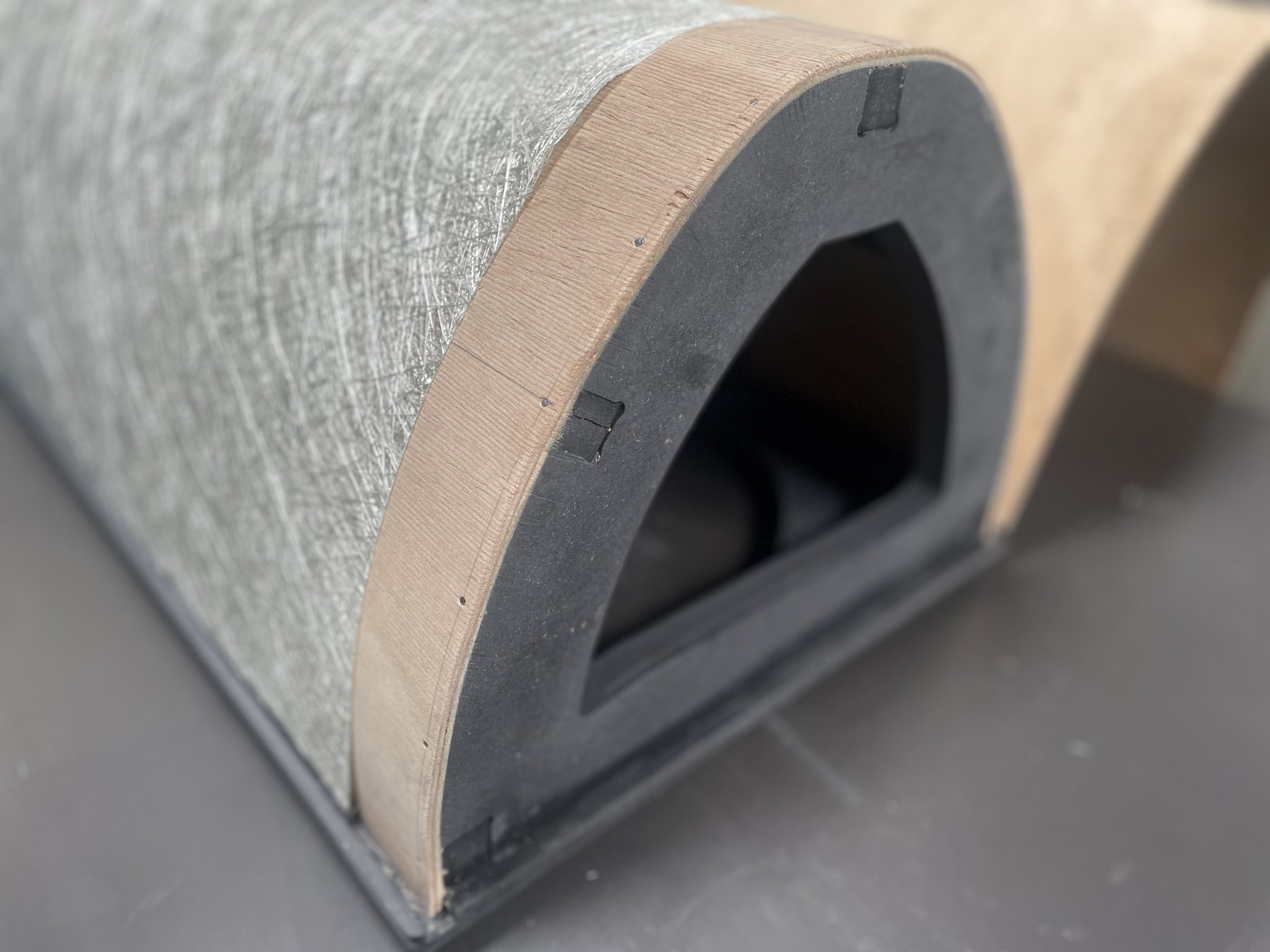

In between the bendy ply i intend to add a glass matt. It will be a stiff curved cabinet.

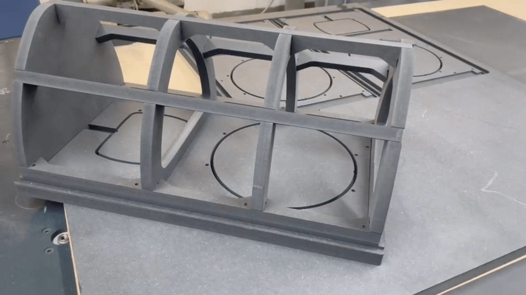

Designing the way I have allows me to rest the cabinet on it side, throw in some chop strand glass and pour in a casting resin. Quite a few low shrinkage fast cast resins around now.

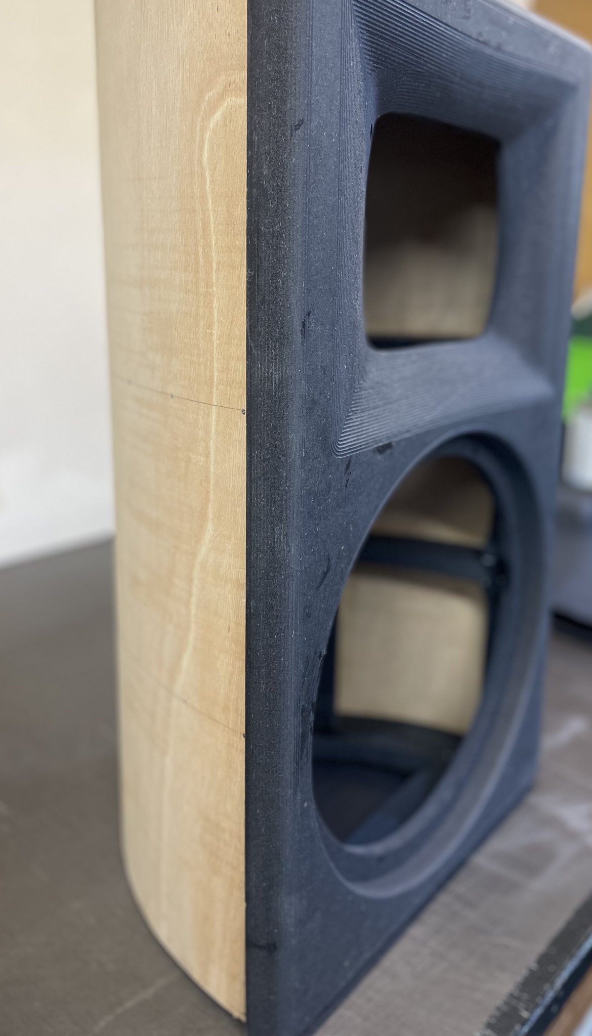

The cabs are coming along.
4 layers of 5mm ply + 400g matt in between each layer. I’m going to use stainless steel powder in the intermediate layers to add some mass. Also, the polyester resin should infuse into the bendy ply to create an interesting plastic/wood composite in those layers.
All finished with 1mm wood veneer.

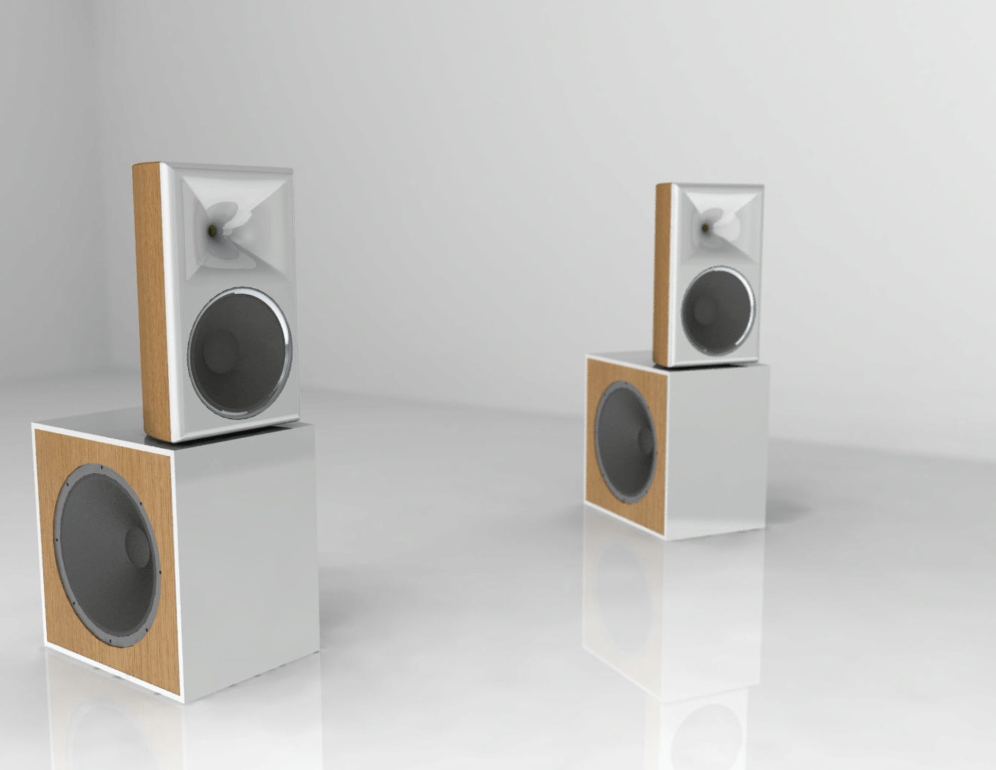

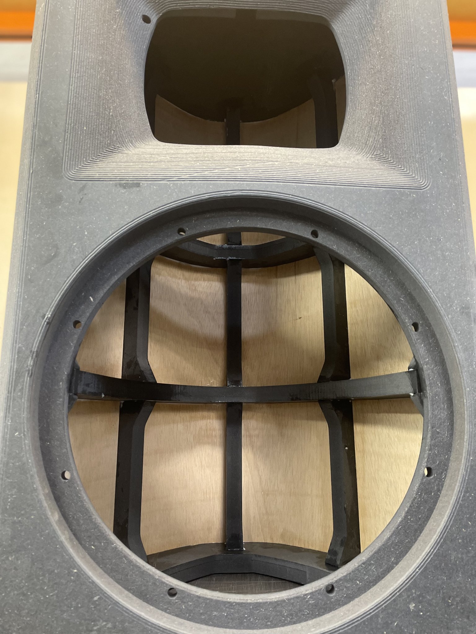

The new design front GRP baffles are almost done. Will update next week with those.
![IMG_8378.jpeg IMG_8378.jpeg](https://www.diyaudio.com/community/data/attachments/1092/1092236-2262e9a7d4552ccd47532930ad5cd995.jpg)
![IMG_8379.jpeg IMG_8379.jpeg](https://www.diyaudio.com/community/data/attachments/1092/1092237-ff19f3207641045e45b29d707410e3b5.jpg)
![IMG_8388.jpeg IMG_8388.jpeg](https://www.diyaudio.com/community/data/attachments/1092/1092238-588bfa7d0bc21a93c75a40b90ed45155.jpg)

I’ve been using resin boards from Sikka and Trelleborg for 25 years in my day job. I have no hesitation to try anything. Part of me enjoys working with wood too though. Sadly I’m super busy so finishing hobby projects is super long process.
