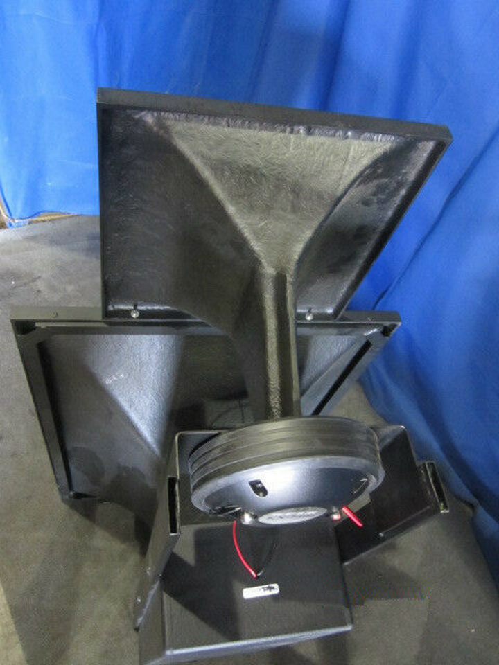

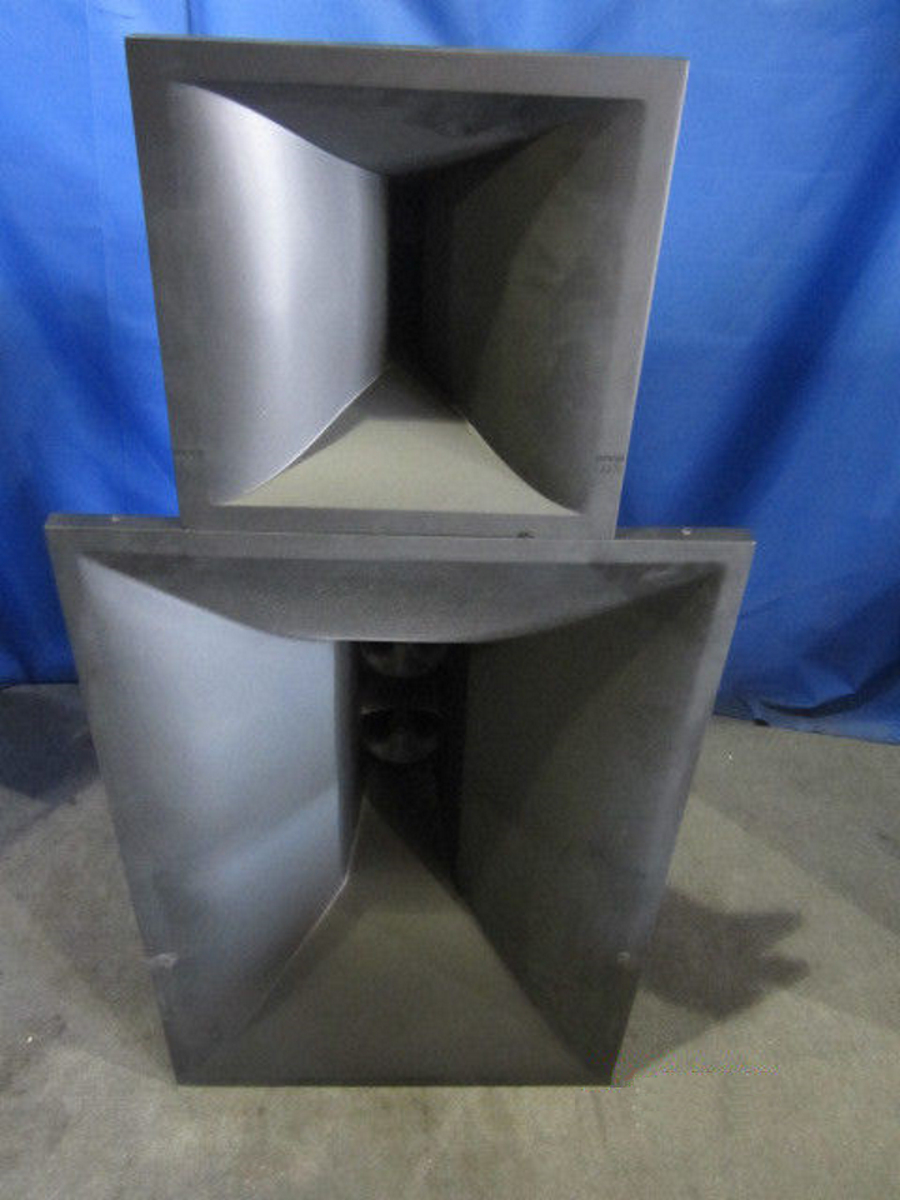

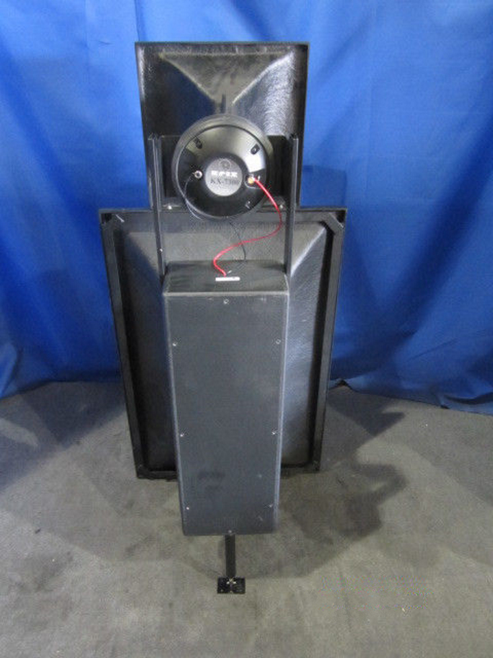

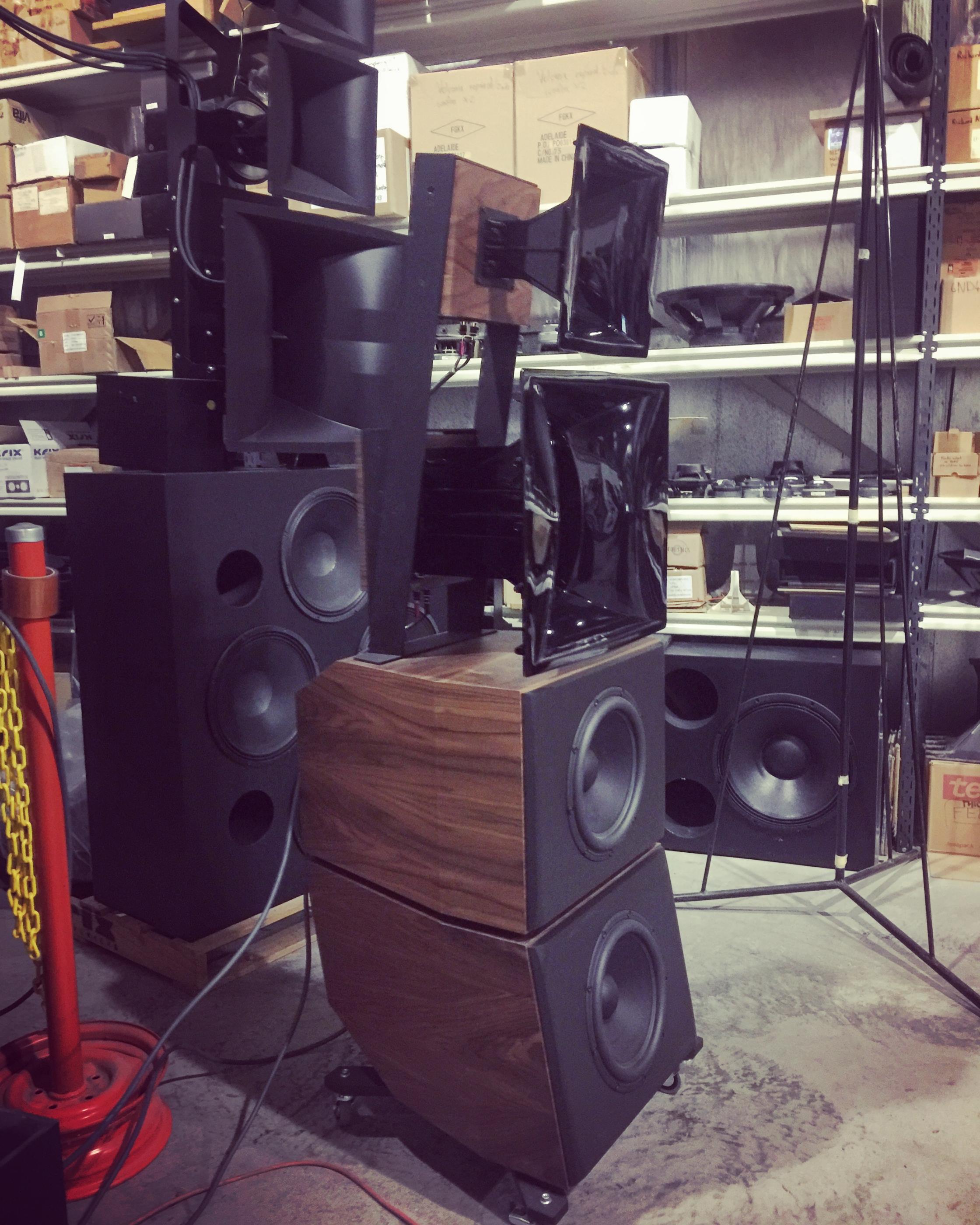

@Peter Morris: As you'll know, throughout the years Krix has developed numerous horns based on the research of Richard C. Morgans et al.
Krix also issued a number of patents on their advanced diffraction technology.
Except for the smaller 1" horns, most of the larger diffraction horns feature unconventional throat sizes.
I guess your Krix horns (for the mid/high cab) are medium-sized, and would normally be used by Krix with either a 4 or 3" diaphragm driver?
It would be interesting to see some measurement data of the mid/high with the Krix horn.
A few examples of similar horns. The top horns of the Krix 4 way systems are 1" and the throat size of the mid/high horns may vary.

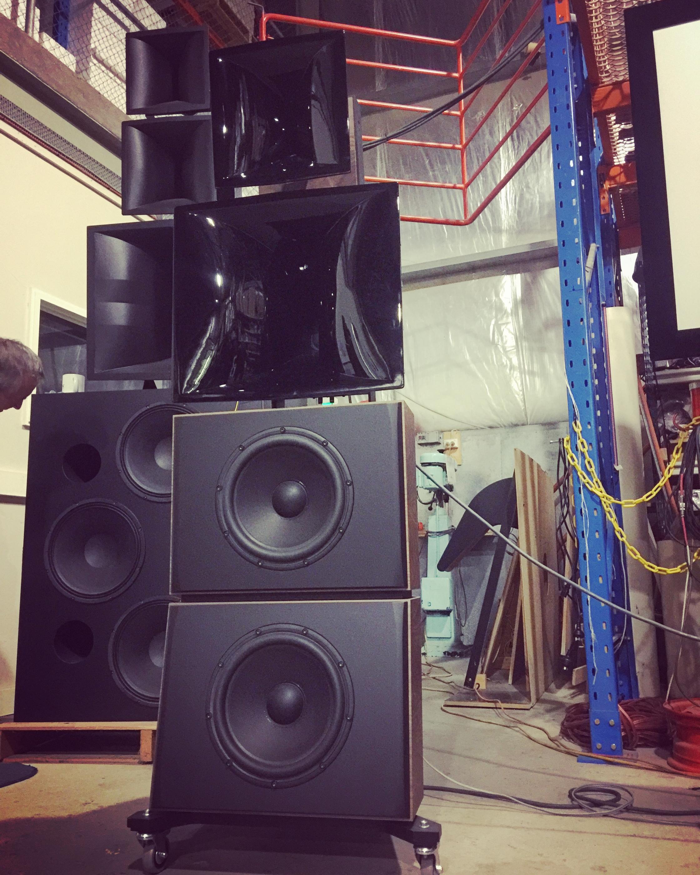

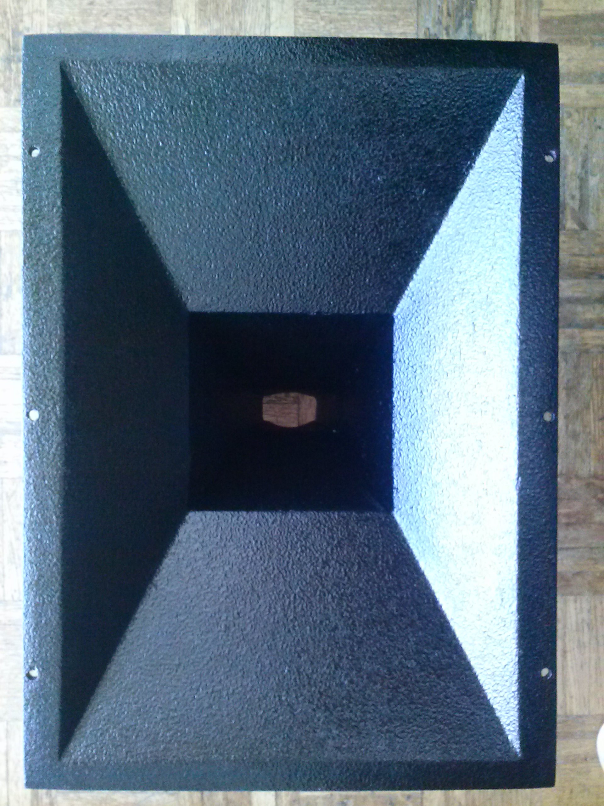

What are the dimensions of the PAS horns? They look somewhat similar to my own horns, except for the depth > mine are 30.8 cm.
Ease of implementing additional XOs is indeed a big advantage of DSP, another is dialing in of horns.
If you have the possibility to play (extremely) loud and/or use Synergies for PA, the coaxials definitely have the edge. For hi-fi at home, the 2 way option (e.g. ND940 + 2x MB12N405) provides more headroom than you'll ever need.
Mine are 75x43 cm, and 40.6 cm deep. (29.5x17x16" D)
Are yours 2" exit too? Like them?
You are really right about the ND940 being more than enough for home (as in way more
Mine are about 61W x W41 x D31, so a little smaller overall. The throat is 2".
Basically they are scaled up JBLs 2380A, albeit with a relatively short diffraction slot(length).
These sound rather nice crossed at 750Hz. I don't recognize the artefacts that many people seem to have experienced with such horns.
Actually I prefer the sound of my horns to almost any of the smaller waveguides.

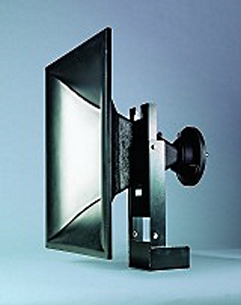

The mouth section of the PAS horns looks quite similar to that of Bjørn Omholt's Bi-Radial horns (designed by Don keele), but the slot appears to be longer.

In general, the shorter the diffraction slot, the less likely it is that typical diffraction side effects will manifest themselves.
The opening of the slot in your PAS horns isn't very narrow, which is also a good thing.
The fact that Bjorn Omholt sold his (highly regarded) Klipsch K402s, because he preferred the Bi-Radials, contradicts the prevalent misconceptions wrt diffraction horns.

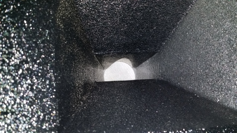

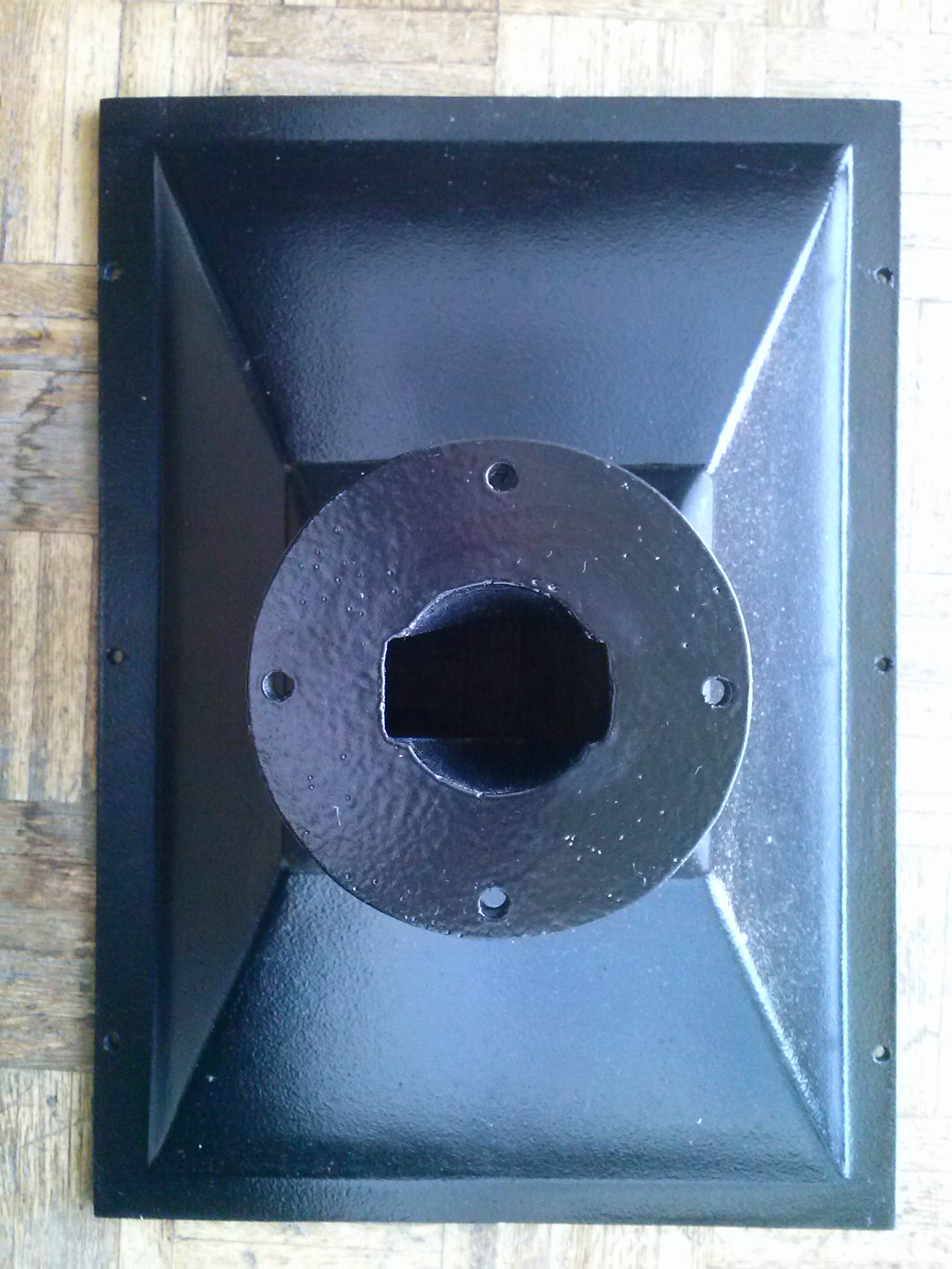

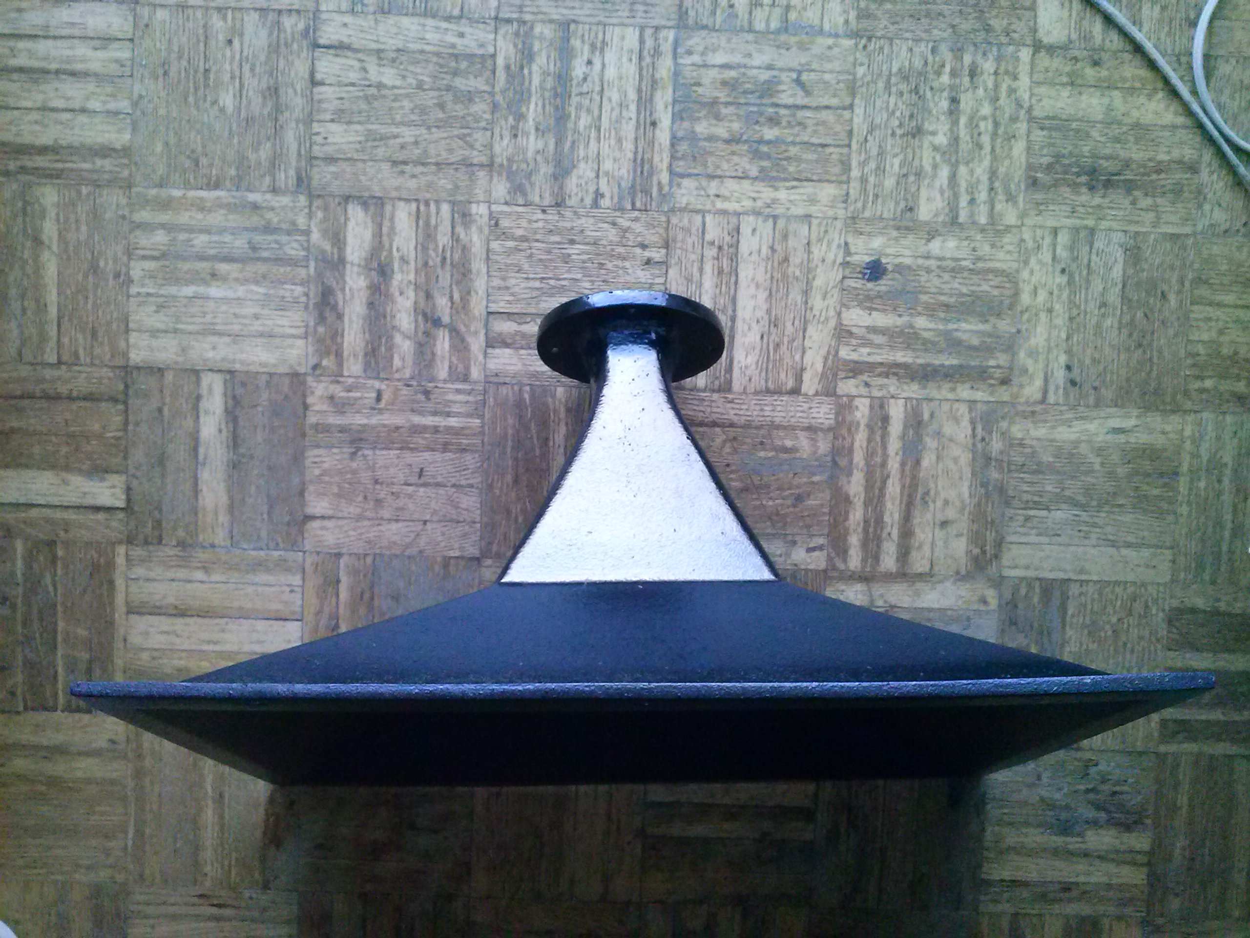

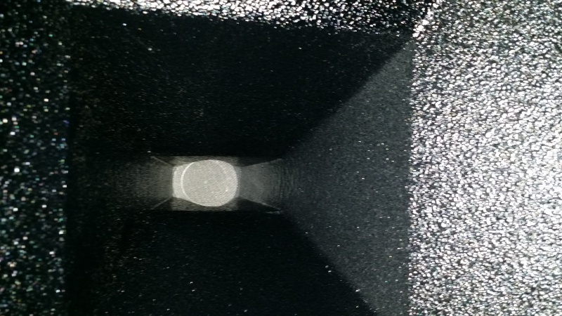

Closeups of the horn that BMS specifically designed for their coaxial compression drivers.

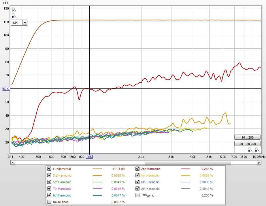

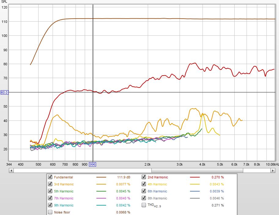

THD plots, dcx464 and bms4594he, taken at same time on xti1464.
In a clothes closet, mic 6" from mouth.
SPL is accurate.
Freq response is accurate, not normalized.
1/48th smoothing, no windows or gating. (Obviously EQ'ed very flat, was trying out a new FIR technique.)
THD % are at 1kHz (996Hz)
I'll need to get outside and run tests at much higher levels to really know anything...but maybe these help anybody thinking about using either of these drivers for home-fi...

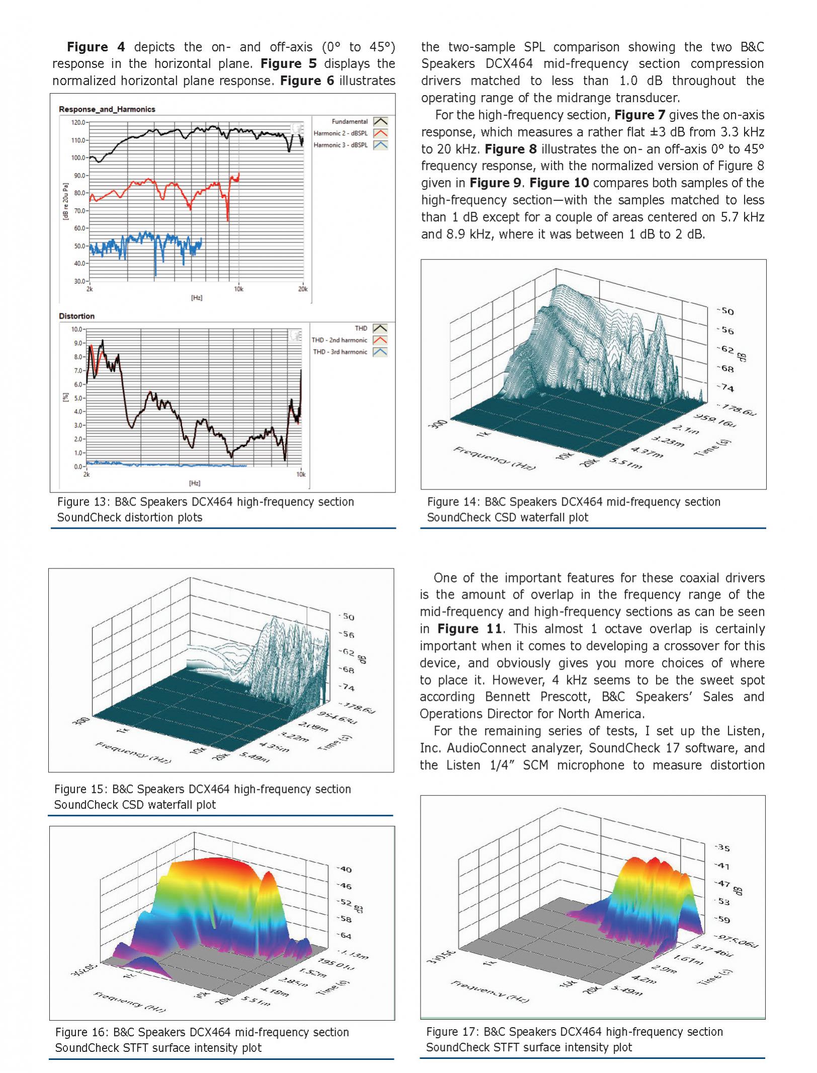

Hi mark100,
I apologized, why goes only to 10kHz?
Hi 1hiep0, harmonics of fundamentals beyond 10kHz all > 20kHz... beyond audibility.
