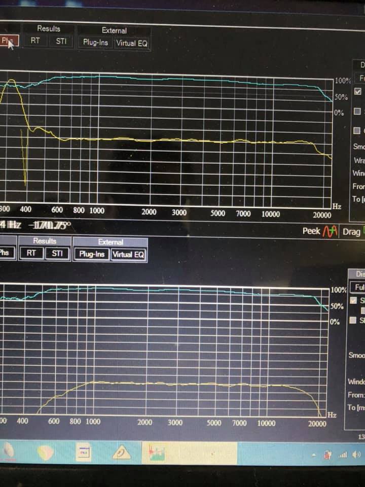

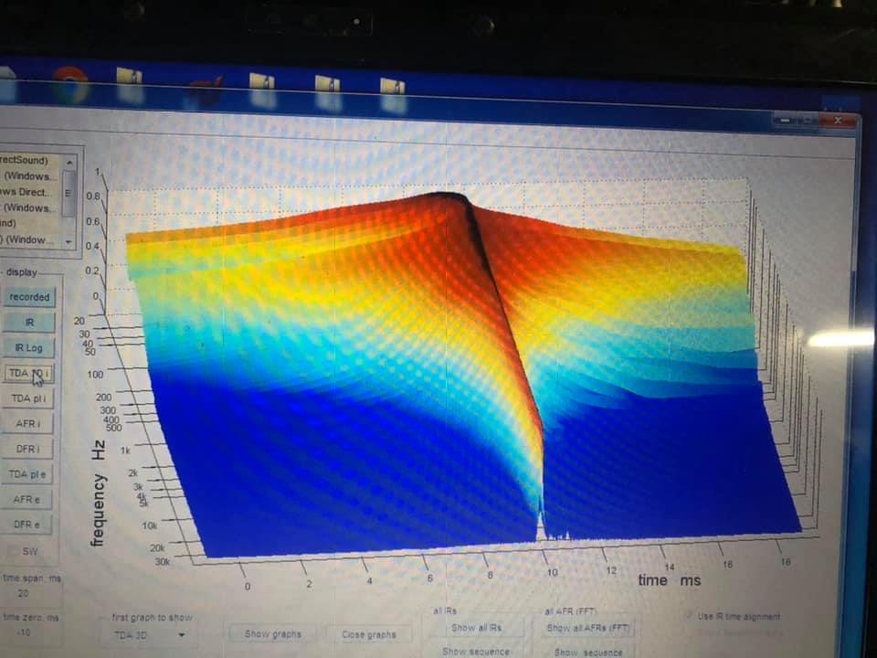

This is what I managed to get out of the DCX464 with a Lake LM26.
Top - phase +/- 180 , bottom 2 dB per div 1/3 Oct smoothing Xover 600Hz & 3K2
My initial thoughts regarding a comparison with the BMS4594 -
• The 464 goes lower and louder
• The HF is not quite as extended as the 4594
• The distortion and water fall behaviour is better
• The crossover HF/VHF is much easier to implement

Thanks a lot for the input! Could you please give us your subjective impressions on the differences sound-wise between the BMS 4594HE and the new B&C DCX464?

The DCX464 sounds clearer and more natural through the mids. The BMS4594 has a lovely sparkle or air to the VHF that I suspect is not 100% correct, but it does sound nice. The DCX464 does not have the same sparkle but at the same time I can’t fault what I’m hearing.

I have been doing a bit more work, so just to add a bit more - I think some of the sparkle I hear from the BMS is distortion, as such the target curve that sounds the best for the VHF is perhaps a little rolled off to compensate for the distortion (which does sound nice). In comparison the 464 needs to be flat, requiring a bit of a boost around 18K to do that.
FWIW I’m VERY happy with the results I’m getting now with the 464.

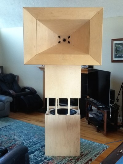

All my attention with the dcx464 is still into this project...here's latest incarnation....over push-push dual 18".
The dcx is sounding very, very nice in this syn attempt...happy camper.

Thanks again Ro808,
I've been using 2x12...rcf mb12n351's...the same drivers used in the Peter Morris design.
Crossed to subs at 120Hz...trying not to have to use reflex ports in the synergy.
But I just switched to a different pair of 12"s I had...mb12n405's..because I think these will work down to 100 Hz without ports. They are really heavy bastards or I would have been using them all along.
So far, I've been crossing from the 12"s to the CD at 650Hz...but this has been mainly to have a more direct comparison to other boxes I have set up at that cross freq, such as the PM60/90.
I plan to try dropping to 500Hz soon...
Based on T&S the MB 12N405 is slightly better suited to sealed than the MB12N351.
As you pointed out, the 405 is more robust and will take some beating/boosting.
If driver spacing allows a crossover >600Hz, the RCF ND940 is a viable and less costly alternative to the coaxials.
One less crossover point isn't a bad thing either.
BTW, how did you like the the PAS horns compared to the XT1464 and HF950?
