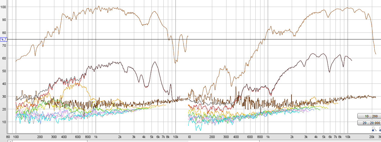

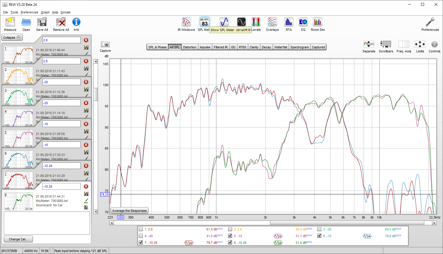

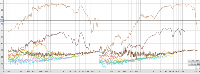

SEOS24, ~2.8 V, Umik @ 1 m from mouth. And two-sample SPL comparison.
as a comparison I found a BMS 4594nd on SEOS24 (unspecified power level)
@ 0.88 V. I can send you rew file))It would be interesting to see how distortion looks at 95dB/1m also.
