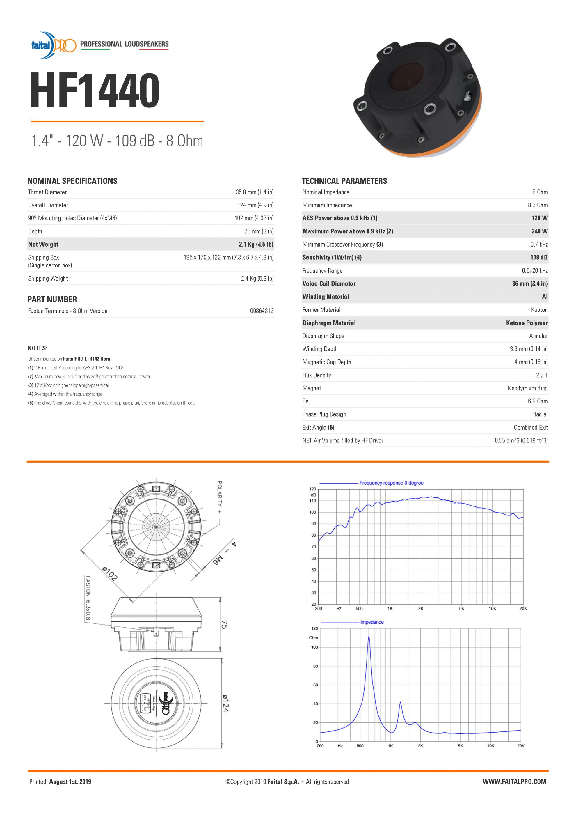

Personally, I am looking forward to this driver (soon available):
of course i am looking forward to Faital's 1440 too? Any news?

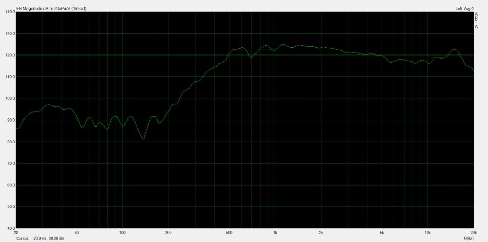

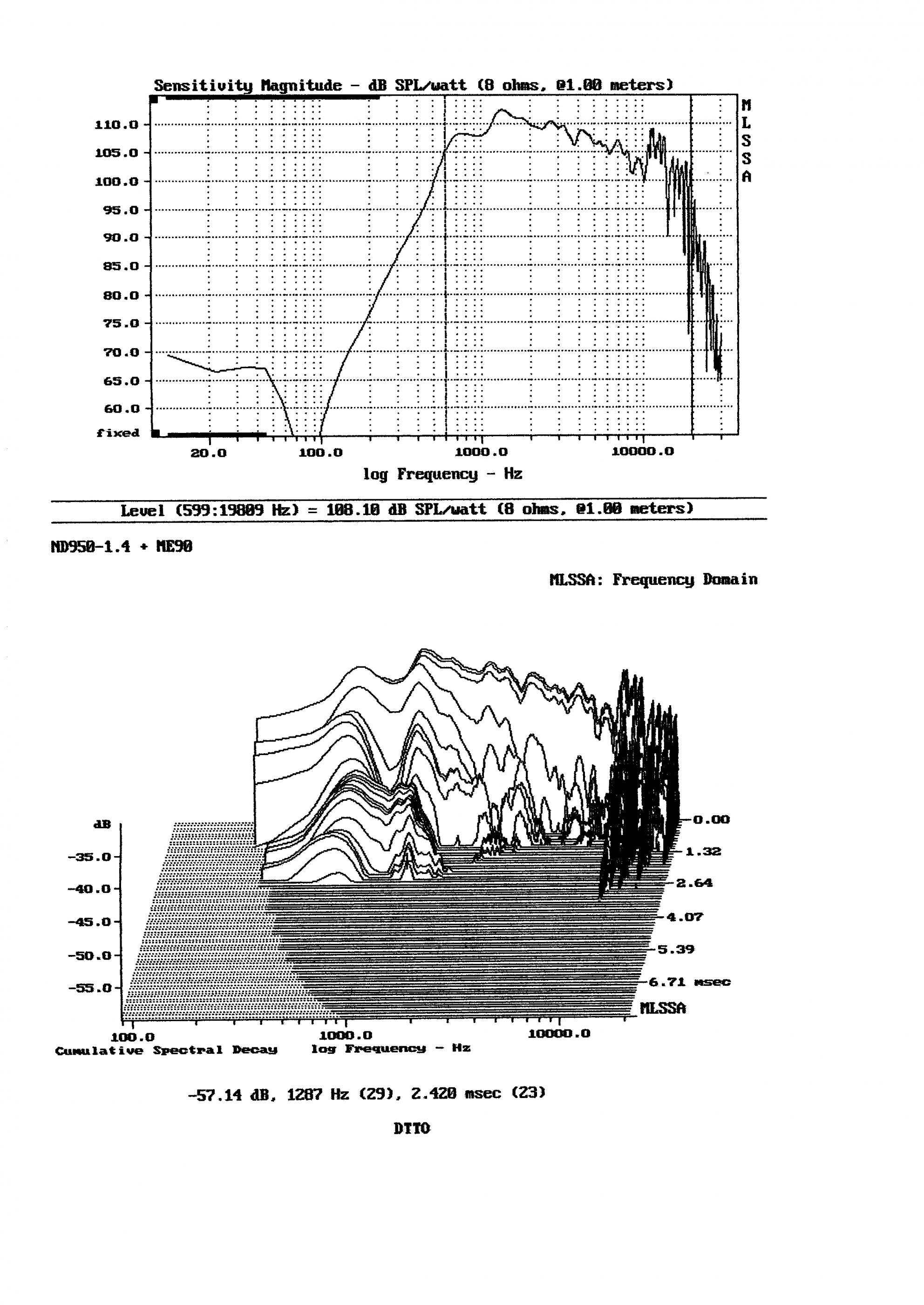

I really like the Radian 905PB as well.
RCF ND950? Why?
KR Barossi
Because the midrange is very good. Breakup is pretty intense, but no worse than some 3" drivers.
The ND850 is better on top, but not as good as the Faitals.
2nd plot is the raw response of a ND950 2.0 on a JABO-72.
Delivery of the first production run is scheduled for the end of September.

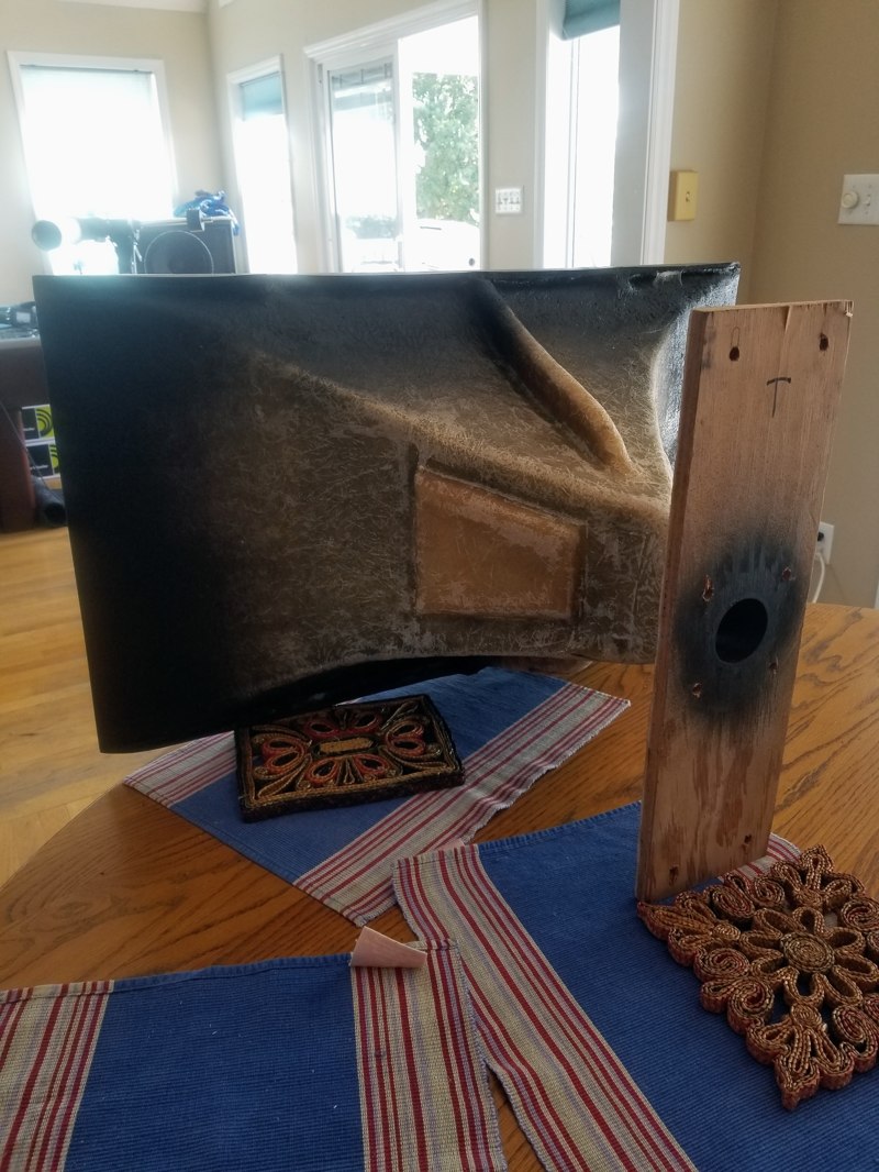

Anybody know what horn this is ??...cabinet and horn says Professional Audio Systems and it has a RH SSD 3301 2" CD
No idea. Looks like a goody though. Should load fairly low? How does it compare to hf950?

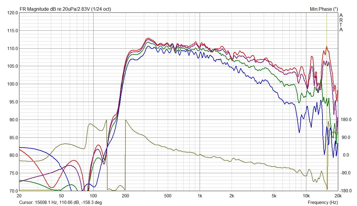

Very few - MF/HF Re 6.2/8.2 and 6.3/8.3
