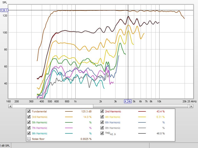

THD plots, dcx464 and bms4594he, taken at same time on xti1464.
In a clothes closet, mic 6" from mouth.
SPL is accurate.
Freq response is accurate, not normalized.
1/48th smoothing, no windows or gating. (Obviously EQ'ed very flat, was trying out a new FIR technique.)
THD % are at 1kHz (996Hz)
I'll need to get outside and run tests at much higher levels to really know anything...but maybe these help anybody thinking about using either of these drivers for home-fi...
DCX464 first ....this is it's thread, huh?![]()
The most important / noticable measurement is 3rd harmonic distortion - 0.0077% Vs 0.0068%.

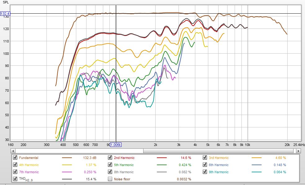

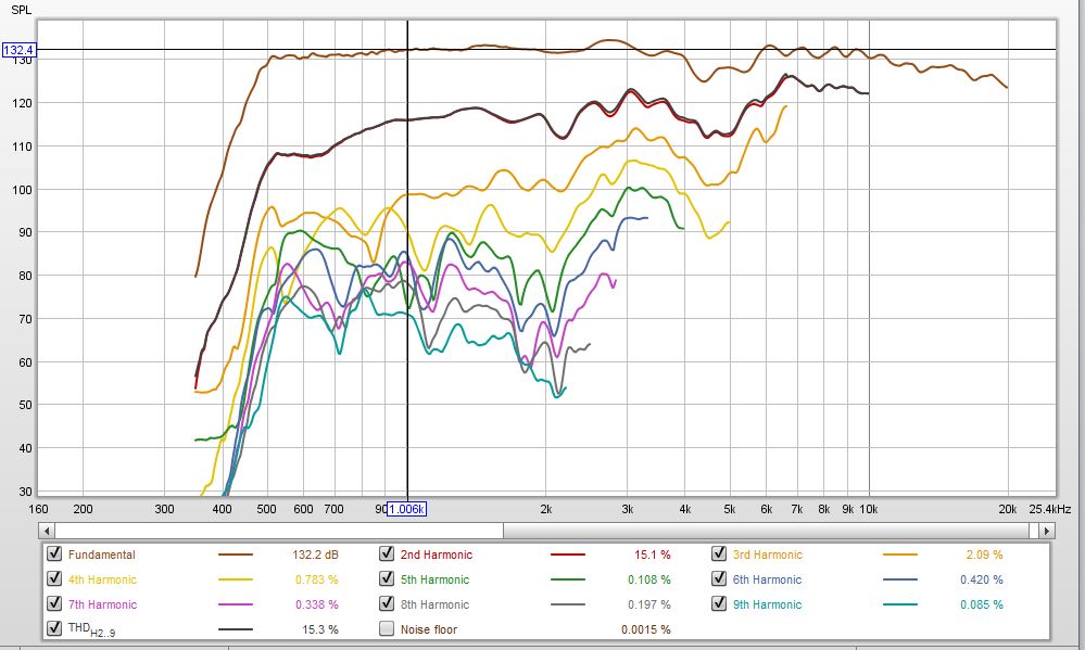

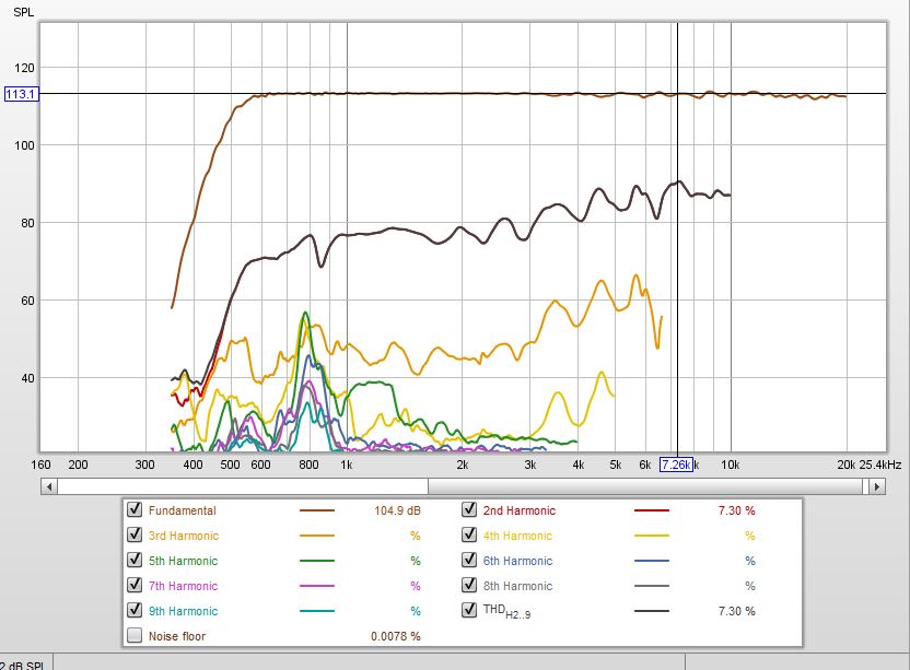

Anyway, I'd did get to make a bunch of sweeps of both drivers just now, tuned for flat SPL.
I stopped at 132dB to give folks a break.
SPL is accurate from 1m. Actual distance was 8ft. Same xti1464 again.
First is the dcx464; second the bms4595he
dcx 500Hz and 3.2kHz xovers; bms 500Hz and 6.3kHz

I figured that's where you headed. Yeah, I'd like to do the whole compression / M-Noise routine, but i can only get away with so much in the neighborhood...especially given that my testing is off a deck pointed out over a large lake ...and carries forever and then some.
Wow, nice work, do please be careful if testing at higher levels as possibly getting a little warm at those levels with pink noise and not sure they would be safe measured much higher?

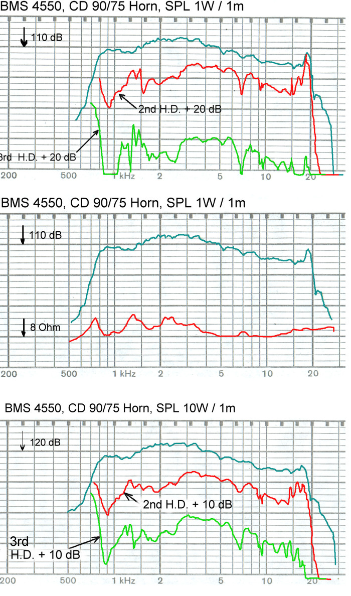

Re distortion, seems to confirm the trend as shown in the BMS distortion curves in their 4550 published data (kudos to BMS for being brave enough to publish these curves, i don't know of any others that do), looks like at their peak ratings, there could be more distortion produced than the fundamental.
If you do find time and your neighbours are forgiving enough, REW as you probably are aware is able to measure IMD, I have found very little info anywhere on the web about IMD and compression drivers.

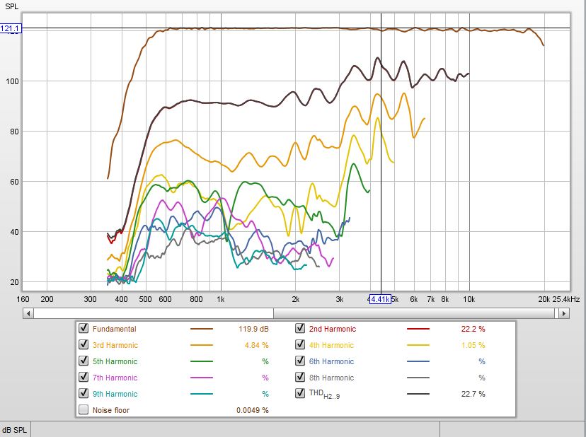

The DCX464 THD hits around 90% just above 4kHz, dropping back to around 30% above 4.5kHz. Does distortion in the 3-4 kHz range (where "normal" hearing is most sensitive..) improve if the crossover is raised above 4kHz?
Could you please post some of the lesser (like 120 and 126 dB SPL) distortion sweeps ?

These results are very interesting the harmonic distortion at 130 dB seems similar to the JBL cone midrange horn loaded drivers in this tech note:
https://adn.harmanpro.com/site_elements/executables/19573_1571427998/CMCD_TechNote_original.pdf
Absolute SPL capability is of course lower, but as your results show the harmonic distortion is getting a bit much at 130 dB anyway.
I would be interesting to see at what SPL each driver can keep below 10% THD as a metric of the usable SPL (or is 10% too generous?).

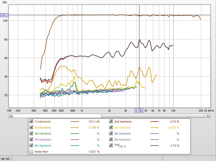

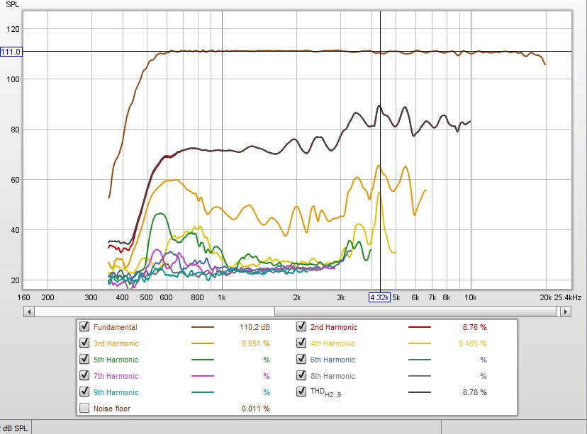

Thx guys !
Here's a set for the dcx464....... 106 to 126 dB, in 5 dB increments.
With cursor set close to peak THD.
I think i should play with the crossover to try to optimize.
It might be better to share the load between sections...these were steep LR16 xovers....and maybe move xover freq up a little from 3.2kHz...

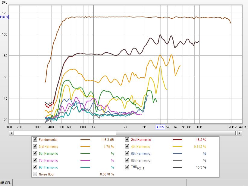

Yeah, 10% is kinda an industry standard huh?....
In the set for the dcx, the 111dB plot is the last one that stays below 10%.
I don't have exact matching SPLs for the bms, but here's one at 113dB.
(118dB goes above 10%, to 12.4%)
You'll notice peak THD occurs higher up in frequency.
Oh, on all these plots I've posted....I've noticed on some of them there is a discrepancy between the SPL per the cursor, and the SPL in the chart below.
The cursor is correct. Evidently, when i added 8dB to each plot to account for mic distance, on some i hit REW's 'Add to Data' and others i didn't.
