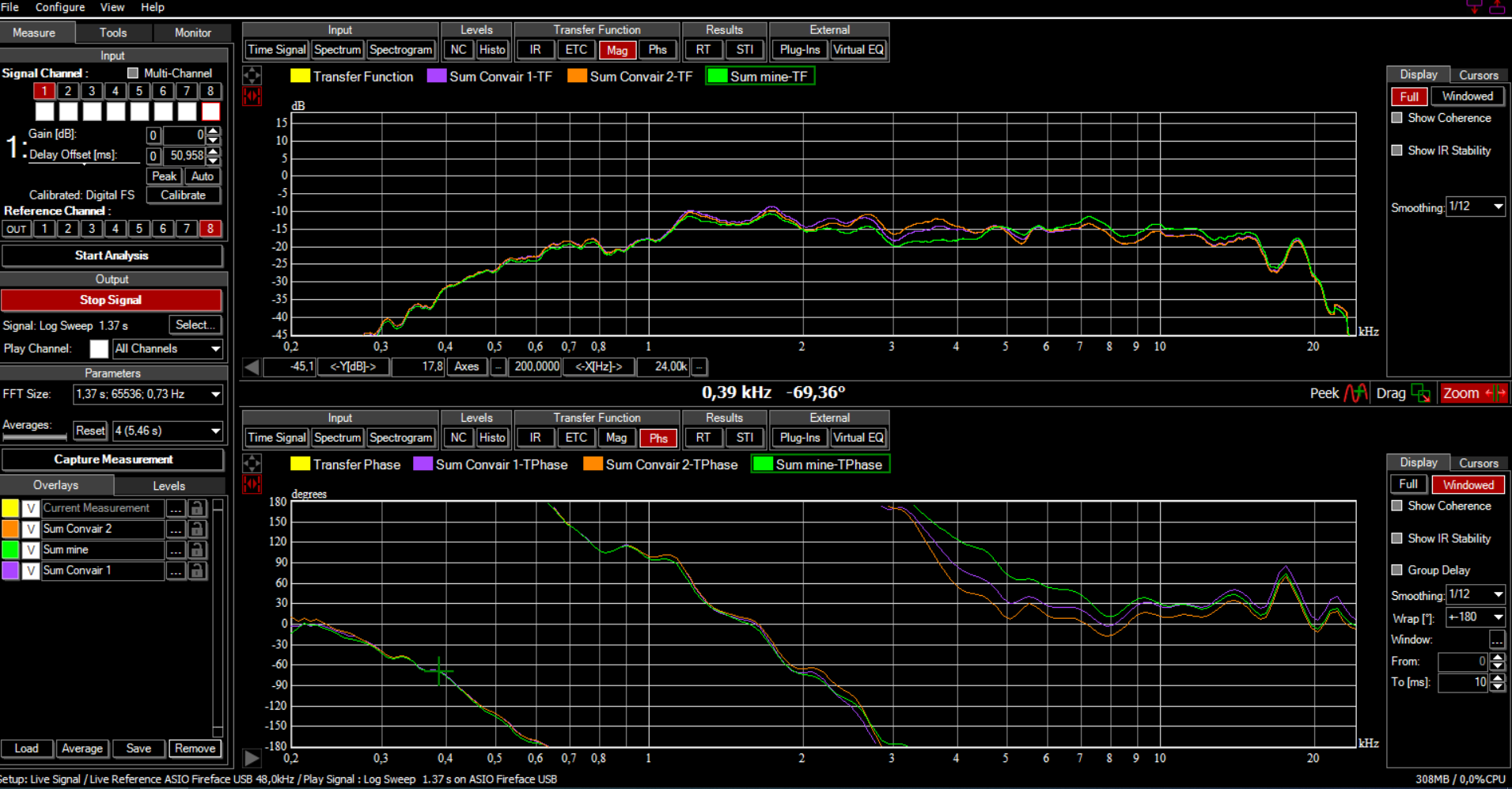

Has anyone experimented with passive crossover circuits for the DCX464?
Not with 464, but 462.
Design goal was good phase tracking and well behaved impedance, not flat frequency response:
6 parts
Any thoughts about this crossover:

With the wealth of information given by Convair it should be possible to reverse engineer the crossover, which I just did.
I am only a little bit unsure where the 4.7 and 3.3 caps belong,
one way seems better but the PCB pic suggests the other way round.
Anyways they acomplish a flatter FR than my design at the cost of slight substraction above crossover point, means phase tracking above crossover isn´t as good as mine.
Also they omitted HF protection, which will be absolutely okay for Hifi.

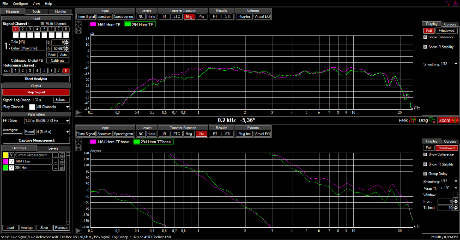

Hi UR155, haha ...an IIR phase matching skill I see absolutely no sense in acquiring,
But seriously, very nice.
I'm left thinking the reported dip in the mid at 3.5k is entirely horn specific.
Because I see the dip at 4k on an xt1464,
and on a bunch of different frequencies with various synergy attempts.

Let´s assume there would be a horn for 464, which could be used down to 300Hz.
Would you not want to have similar radiation area in the passband below ?
Hi Uwe
Have you come up with any favorite horns for the 464 ?
Still using the 462
Limmer 264 is hard to beat regarding size, directivity and bandwidth. And it has the 294 brother, which is not far behind.
So I have not looked any further, because this works for the 15" utility box as well the hornloaded 2x 12" ( hopefully ).
