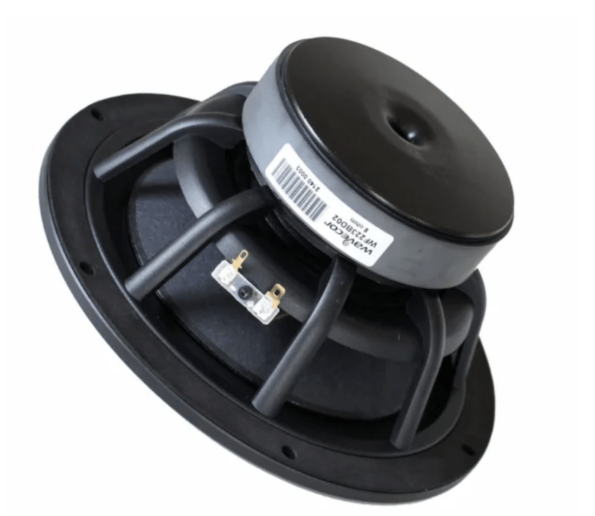

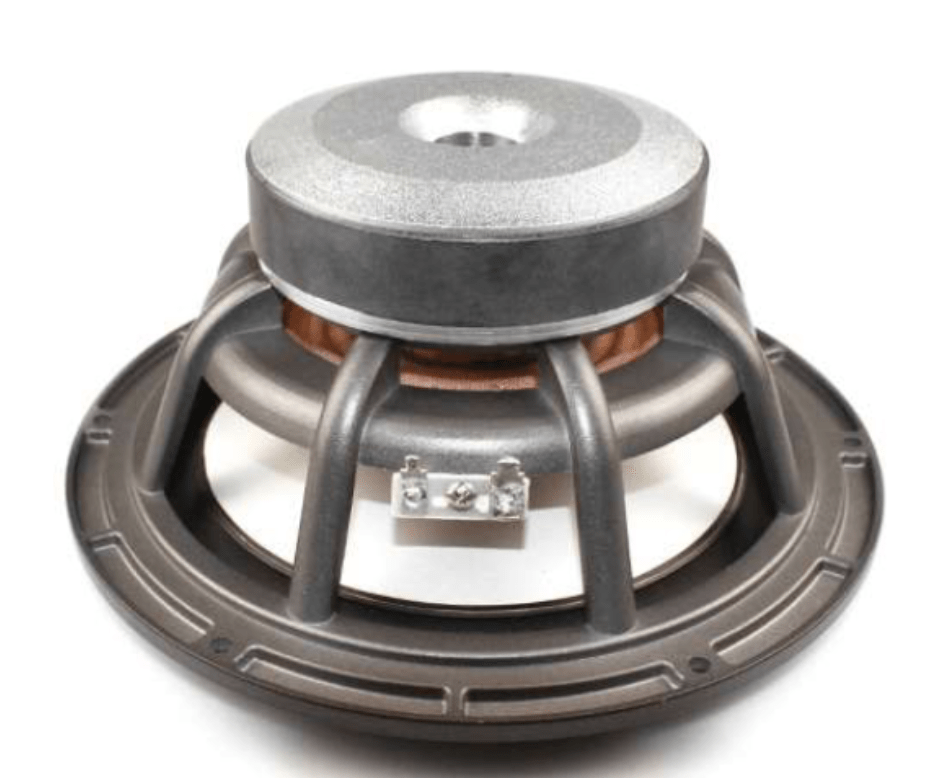

When you look closer at the Fountek WF222 and the Wavecor WF223BD. I mean - look at the chassis/basket, magnet, shape.... Aren't they very closely related - besides the obvious color, cabinet sealant, sticker and cone/dome difference??
https://doc.soundimports.nl/pdf/brands/Fountek/FW222/FW222-data-sheet.pdf
https://www.parts-express.com/Wavec...ber-Cone-Mid-Woofer-8-Ohm-298-1214?quantity=1

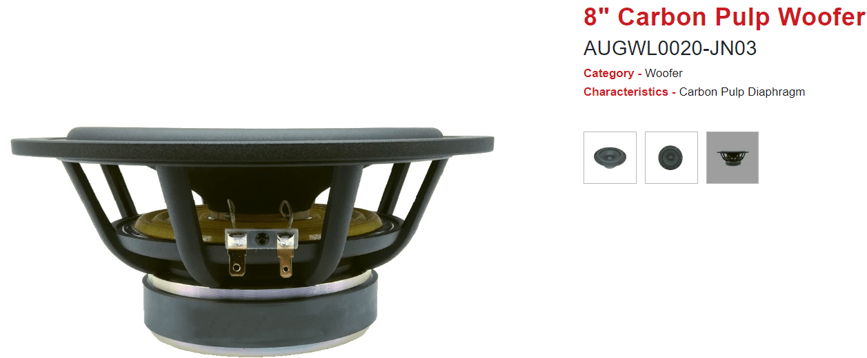

This Punktkilde shares the same basket as well.Another thing....
View attachment 1257189 View attachment 1257190
https://www.punktkilde.com/augwl0020-jn03#product-menu
108Eut at Soundimports, looks good in 35l BR.
Good find Sadly only 4 ohm and I want closed box.This Punktkilde shares the same basket as well.
