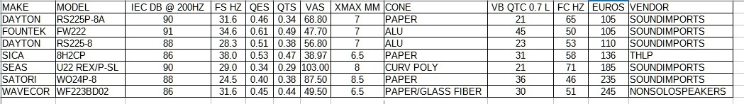

Actually, the Fountek also seem to have the best parameter for the job. It has much lower VAS and looks pretty nice + I get my alu-cone too, so I can sleep nicely at night, knowing no paper is going to color my sound . My KEF is all black though... but I still appreciate the effort a lot
Though.... The fountek has no proof of shorting rings, copper sleeve or distortion measurements. And no known design with the WF222. So I would be a first-mover.... if I buy'em
To round a bit.
Qms is roughly a partner with low VAS and the need for less box volume - since Cms is the true physical resistance - meaning - the distance the cone can be moved with a fixed force - correct?
Paper and paper-mixed cones have higher inner damping, with the compromise of "eating" up details in the acoustic output to smooth the response - true - just a little or simply ignorant - unless specified in the datasheet like with the Silver flute?
Most parameters will still give you quality bass with most woofers, since it is only a matter of box volume, closed vs reflex, max SPL and lowest possible F3, because all the other bells and whistles, mostly matter in the lower midrange and up - around 500Hz - true?

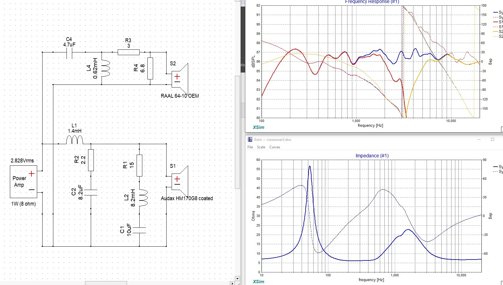

For those who want try great Audax project. FRD and ZMA made by Clio while speakers was mounted in box from picture! Cosower simulated than project finished with great sound and dynamic.
Note that https://en.toutlehautparleur.com/br...ker-audax-hm210g6-8-ohm-8-27-x-8-27-inch.html is not treated paper cone and you will need to treat it with https://plaidonline.com/products/mod-podge-gloss-64-oz-cs15091 , I have bough 5 years ago https://en.toutlehautparleur.com/speaker-audax-hm170g8-8-ohm-6-54-x-6-54-inch.html very nice sounding driver in my TL speaker project, it was not paper treated so i treated it with ModPodge and got almost the same graph measurement as per datasheet, without treatment it have some distortions in 2-3 k and up region!I will add to my previous post that it is valid for all mentioned drivers used for woofer duty >500Hz.
Savan: thanks for the recommendation, I was looking at this paper Audax recently and thought it could be good. It models well in 40l BR. HM210CP. HM210Z12 and C0 are likely good sounding woofers as well.
