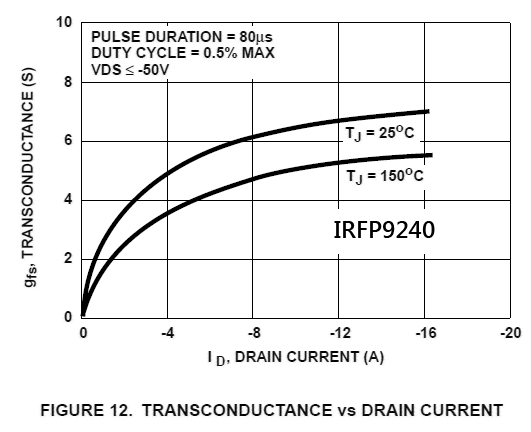

Hi indra1,
Your approach is correct. The equation for Kp using gm or gfs neglects Rs degeneration, which is OK for starting values. The video you mention does not cover adding Rs. When you add Rs the value of Kp needs to be higher. I have a white paper (Pt.1) here VDMOS - PAK2 devo
Using gm@Id is a useful short cut to get Kp because you don't need to solve simultaneous equations like in the video.
I usually use Vishay datasheets. They don't have Gfs vs Id plots for the IRFP240/9240 but they do give gfs at one Id which is enough to calculate the starting Kp. EG
Vishay IRFP240 the gfs=6.9 A/V at 12A so Kp=2 (min) and using typ=1.3min gives Kp=2.6.typ and no Rs.yet.
Vishay IRFP9240 the gfs=4.2 A/V at 7.2A so Kp=3.6 (min) and using typ=1.3min gives Kp=4.7.typ and no Rs yet.
The Vishay datasheets give higher Kp's for the p-channel by a factor of 1.8 times. That's why Bob Cordell and my models end up with a Kp of 5 or 6 for the IRFP240 and 9 for the IRFP9240.once Rs is accounted for.
If your amplifier has a lower Kp for p-channel FET's than the n-channel FET's and you want your simulations to match your amp then by all means tailor the models to match your FET's.
BTW What brand of FET's are you using?
... I usually use Vishay datasheets. They don't have Gfs vs Id plots for the IRFP240/9240 but they do give gfs at one Id which is enough to calculate the starting Kp. ...
Thank you for the link Ian.
No wonder, the problem seems to stem from min Gfs value of the Vishay data. :)

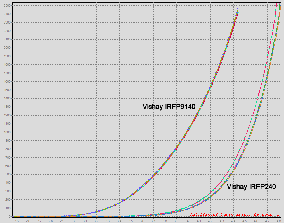

Folks at the Pass forum are using a lot of IRFP240/9x40 and in most cases, the actual Gfs of the N is higher than the P. Attached are the measured Id/Vgs curves of typical Vishay parts made by another member, published in Pass forum a few years ago.

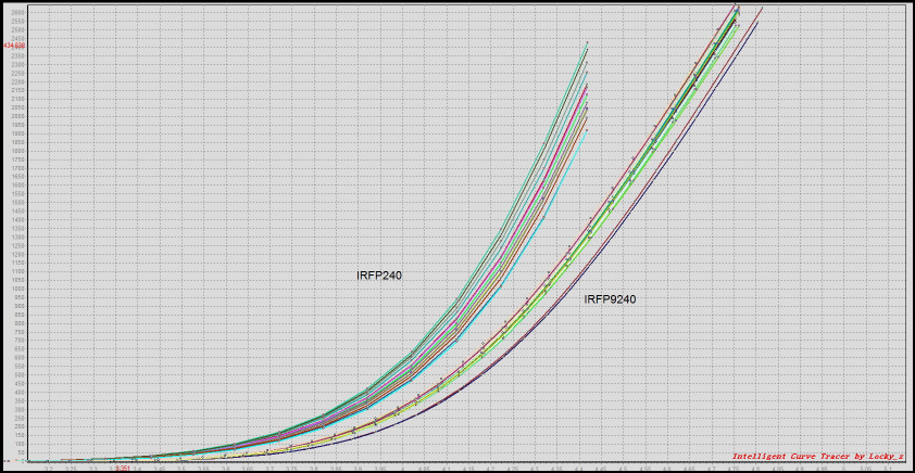

LTspice IRFP240 + IRFP9240 plots with measured gm's
... Attached are the measured Id/Vgs curves of typical Vishay parts made by another member, published in Pass forum a few years ago.

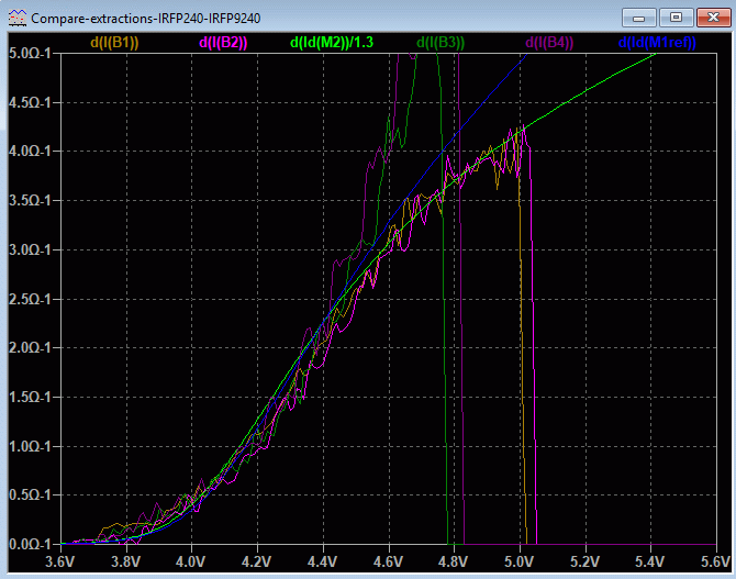

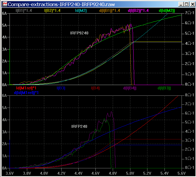

Hi indra1,
Thanks for posting the measured curves of the IRFP240, IRFP9240 and IRFP9140. Very useful to check the Vishay Datasheets and my models from those datasheets.
I used GraphGrabber to capture the data to get Tables in LTspice to compare with my models. The jigs are attached. BTW in my white paper I explain how to capture data to get it into LTspice. Plotting measured gm's is very useful!:)
The data from these plots fits myIRFP240 model well -- after trimming out Vto variations for the sake of comparisons.
My IRFP9240 had a gm and Kp about 1.3x too high, Reducing the Kp of my p- model brings it to about the same as the n- model (6A/V^2).
The attached gm screen plot shows the measured p- and n- gm's. The 4 measured plots are the highest and lowest from the p- and n-measured data. Model gm's (smooth) after the p- has been scaled by dividing by 1.3. No scaling used for the n-channel.
attachment.php
Thanks again. This has been a big help for me to compare my IRFP240/9240 models with real data. I haven't updated my model yet. I'll check first with Bob Cordell if he is doing an update and sync models if we can. In the meantime you can change my IRFP9240 model Kp to 6 and it will be close to the measured curves (and maybe use Bob's Vto of -3.76).
BTW the attached jig also contains captured data for the IRFP9140 curves.
