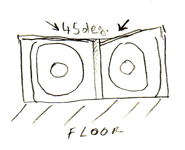

Awhile back in this thread, mutiple woofers on open baffles was discussed. Adding one woofer each at floor level & at right angle to the outside rear of the existing woofers was suggested by Lynn. I've tried that configuration and have found the bass eminates 'between' the speakers, & reduces the 'stage' width. Reversing the polarity of the added woofers has the bass eminating to the outside of the speakers, widening the 'stage'.
I hope I have described this well enough to be understood.
Since I'm trying for the best arrangement of the woofers at floor level, I'm now planning on relocating the second woofers to the rear of the first woofers in a magnet-to-magnet configuration. In theory, would I expect better bass with push-push or push -pull wiring of the woofers in that configuration?
dobias
What about this configuration? It works for PA. Only difference here, is that is going to be open back.

I think that the present 90 degrees causes the phase problem. I meant to add in the previous post that changing the 90 degree rear woofers to out-of-phase makes the sound stage vague, or smeared.
I had hoped to put third 12" woofers to the opposite sides, making a three sided enclosures, but I'm wondering what problems I'd encounter having three woofers with their backs so close to each other.
I'm afraid putting the rear woofers at 45 degrees on each side would make the baffles a traffic hazard in my living room & would cause problems with my long suffering wife.

dobias
In general, the front facing 45deg inwards angle, is aiding coupling between woofers (more dBs and coherency), and is going to reduce the sheer width of the baffle base in exchange of some depth, which is normally non human traffic space behind the speakers. You can also hinge the two halves in the middle and play with the angle, until it sounds best in room.

Would it be a solution for me to divorce Wooofers #2 & #3 to separate horizontal baffles (to keep them at floor level). Having 4 baffles would make it a little easier to arrange than two large ones.
dobias
