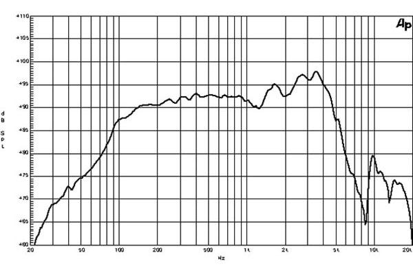

I have done a basic measurement of the speakers that we ordered - 2 ft, on-axis, free-air. The purpose was to complete a quality check and determine if the four drivers behaved the same. I determined that they all worked fine, and three of the four has an almost identical HF roll-off behavior. The odd-ball had a similar shaped response with a couple-hundred hertz shift in the feature frequencies.
Further measurements are on my to-do list for this project. When I complete the CSD measurements I would be happy to post them here. Realistic time-frame for these measurements could be as much as 3-4 weeks - but I'll post them as soon as I get them.

What advantage does the 18Sound 8NMB420 hold over the B&C 8NDL51?
I used the B&C as midranges along with JBL compression drivers in my old Honda Accord. They're fantastic midranges. I have measurements of the setup over on AudioGroupForum.com. I wrote about them in a few threads over there; here's one.
For my current project I am using the 18sound elliptical waveguide you mentioned, along with a BMS compression driver, a Dayton midbass and Audax woofers.
Thanks for the 8NMB420 specs!
The 2nd harmonic rise at 3.2 kHz, combined with a fair amount of CSD energy storage at the same frequency, strongly indicates the use of a steep notch filter regardless of the rest of the crossover topology. It also looks like use above 2 kHz isn't a good idea, again based on a fairly steep rise in distortion starting at 1.8 kHz and increasing CSD energy storage in the same region. I agree that data of this quality for the 10NDA610 and the 12NDA520 would be most interesting.
Integrating the B&C 8NDL51 with a ribbon crossed at 1.8 kHz looks like it would require two notch filters, one right at the crossover frequency (very awkward) and another somewhere between 2.8 and 3.5 kHz. My experiences with multiple notch filters have not been positive - tuning all of them against an electromechanical system that is working its way into breakup isn't easy or simple. I suspect in professional use they simply use active 24 dB/octave crossovers set at 1.2 kHz or lower, and just dump the troublesome region into the reject band.
Since pro drivers are typically designed for active crossovers with very sharp slopes, I surmise less attention is paid to controlling resonances and breakup in the out-of-band region. The ultra-high-priced exotics don't really distinguish themselves here either - whizzers certainly don't help, that's for sure. At least those dreadful whizzers aren't used in the pro world.
The reason I'm going on about these peaks is they not only concentrate distortion, they tend to be quite directional, which defeats equalization and makes time compensation, even in the digital realm, counterproductive. The pro approach of steep filtering has its issues as well - the colorations are attenuated, true, but they are certainly not reduced to zero, and tend to pop in and out of audibility depending on program level and spectral content. Play massed choral at symphonic levels and you'll hear the resonant colorations come and go in a very disturbing and annoying way.

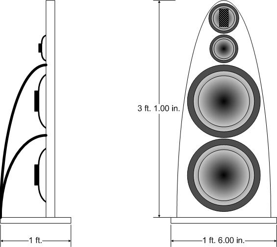

Since this is becoming a reference dipole thread...
I have questions regarding diffraction and reflections on a wide baffle.
If the entire baffle surface is curved instead of flat, how much can this affect diffraction?
If a curved surface can help eliminate diffraction for a midrange and tweeter, how do you calculate a radius that will do this?
I ask because the R909 baffle surface is obviously radiused for an acoustic reason, not just an aethetic one. A wide flat baffle with rounded edges will still have reflection problems through the midrange.
Any help is appreciated,
C
p.s. I have attached a concept picture that is an alternative to the wide flat rectangular baffle. Comments?

From FRD-BDS simulations I found a radius of 50mm - 100mm to be suitable for normal baffle widths from 150mm to 300mm with a crossover point around 2-3kHz. Think of wavelengths. A smaller radius would only have an effect on higher frequencies but at those frequencies tweeters beam so round edges have very little effect. A larger radius is unnecessary because below 2kHz the midwoofers play a dominent role and their larger cone areas (think of distances of sound sources from the edges) would make diffraction to be a non-issue.
I selected 70mm radius for my new U-frame OB speaker. the FRD-BDS simulations show the baffle diffraction to be very smooth. With a proper XO, I can get to +/-0.2dB or even less from 1kHz up provided that the drivers are ruler flat, in constrast to a sharp edge baffle that usually exhibites up to +/-2dB from 1kHz up.
Note that all of these are based on on-axis response and my guess is that for rounded edges the off-axis response will also be a lot smoother.

Re: Since this is becoming a reference dipole thread...
If I were you, I would start a new thread on the topic of diffraction, and see if you can get the attention of Dr Geddes. He lives for this stuff, there is absolutely no one in the world who's put more thought into the subject of diffraction. And lucky for us, he posts here. We were talking about his Summa speakers one day, and he mentioned that a HOUSEPLANT near the speaker was causing diffraction effects! Can you imagine that?
Are you sure you're approaching this problem from the right perspective?
As I see it, the WIDTH of the baffle and it's TERMINATION are the primary concerns.
Here's why:
The width of the baffle will cause a frequency response dip based on the frequency that's equivalent to the width. For instance, with a 12" wide baffle response will be down 3db at 380hz. (Olson's formula from trueaudio.com.)
:: BUT THERE'S A CATCH ::
That formula doesn't take TERMINATION into account. If you use a SERIOUS round-over, the transition is MUCH gentler.
That's why the Summa's have a two-inch roundover on all edges, which makes the cabinet expensive and difficult to manufacture.
Make sense?

Originally posted by chrismercurio I ask because the R909 baffle surface is obviously radiused for an acoustic reason, not just an aethetic one. A wide flat baffle with rounded edges will still have reflection problems through the midrange.
C
