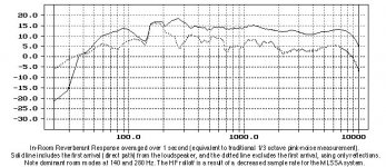

Well, here's a real-world example, comparing the first-arrival energy vs all of the room reflections in the first second. Note the first-arrival SPL is 6~8 dB louder, despite the multiplicity of reflections in the room. Note also that with careful design, a conventional monopole can have a reasonably similar room-energy spectra compared to the direct-arrival sound.
I think it's easy to be misled by the "constant-directiy" argument. When the auditioner is sitting and listening to the hifi system (and the seat is somewhere in the 60-degree forward plane of radiation), they are not directly aware of the shape of the polar pattern.
What the listener hears are three things: the direct-arrival in the interval of 0 to 3 mSec, the summation of a large number of reflections from all directions in the 3 to 30 mSec interval, and if the acoustics are difficult enough (like a subway tunnel), discrete echoes in the 30 mSec and longer interval.
It's the ratio of direct to room-reflection spectra that matters, and how much they diverge from each other. The only way to directly audition the polar pattern is to do the obvious thing and walk around the loudspeaker, and walk close enough so the direct-arrival sound is much louder than the room energy.
I think of it in visual terms - direct vs indirect lighting, which look quite different in terms of illuminating the subject. I personally find the objective of minimizing room energy quite undesirable - the times I've tried it, putting loudspeakers outdoors didn't sound realistic at all, at least not in spatial terms. Maybe if the speakers are really awful PA speakers, it's an improvement, but for a high-quality speaker intended for reproduction of classical music, listening in a completely "dead" environment sounded grossly unnatural.
Now, if you seek the PA-system criteria of "intelligibility" for movie soundtracks and other Dolby Digital/MP3 degraded media, that's a completely different goal than musically satisfying reproduction of live music played with acoustical instruments in a symphony hall or recital room. If my primary goal was intelligibility, yes, I'd be looking at controlled (narrow) directivity systems too.
Speaking for myself, I find the goal of "intelligibility" fairly far down the list, and one that is met by nearly any half-decent hifi system with a half-decent (uncompressed) source. There were plenty of hifi systems in the Fifties that met this goal with LP's, prerecorded tape, and FM broadcasts. In subjective terms, clarity (the superset of intelligibility) and dynamic impact are important, but so are tonal realism and a reasonably convincing spatial illusion.
Going back to the quote about the houseplant, I don't find it all that outlandish. Putting anything close to a free-standing loudspeaker causes quite noticeable changes to the sound - especially if the reflector and/or absorber is close to one speaker but not to the other.
It's the distance of the offending reflection that's critical - anything within a metre of the front surface of the loudspeaker is going to have a fairly noticeable effect on image quality (as well as causing subtle colorations and loss of clarity). My own rule of thumb is to keep a one-metre sphere completely free of any reflections - as measured from the emissive surface of the tweeter and midrange.
On the other hand, houseplants make great diffusers at a larger distance (more than 2 meters) from the speaker, along with uneven surfaces like bookshelves filled with books of different sizes, as well as furniture of different sizes and coverings.

Forgive me here Lynn, I'm not trying to bang heads but I seem to see a number of contradictions in some of your comments. You have stated over time that you don't follow the Floyd Tool school nor do you follow the arguments of constant directivity.
Recent examples are:
and then you state:
With regard to the first statement I don't recall anyone claiming that a listener would be aware of or need to know the polar response when sitting and listening in a normal position. Although I will say that dipole, omnidirectional and conventional speakers do all have significant differences in presentation which should make an educated listener able to identify each without walking around the speaker or room.. But the point is more the apparent contradiction of the first statement in combination with the second. The ratio of direct to reflected sound will be strongly dependent on the polar response, combined with the characteristics of the room, thus the argument for constant directivity goes very much hand in hand with uniformity of the ratio of direct to room-reflection spectra over the widest possible frequency range.
Then you go on to say that"
Speaking for myself, I find the goal of "intelligibility" fairly far down the list...
followed by:
By contrast, loudspeakers with good first-arrival time dispersion that also illuminate the room with a well-balanced spectrum (that matches the direct-arrival spectra)
Yet intelligibility is again highly related to correct first arrival time and the ratio of direct to reflected sound and its spectrum, which in turn is strongly dependent on a speaker’s directivity vs. frequency. Thus when you say you want accurate first arrival and uniformity of the dispersed spectrum relative to the direct spectrum it seems to me you are very much saying the intelligibility and uniform directivity are important. I would agree that for reproduction of music it may be desirable to increase the level of reflected sound above that which is typically considered acceptable to maximize intelligibility, but this is really a matter of listening distance and the acoustic environment. Certainly resolution and audibility of low level detail in musical reproduction is cloesly related to inteligibility. I also believe you have indicated you are more of the BBC shcool, however, intelligibility was an important consideration in the development of speakers such as the LS5/9 and LS3/5 series.
I'm a little confused by these apparent contradictions.
