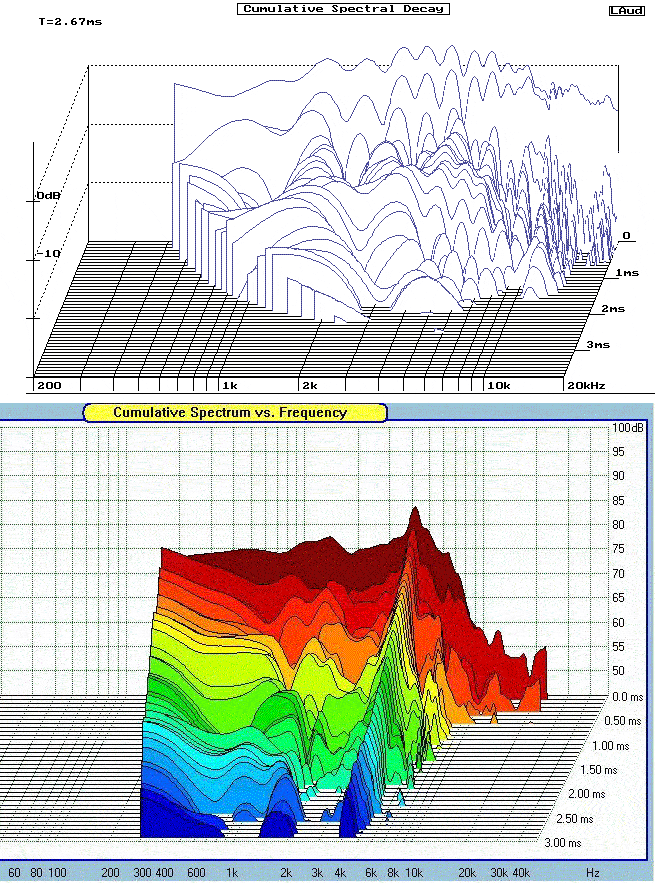

Thanks Augerpro, the data you've measured is most informative. The most interesting driver of the group is the B&C 6NDL38, only one CSD peak to notch out instead of the multiple peaks and HF clutter we see with the others, there's also good HF rolloff and distortion characteristics too, the only downside of the B&C 6NDL38 being the 92 dB/efficiency.

Here's a CSD comparison between the factory measurement of the Supravox 165 GMF (at the top) and Augerpro's measurement of the B&C 6NDL38 (at the bottom). Speaking for myself, I'd take the 6NDL38 and apply a sharp notch filter at 4.1 kHz, fine-tuning the notch filter by ear and by using the CSD measurement, and using several drivers to confirm the repeatability of the tuning.
By contrast, the small ripples of the 165 GMF indicate a broad region of generalized breakup from 2~10 kHz. The breakup is well-controlled, but it is most certainly evident in the CSD and impulse response as a region of "clutter" lasting about 2 mSec. This cannot be filtered, by the way.
It is quite possible the ripples and overall clutter are artifacts of measurement - when I get a "cluttered" measurement like this, I look for reflections off (or inside) the test baffle, floor, microphone, or anything else. If measurement artifacts are ruled out, then I look for multiple emission surfaces on the diaphragm itself - you see this kind of clutter for electrostats and planar loudspeakers, for example.
With electrostats and planars, this kind of clutter isn't necessarily an indication of breakup per se; it's what non-uniform emission over a broad surface looks like in the time domain. With diaphragms driven from a small region, like direct-radiators, we call it "breakup", since the cone isn't accurately following the accelerations of the voice-coil assembly. But before making any judgements, the measurement system and test baffle must have very clean time responses - but that's true anyway for high-quality measurements in the time domain.
