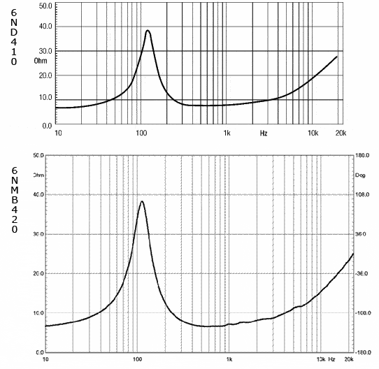

Detective Work
When I worked at Tektronix as a technical writer, graphics mixups were more common than you might think for a 20,000-employee corporation that made a wide range of MIL-SPEC instruments. As the writer responsible for the final manual that shipped with the product, you really had to bird-dog the production people at every stage, otherwise about 1 graphic in 20 would be swapped, causing no end of confusion on the user's part and many costly phone calls and visits by the field office people to remote customer sites. Very embarrassing for the writing team to print the inevitable "change pages" that were inserted into the printed manual.
Even today, with Web and desktop-graphic production, graphic mixups are more common than you might think - you even see it in 4-color mass-circulation scientific magazines. Of course, I'm on the lookout for it, having done my share of writing, editing, and production work. The momentary faltering of the editorial hand is immediately visible to anyone that's done this kind of work. (Yes, I notice typos, and it takes a little self-control to not mark up a book with a blue pencil.)
Reading the specs of the 6ND410 midrange and 6NMB620 midbass closely, it is evident they are closely related - the similar Mms spec gives that away. With the Mms so similar, the difference could come down to little more than a different VC former and a different dust cap (visible from the pictures).
It is unlikely the text describing the "single demodulating ring" and the Le of 0.1mH of the 6NMB420 are both wrong. This kind of thing is usually at least glanced at by the chief engineer and the company president before it goes public, so the chances are good the text is accurate.
We also see no mention of a "demodulating ring" in the 6ND410, a Le of 0.67 mH, and a 2.8 dB higher reference (Theile/Small) efficiency, which is consistent with the pole-pieces coming closer to the VC, thus increasing the flux in the gap. Since the Mms and emissive area are pretty much the same, the only difference in efficiency can come from increased flux in the gap - the result of a shorter voice coil and the absence of a conductive shorting ring.
A driver either has more inductance or it doesn't. The curves are a little hard to read because the real inductance is more complicated than a simple L + R. For precise correction of inductance to 100 kHz or higher, it take a two sets of Zobel filters, not one, and even then the approximation isn't quite exact. (Back in my Audionics days, I impedance-compensated some of our loudspeakers out to 500 kHz, to make a kinder load for unstable transistor amplifiers. This required two sets of Zobel compensators for the tweeter.)
The breakpoint for the published 6ND410 curves is visibly higher than the breakpoint for the 6NMB420, as well as the 20 kHz figure being different, as MBK has astutely noticed. As he also mentioned, the FR curves are correlated as well, with the published 6NMB420 impedance curves showing ripples at the exact same frequencies as the sharp peak at 5.5 kHz in the FR curves. Thus, I think it likely both the FR and impedance curves for the 6ND410 and 6NMB420 were accidently swapped in pre-production.
It also interesting to look closely at the 15MB700 and 15NMB420 twins. Both have 3" diameter voice coils and more significantly, identical Mms of 73 grams and Fs of 42 Hz. This points to the same cone, and probably the same surround, spider, and VC former.
The curves for the two 15" drivers are very similar but - not quite identical. This comes down to differences in the reflections from the basket, magnet structure, VC venting pipe-mode resonances, and very likely, measurements taken at different times with slightly different test protocols.
Yes, fine points, but correlating specs with the physical driver is very important. The specs at best are a very indirect pointer to the complexity of the real-world system. The real values of specs is telling us something about how the driver is made - this, by the way, is why I like to see drivers tested on large flat baffles, so I can see the driver, not the baffle artifacts. The "differences" between the 15MB700 and 15NMB420 could be nothing more than different-sized baffles - indeed, baffle diffraction alone could account for the ripples I complained about in the Supravox CSD measurement.
