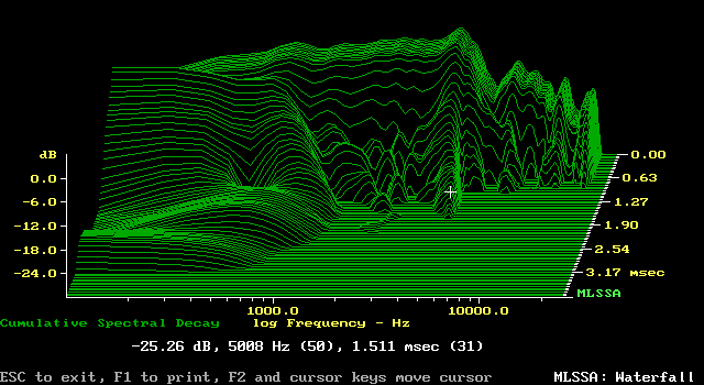

Well, that's what a CSD shows - a mechanically "perfect" driver would just have a narrow wall at the back of the display. Unfortunately, a CSD can be scrambled and rendered unreadable by an unsuppressed floor reflection, but I seem to get usable (not perfect, but good enough for my purposes) results with 20~30 dB of attenuation of the floor bounce.
My web page is a once-over-lightly on what you can expect to see when the impulse response is transformed to a CSD and FR plot. My favorite odd duck is the Eton CSD, shown below. I've never seen this behavior before - the obvious resonance (that long mountain range) is actually frequency-modulated! Remarkable! That shouldn't even be possible, if you stick to lumped-element theory. The real world is always a lot more complicated than our simplistic models - and the deeper you look, with more powerful measurement techniques, the more you find.
The original CSD was D.E.L. Shorter's chopped-sinewave method described in Wireless World in the early Sixties. I wish I had copies of these articles - they were as significant as Theile/Small theory, but were not appreciated in the USA when they came out. (That transatlantic accent, y'know, along with a good dose of NIH in the American speaker industry.) Shorter described what he was looking for as "buried resonance", since these were too narrow and too small to show up on a swept-sinewave display - and they were real, measurable, and clearly audible, not just an academic hand-waving hypothesis. These techniques formed the basis of more than a decade's worth of BBC monitors.
Shorter's method used a slowly swept sinewave generator with an external gate that counted the sinewaves and chopped them on and off with a user-selectable 4, 8, and 16 on-and-off duty cycle, with the provision of extending the "off" interval as long as desired. The scope is then triggered by the on-off signal pulses (a secondary output of the switcher). In practice, the apparatus requires a time-of-flight delay for the switching pulse for the scope trigger. The area of the scope display that is of interest, of course, is the "off" interval. As the sinewave generator is slowly swept across the spectrum, certain frequencies show high-Q, quite narrow resonances that can be only a few tens of Hz wide. With a sparse musical spectra, these are rarely stimulated, but with a dense spectra (like a chorus or an orchestra), they can be quite audible.
I used a system like this at Audionics in 1976 minus the time-of-flight delay, so it was only good for looking at the current going through the voice coil. Even so, I was able to clearly see not one, not two, but three narrow resonances in the KEF B110 in the vicinity of 3.2~3.5 kHz - as I recall, they were around 3.2, 3.3, and 3.4 kHz, and were about 30~50 Hz wide each. These were dustcap resonances, of course, but simply removing the dustcap didn't get rid of them - new ones appeared elsewhere. (You always gotta measure, not just assume!)
Similarly, the KEF B139 bass driver had a humongous resonance at 1.5 khz from the expanded foam diaphragm - and I was aware of no loudspeaker that used a notch filter to remove it. I found that with my first loudspeaker, the Audionics TLM-200, that it required a 3rd-order lowpass filter at 200 Hz to remove the midrange coloration from audibility - 2nd-order was not enough, at least with pink-noise test stimulus. Yes, the filter was expensive, but flip the switch, the coloration would obviously come and go.
Note that all of the measurements I'm speaking of here - CSD and Shorter's chopped-sinewave method - look at what happens when the electrical stimulation is cut off.
No relationship to BL product, cone mass, and rise time at all - these techniques look at the behavior of the mechanical system, which is what we care about most, since the correction techniques are so limited in scope.
Yes, you can use notch filters, but I can say from experience they don't completely remove the original coloration (despite what measurements may say), and there is a subtle residue of what I call "grayness" to the resulting sound. (Instrumental tone colors are subtly diminished after aggressive notch-filter equalization.) The best approach to remove these gremlins is to modify the mechanical system (or do the right thing and select another driver).
What truly surprises me is that design methodologies that became standard practice across the BBC (a world-famous organization that publishes in English!) during the late Sixties never found their way into the US high-efficiency manufacturers - Altec, JBL, Electro-Voice, and University. This seems like a country determinedly clinging to black-and-white TV just because their engineers couldn't do color, or more to the point, the surprising absence of plastic-based AC-biased magnetic-tape recording technology in the English-speaking world before WWII. (Prewar magnetic recording in the USA and UK was limited to steel wire and DC bias, with very low-fi results. Low-noise, hifi recording was limited to first-generation acetate masters.)

measuring 'colorations"
So you seem confident that CSD's allow you to correlate measured imperfections in the response of drivers to audible artifacts with a high level of confidence? Are there circumstances where the perceived quality of a driver may not correlate with it's measured response, and how would you resolve that conflict? And what sort of limits would you impose on a CSD wrt low level disturbances and their audibility?

Well, let's put it this way. I didn't come up with this protocol; the BBC did some forty-plus years ago. I've been to Britain, visited the BBC Research Labs, and heard their most advanced recording and playback systems. To this day that was some of the best sound I've ever heard. So I'm partial to the BBC/Spendor/Quad philosophy, both esthetically and sonically. Other people prefer other schools of design.
I don't think there's anything magical or mystical about speaker design; their "personality", if you will, simply reflects the priorities of that school of the design, the skill and tastes of the designer, and the attention to detail. That's really all there is to it.
Different schools of design sound different; this isn't surprising considering how bad loudspeakers are in objective terms, and designers are forced to trade one set of virtues against others. It's the same as cars: a Porsche 911, a Hummer H1, a Ford F250 with dual rear tires, a Subaru Outback, and a Prius all do different things, and no, you can't combine them into a "supercar."
The claim that any speaker can "do it all" is simply absurd - it usually reflects a young, just-starting-out designer who thinks they are smarter than anyone else in the world. I lost that illusion about thirty years ago - I'm just another worker in the vineyard, tending the grapes, and hoping for a good harvest.
As for sonic correlation, well, you win some, you lose some. I have pretty high confidence in time and CSD data, and I have plenty of company in the industry. But taking just one example, fairly audible diffraction effects don't show up that much in the CSD, yet if you walk around the speaker while playing pink-noise, you can hear the little secondary sources coming from the cabinet edges. And physically radiusing the edges and covering them with felt may measure the same (on the CSD), but they sound quite different in spatial-rendition terms.
Crossover caps are the most annoying of all; the measured differences in DA and DF are really really small, yet the subjective effect can be as large as physically replacing drivers. I have no explanation for that at all. I think JBL's idea of applying 9V DC battery bias to a pair of caps is a good one, though - anything to reduce this annoying coloration.
