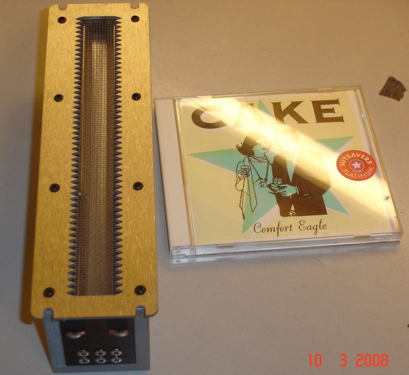

Lynn Olson said:The more adventurous version that I'll finally be building this summer will have an open baffle instead of the traditional big box, and an array of bi-amped bass-fill drivers to complement the OB rolloff. If the OB thing doesn't pan out, I'll revert to the more traditional big box, but I'm hoping I won't have to do that.
I'm still betting on the 210mm x 15mm RAAL ribbon tweeter, crossed to a 10" dipole midrange, crossed to 3-4 dipole 15" dipole bass. A DIY dipole ribbon might even be better.
For my ears, a midrange that can cover ~80-1,400 is needed for vocal magic.
