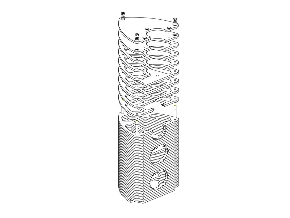

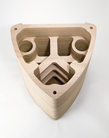

Charles Hansen said:
in my estimation the TADs are overall better than the K2's. But if you didn't like the TADs, I'm not sure you will like the K2's any better.
The TAD 1 plywood ribs screw_rods + glue stack-up showing extensive bracing and box resonance control.
