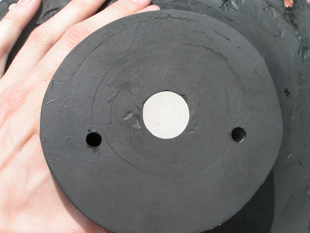

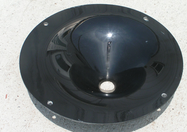

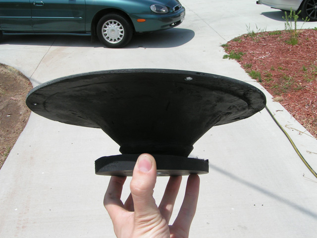

for those interested in the DDS waveguides which have also been mentioned here, we just got a pair today. Unfortunately they are not at all useable.
They are way off center, no way to bolt a compression driver to it even. I'm not sure how they could even send one of these out.
John
John

I'll bet they measure as good as they look
