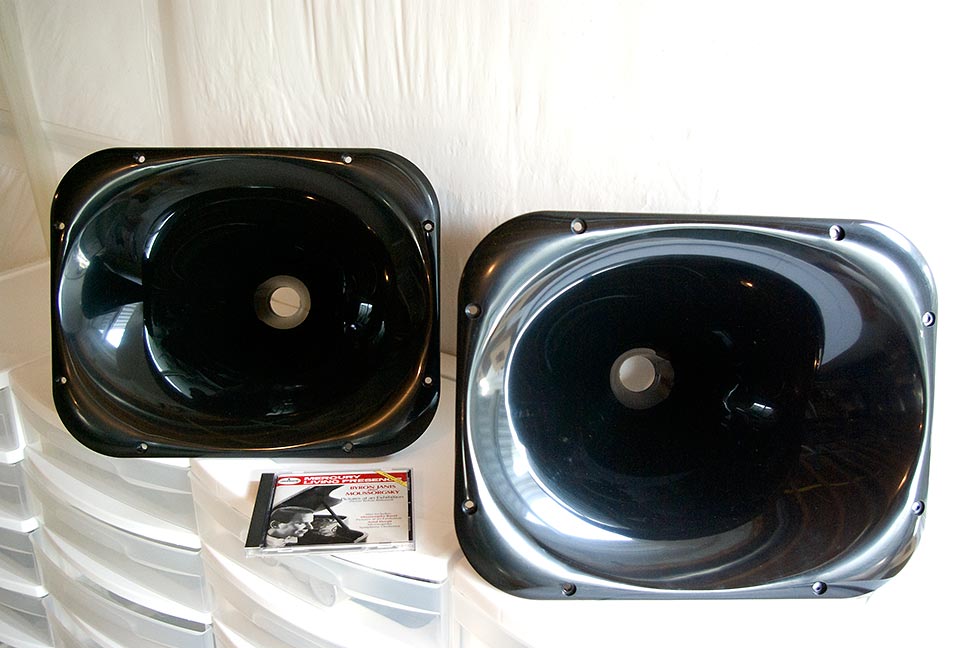

Some Photos
Here's what the front of two XT1464's look like. A curvy shiny black horn is not the easiest thing to photograph - so for the photographers amongst us, the camera was a Pentax K10D, exposure set about 1 and 1/3 stops above the indicated meter reading, light from the window on the right with on-camera flash assist (mixed lighting), and a little bit of curve-bending in Photoshop to bring out the shadows.
The CD shown for scale is one of my favorites, the Mercury Living Presence recording of "Pictures at an Exhibition", with Antal Dorati conducting the Minneapolis Symphony Orchestra. The catalog number is Philips #434 346-2.
This recording is nearly unplayable on most high-end systems, but if the system is really on-song, the sheer beauty and energy of the performance is overwhelming. (The folks at the Audio Kinesis room at the last RMAF show will probably remember when I put this one on.)
On most high-end systems, the tremendous amount of HF energy will slew the electronics and overload the tweeters - it'll sound like a sawmill starting up in the morning thanks to all the distortion - which is NOT on the recording. If the system has very fast electronics and low-distortion tweeters with a well-designed crossover, you''ll be treated to a 10th-row in-the-hall experience - with an edge-of-the-seat performance by the Minneapolis Symphony.
When you play with them, get them optimized, and then decide that it isn't what you are looking for:
Then try them as a dipole (i.e. two drivers w/horns back to back and out of phase), and repeat the process. That might get you to where you want to go.
