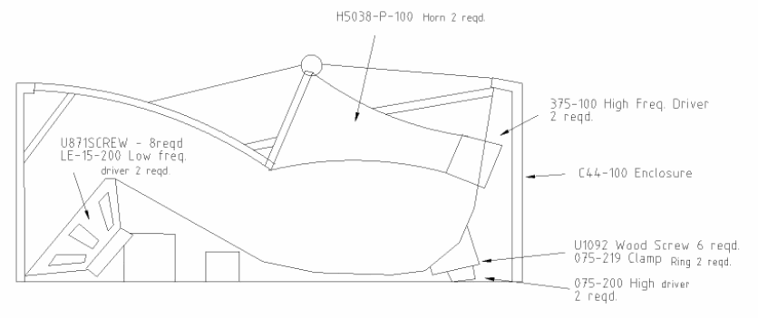

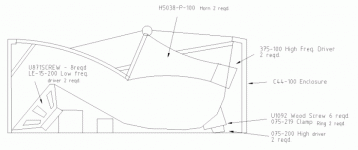

Just thinking out loud here:
What is the possibility of a modern interpretation of JBL Paragon?
JBL Paragon is essentially a 3 way speaker, with a tweeter, a mid horn, and a bass horn, for each channel. By placing the tweeter and mid horn in front of the opening of the bass horn, Paragon supposely achieves a single point source. Maybe a RAAL and an Azurahorn in front of a giant bass horn.
Catalog:
http://www.lansingheritage.org/images/jbl/catalogs/1967/ranger.jpg
Color pictures:
http://cgi.ebay.com/JBL-Paragon-D44...ryZ50597QQssPageNameZWDVWQQrdZ1QQcmdZViewItem
Construction Plan:
http://www.paragondrawings.de/plans/index.html

badman said:Except that then you have time alignment issues unless you take some pretty dramatic measures to avoid them.
Agreed. Para eq will be used, and time delay may be required. I found a thread with actual users/owners talking about its pro and cons.
http://www.audioheritage.org/vbulletin/showthread.php?t=7528
I just think Lynn's new speaker should be pretty enough to be displayed in a museum.

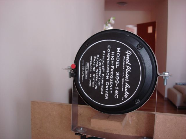

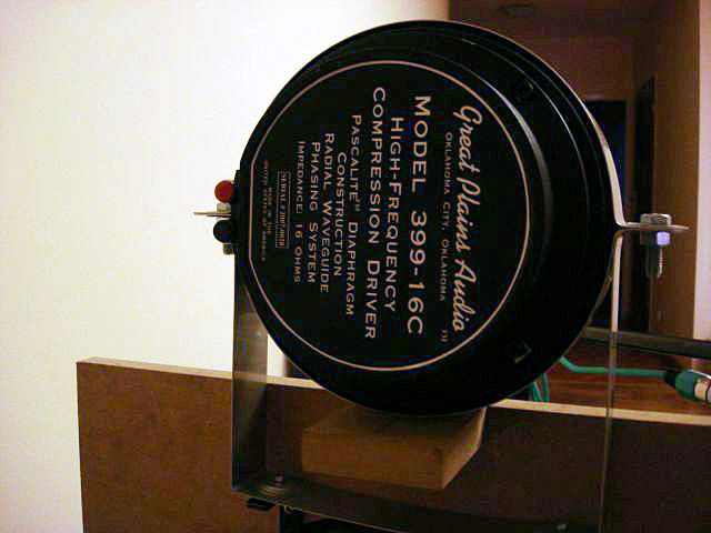

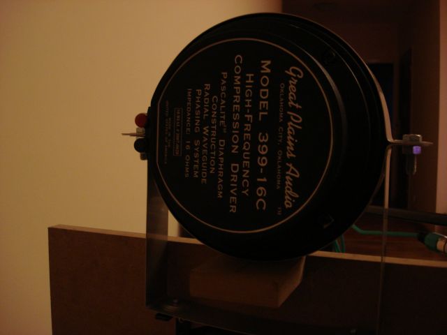

Lynn Olson said:Little bit of Photoshop ...
For 99% of Photoshopping you don't have to pay Adobe.
colour, contrast, brightness correction
cropping
size alignment
format conversion
and a lot more if you are more advanced
All provided by the not so well known, fast, small and FREE Irfanview
http://www.irfanview.de/
Lynn to improve colour noise, force your camera to low ISO settings and use a fast lens or a tripod. Its hard to get rid of by "postproduction".

caninus80 said:My friend has pentax k10d and he recommend it to me...
Uuupps, sorry,
artefacts were from compression (at heavily cranked up contrast) not noise from the camera sensor at low light condition.
No need for a tripod here - just correct exposure by one stop or so or force the flash to get slightly more light (second take was perfect right away, no?).

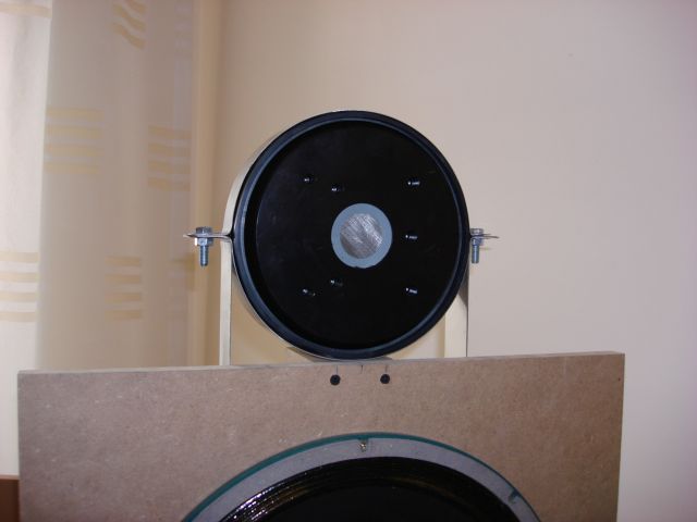

Hi Caninus80!
One experiment you might want to try in the future is placing the diaphragm of the 399 a few inches behind the dustcap of the midbass driver - I'd start with 4~6 inches based on my fooling around with time-aligning a Klipsch Chorus, which combines a 15" midbass with a mid and HF horn. (See results here.) It was the relative simplicity of the brief experiments with the Klipsch that gave me the confidence to even try horns in the first place.
The horns in the Klipsch Chorus are pretty low-end PA drivers, so there's every reason to expect decent professional-grade drivers (which the GPA399 certainly is) to give a better result. It was very common during the Fifties for hifi enthusiasts to upgrade their Klipschorns with Altec drivers and horns - the fact that Paul Klipsch himself routinely swapped one PA driver for another during the production run of the Klipschorn shows he had no real attachment to this or that CD+horn combination.

agent.5 said:Just thinking out loud here:
Well, I hate to throw cold water on this and antagonize the JBL fans, but the Ranger-Paragon was one of the biggest disappointments I've ever had in audio. They are absolutely stunning-looking loudspeakers "in person", far more beautiful than the pictures suggest. Most definitely Museum of Modern Art-worthy - the only word I can use is "icon", like an iPod or iPhone.
Unfortunately the magic ends when the music starts. When I heard them back in 1963 or thereabouts, they were the shrillest, honkiest, and harshest-sounding speakers I had ever heard. Granted, I was used to the sound of Quad ESL57's, Tannoys, Celestions, and AR-2's, and was a classical music fan long before I got into the Beatles, but the disparity between the beautiful looks and ugly sound just floored me. By comparison, an Altec 604 Duplex is a model of refinement.
To some extent that experience soured me on JBL - I felt it wasn't ethical for a big, famous company to make a speaker that was "all show and no go". A "show" car can at least be driven slowly and impress the neighbors. But a harsh, shrill loudspeaker will always sound that way. A few years later, the L100 and L200 only deepened the impression that the shrillness and harshness was no accident, but a deliberate corporate "sound" that was there for marketing reasons.
Imaging? None. The theory of the curved panel doesn't work - it just creates a zillion reflections, a very hollow-sounding midrange, and scrambles the stereo even more. The Ranger-Paragon is an object example in the sound of early reflections combined with large, resonant structures that are close to the drivers.
Well, now that's I've knocked one of the most iconic (so to speak) speakers ever made, I'm not expecting any love letters from JBL fans. But I heard what I heard, way back then, and it really sounded pretty awful. In terms of a huge gulf between ambitious advertising claims and the acoustic results, the Ranger-Paragon is right up there with the Karlson.
