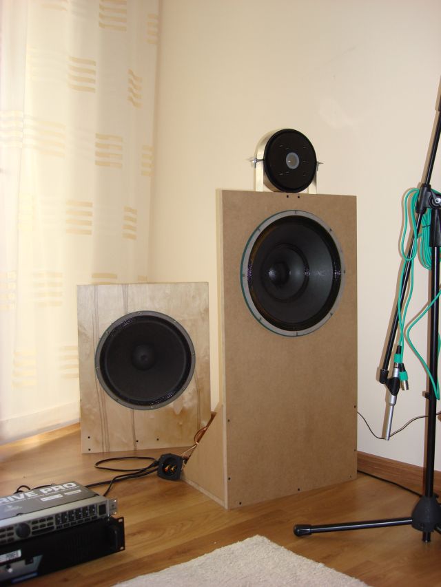

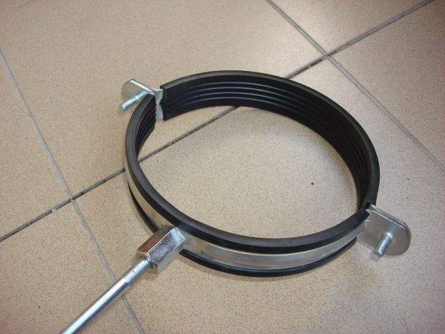

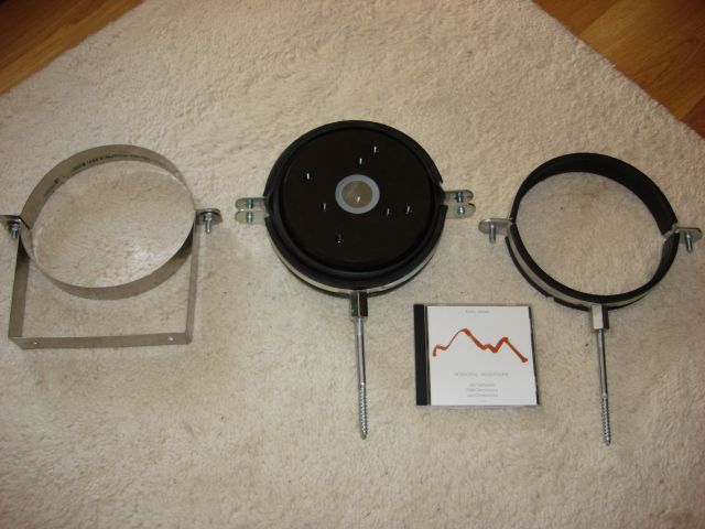

Lynn Olson said:Hi Caninus80!
One experiment you might want to try in the future is placing the diaphragm of the 399 a few inches behind the dustcap of the midbass driver - I'd start with 4~6 inches based on my fooling around with time-aligning a Klipsch Chorus, which combines a 15" midbass with a mid and HF horn. (See results here.) It was the relative simplicity of the brief experiments with the Klipsch that gave me the confidence to even try horns in the first place.
Lynn,
Of course I will try with placing 399. This CD is my first one, so now I will make some experiments with mounting... What You see on the photo is set-up only to make measurements (today I got my first measurement
system- behringer mc8000 mic, behringer 802 pre and m-audio transit)
So I will have fun![]()

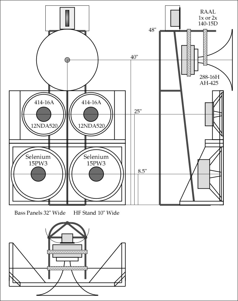

It's not a Paragon - or a Parthenon
The purpose of this first go-round is a prototype that can allow different variations of the design. Neither a Paragon nor a Parthenon, it's just something to try out a few concepts in the real world.
The HF driver is suspended from bungee cords, canvas, or fabric mesh, and is adjustable front-to-back, since the time alignment is a function of the crossover, and to a lesser degree, listening distance. This drawing shows the approximate spacing I expect to see between the compression driver and the midbass, based on previous experience with the Klipsch Chorus, which had similar crossover points and a 15" midbass driver and midrange horn.
The upper and lower bass panels are separate, and I plan to try a single 12" midbass driver, two of them as shown here, and a single 15" midbass driver. I'll be trying the Gary Pimm approach to quasi-cardioid, with the Bonded Logic recycled blue jeans damping material that Gary Pimm uses so successfully in his speakers.
As mentioned earlier, the pair of 15" Selenium drivers have their own equalization and power amplifier.
I'll be contacting local Denver-area woodworkers fairly soon - any comments on what you see here? The HF frame will be made from steel or aluminum tubing, and idea is for a rigid frame that has low surface-emission area. Since the compression driver, horn, and ribbon tweeter weigh about 40 lbs all together, and are 48 inches off the floor, I want the HF frame to be stable.

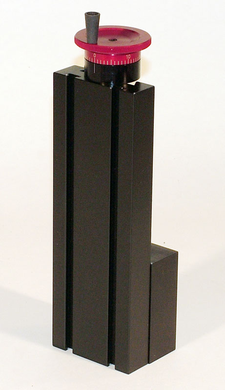

I think it may be a good idea to provide micro distance adjustments for both RAAL and the mid horns, to facilitate time alignment. Maybe, we can use something like this:
http://www.sherlineipd.com/manslide.htm
