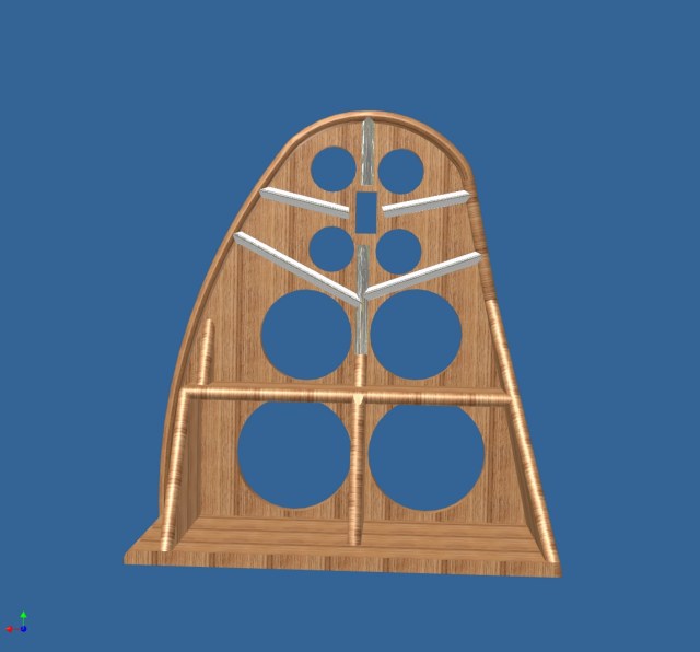

Lynn Olson said:... any comments on what you see here?
Lynn, to avoid horizontal lobing keep mid-woofer LP at around 500Hz
CONS
- a small format compressor driver wount like that - and
- its quite contradicitonal to the RAAL pattern
Greetings
Michael

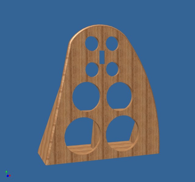

I was kind of board today so I whipped up a couple of big OB cabinet concept 3D models using four cone drivers for the 500-2500 or 500-4000 Hz range.
This is mostly for fun and for ideas. And to see what kind of shapes can be gotten away with for some large baffle OB speaker. The only criterion I had is that the baffle is no more than 48 inches wide and can be cut from a single sheet of standard size MDF or plywood.
