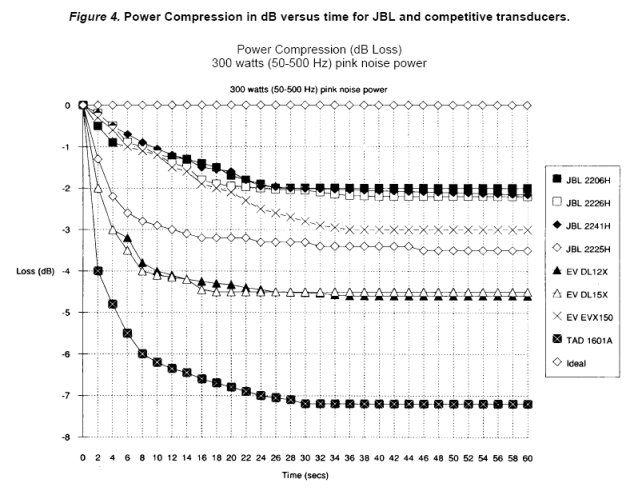

Why not do something like this. If JBL can publish this information about their competitors?? It's a simple test in principle, 300 watts of Pink Noise from 50-500 with SPL measured at time intervals. Total time 60 seconds, wouldn't want to be anywhere nearby when they were running that one;)
Rob:)
Rob:)
Excelent starter – thanks, Rob.
What we don't see in the diagram is
- how fast do the speakers recover
- to what extend its cooling mechanism is program (= membrane excursion) dependant
300W for 60 sec is 18 times the energy injection I propose. It might be a good test if you want to compare reliability rather than sound quality – and having some fun burning down a competitors VC.
For many interesting speakers its way too much - limiting this procedure significantly in usability not to speak that you hardly can do that somewhere at home.
Greetings
Michael
Regarding power compression, I too think that it is an important aspect of a loudspeaker system, but I am not sure that the JBL test gets at all of the problems.
I also think that some "common" if not standard method is needed for comparison purposes.
I used pink noise and plotted the spectrum as a function of time which showed how the individual drivers and the crossover was compressing and how the frequency response changing. This test showed signifcant differences in systems since it shows far more than simply plotting the dB Loss over time. Power compression is at least as important for the HF device as it is for the LF one and the JBL test completely ignores this.
Personally, I'd steer clear of a stated power levels and worry about a stated SPL levels. Its the SPL that we care about not how much power the system can handle. Power ratings are mostly for pro apps where driver burn out is an issue. For us this is not the issue, but audible FR changes at useful (but high) SPL levels is.
