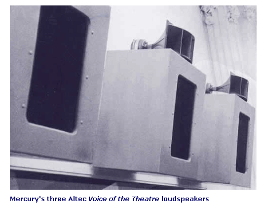

Sometimes I wonder how such people as the Mercury team could produce recordings of enduring quality on monitors of their era.
I guess that they knew so well how it would go to the disks because they could replay it in their heads and subtract the equipment colorations mentally. The huge involvement with live music in halls must have been their compass.
