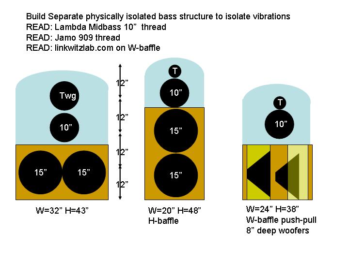

rljones said:can you describe the problems you see in using 15" woofers, one on the side, as compared to two vertical or two horizontal on the front OB?
Thanks, Robert
Hi Robert,
I think these are the most common baffle options. Putting two woofers horizontally near the floor gives the most bass, but a 32" wide cabinet is difficult to make sexy. Vertically stacking two 15" woofers in a 19-24" wide baffle can be sexy...see the Jamo R909 thread and show the glamor picture to your wife...but with naturally less bass than two horizontal near the floor.
I used the Edge simulator to model side-by-side and 2-vertical stacked 15" woofers in this thread. I also used Xlbaffle simulation models in Magnetar's OB thread for the midbass baffle placement.

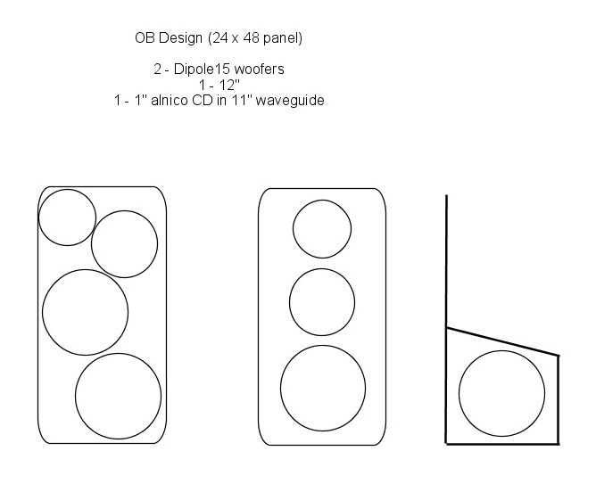

Thanks for suggestions; I looked them over.
The tweeter I'm using is a 1" alnico CD in almost an 11" diameter waveguide (later maybe a horn). Together with a 12" mid, the only way to get these two drivers plus the 15" woofers on one 24x48 panel (or better for my house, a 20x48), is to put one 15" on a side wing. The Dipole15 driver is closer to 16" effective diameter (and it's not the same driver as the IB15: http://web.archive.org/web/20040307231755/lambdacoustics.com/drivers/DIPOLE15.html ).
I tried to make a scale drawing with the baffle equivalent to 24x48. The oblique packing won't work (and looks strange too). The drivers require close to 44" vertical spread with spacing: 16" + 12.5" + 11". Fortunately, with a 2" margin about woofers on their respective panels, the magnet structures of the 15" woofers should clear, meaning the side wing can work without being overly large.
But anyway, how bad is a 15" woofer on a side wing compared to an all vertical presentation? And what is maximum frequency of x/o for this configuration to avoid problems (200 Hz)?
Thanks, Robert

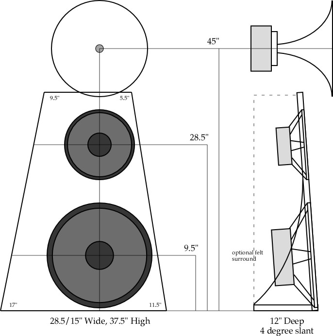

Current Thoughts
I've been a little busy lately, but here is the system configuration that is going to be evaluated:
Supertweeter: RAAL 140-15D
Alternates: Ionovac
Ionovac.com
Roger Russel
HF Crossover: passive 1st-order 5~7 kHz, with slope for supertweeter increasing below 2 kHz.
Mid-High: Great Plains Audio 288-16H Alnico with aluminum diaphragm, tangential surround, and no bugscreen
Alternates: Yamaha JA6681, Vitavox S2, JBL 435Be or 2435 w/Aquaplas treatment
Horn/Waveguide: Azura AH-425
Alternates: custom OS, custom conical with Quadratic Throat transition or similar, Tractrix
Mid Crossover: passive 2nd/3rd order 700~900 Hz (measured acoustic slopes, not electrical). This will take the longest time to design, with extensive MLSSA and ARTA measurements in the time domain, frequency domain, CSD, on and off-axis. One thing that helps is that mid-high and midbass have similar overall diameters, and 2-way professional monitors have used crossovers in this region going back to the Lansing Iconic.
Midbass:
12" - Great Plains Audio 414 Alnico, 18Sound 12NDA520 Neodymium
15" - Lambda TD15M (future Alnico or field-coil version), Great Plains Audio 416 Alnico
Bass-Fill Crossover: active, parametric equalization, 160~320 Hz lowpass, with separate amplification. The bass-fill drivers will be highpassed around 50 Hz to control excursion and hand-off to monopole subwoofers.
Bass-Fill: 18" Beyma SM118NA, Beyma 118Nd/W, JBL 2242, future Lambda 18" driver
The simple open baffle will be tried with no damping on the rear (dipole) as well as a semicylindrical curved felt blanket that wraps around the rear, with a modest amount of recycled cotton filling directly behind the 18" driver (quasi-cardioid). The main purpose of the adjustable parametric equalization is to compensate for the differing efficiency and bass rolloffs of the two different OB setups, as well as proximity effects from nearby room boundaries.
I will not be trying the "alternates" - they are offered as suggestions for people who already have these drivers, not as an eBay buying guide (stay away, stay away!).
The first drawing shows the 12+18 combination, the second the 15+18 combination. Both share a screw or bolt-in interchangeable side wall and baseplate assembly. (The dimensions are relative to the faceplate of the front baffle.)

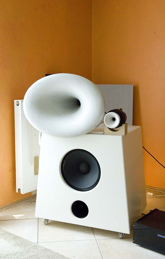

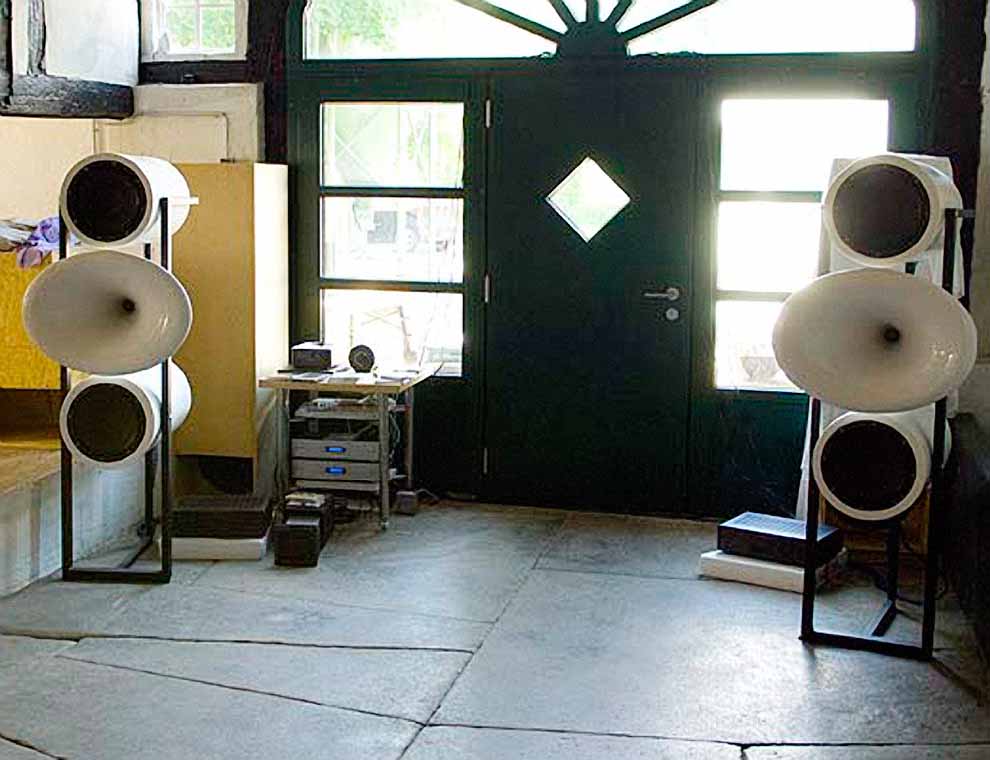

Esthetics
Found these pictures over at the Audio Voice Acoustics site. A simple semi-gloss white finish would look nice on the open baffle, and would complement the color of the Azurahorn. I'll be asking my neighbor Thom Mackris over at Galibier Design for Denver-area wood and metal craftsmen that do high-quality work.

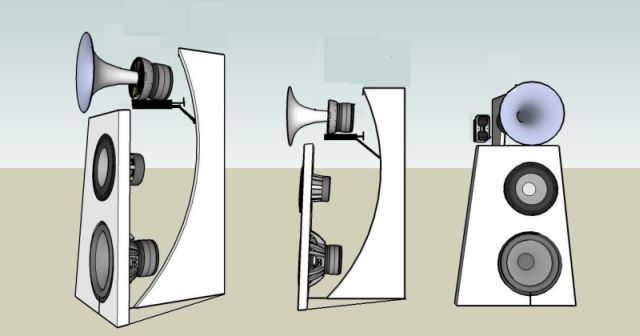

HF Mounting Frame
Also found this picture over at the Audio Voice Acoustics site, with an excellent idea for a simple metal frame to mount the mid/high horn and ribbon supertweeter. (A C-shaped section in the middle for the mid/high horn and the top of the platform for the supertweeter.)

Re: HF Mounting Frame
The easiest metal framing is to use 80/20 aluminum extrustions, assuming you want simple shape and not fancy design and curves.
Prices are good at their Ebay store.
http://stores.ebay.com/8020-Inc-Gar..._W0QQcolZ4QQdirZ1QQfsubZ6482273QQftidZ2QQtZkm
