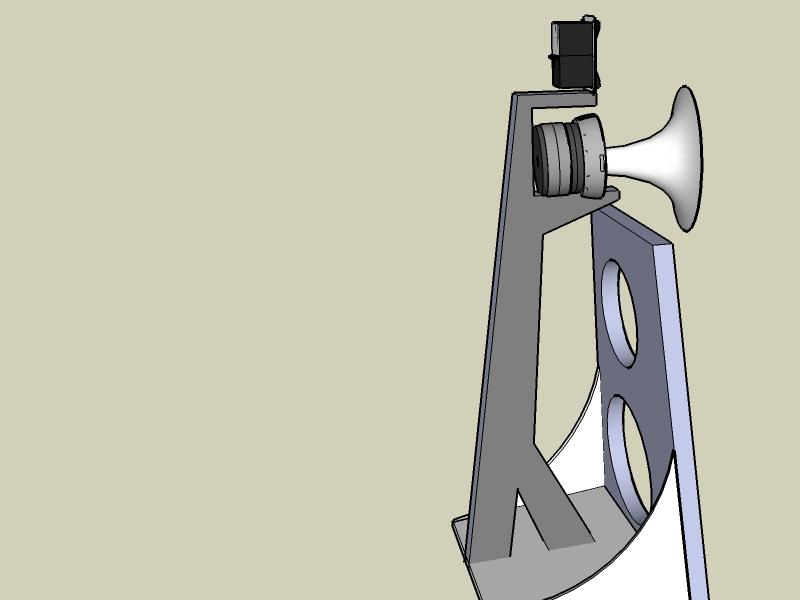

The tweeter I'm using is a 1" alnico CD in almost an 11" diameter waveguide (later maybe a horn). Together with a 12" mid, the only way to get these two drivers plus the 15" woofers on one 24x48 panel (or better for my house, a 20x48), is to put one 15" on a side wing. Thanks, Robert

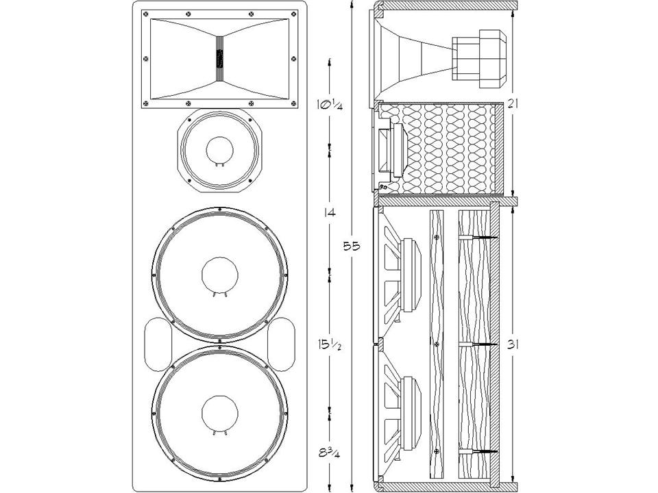

"Back in the Day" Drew Daniels from Altec + Disney would just stack-em-up into a 55" cabinet and stick these columns behind the main screen. You might get away with this today if you have a big wall mounted LCD and used some sexy water colored silk fabric as the grill cloth. I would build this first to experience the best sound possible from the drivers.
John Kreskovsky's "ICTA" WMTMW dipole might look like an art object with some graphic silk grill cloth. Think Plus-Size hi-fashion models. With black grill cloth it becomes the 2001 Monolith. I'm crusing the Tang Bang W6-1721 midrange at Parts Express plus Lambda 15-Dipoles for an ICTA clone.
The W baffle would have resonance issues at your 200Hz Xover frequency and would need some Xover notch filter work to sound right, plus it would be a waste of the Lambda 15-Dipoles BW and superior sound. The push-pull cone mass cancelation is really nice. Lambda is considering a new 10" midbass that could be crossed lower like 80Hz to where a W baffle with the cheaper Lambda 15IB would work well.
I've never gotten good results with a side mounted woofer crossed over 60Hz.
Drew Daniels
http://www.audioheritage.org/html/perspectives/drews-clues/system.htm

P.S. I have reservations about any kind of W-baffle, since they require sharp-cut lowpass filters to avoid box colorations. I'm not all that interested in the polar patterns of dipoles or quasi-cardioids, but am more interested in freedom from box coloration (which cannot be removed by equalization). W-baffles seem like a step backward - the inherent problems with LF rolloff and limited power-handling of dipoles, combined with the resonances of monopole box enclosures. The 200~800 Hz region is especially important in reducing or eliminating box colorations, since the drivers themselves are still in the piston band and have fairly low coloration.
What seems more interesting is a few dB of lossy attenuation for the rear wave, but no additional delay, resonance, or standing waves. That's the purpose of the C-shaped wrap of felt around the rear.
