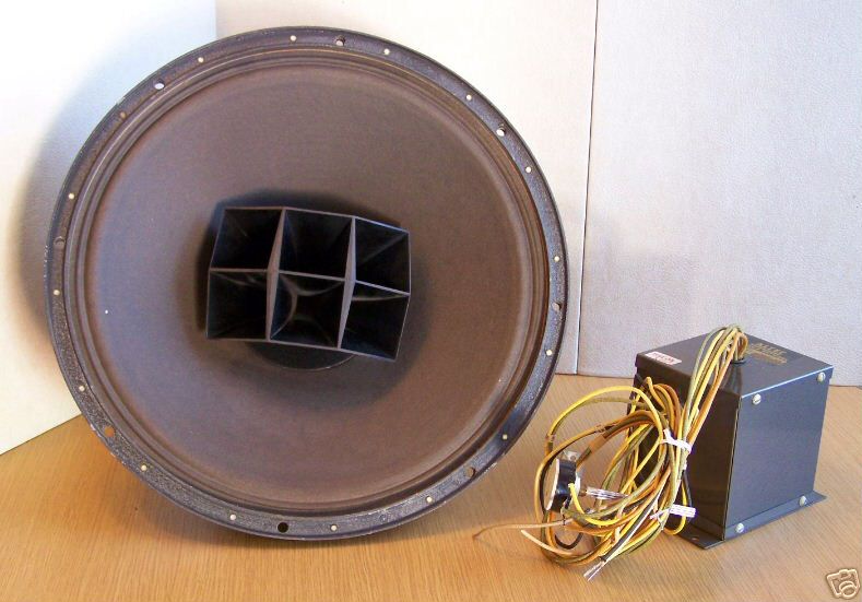

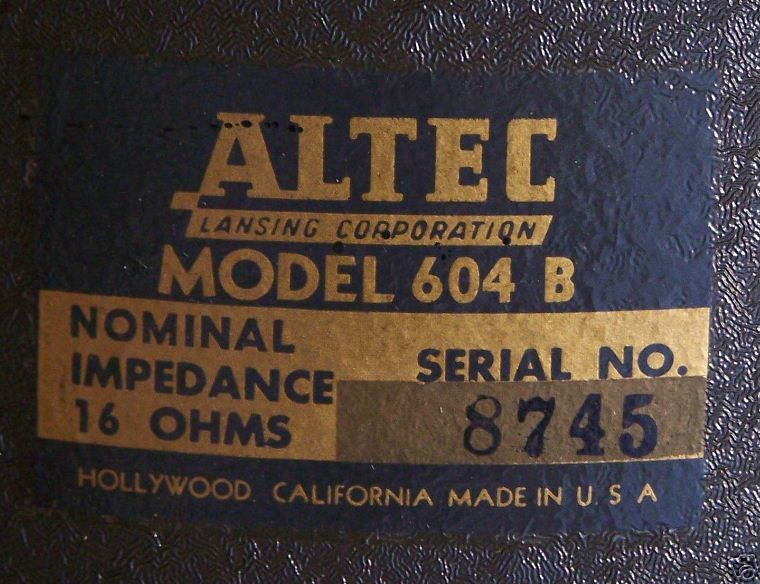

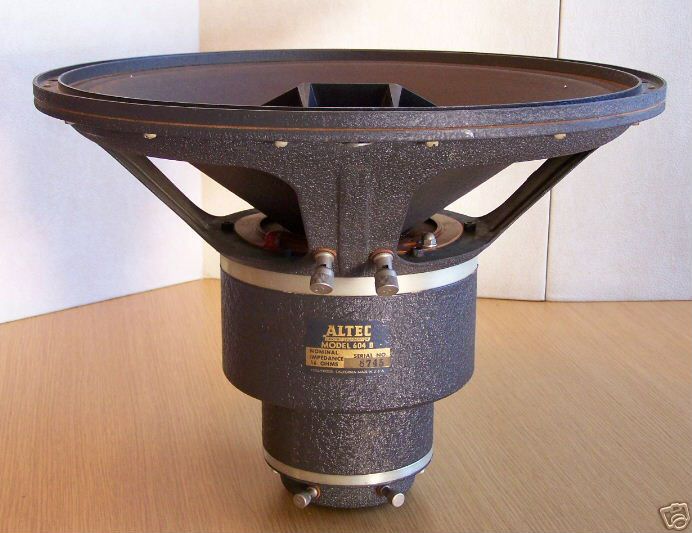

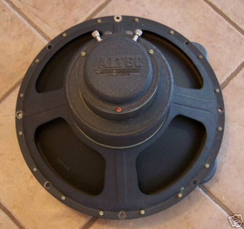

Years ago, when I was just a kid, I had an Altec duplex in my hifi system. It was a 604b, a late 1940's model--with alnico and multicellular horn. Back then I knew nothing about alnico, or about compression drivers; I only knew that my Altec looked cooler and sounded better than anything else I had come across.
So it's interesting to see Hiraga's beautiful system using a horn that looks identical to the Altec 604b horn, which had six cells. Mmmm....I wonder if a 604 with multicellular horn (and alnico!) can be ordered from GPA! And I wonder why Altec dropped the multicellular horn...to cut costs?
Here's a photo of a mint 604b that sold last year.

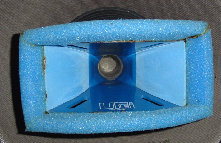

The new 604-8h-III uses a UREI style horn. There are pics of it over at Audio Asylum and at the Altec hostboard site.
I have a pair on order, but don't have anything to show for it yet. I was inspired by the sound of the Shindo Latour when I heard it at Pitch Perfect.
Chris
"The new 604-8h-III uses a UREI style horn."
Which version?? There were several. The original was no foamed edges. Then it went to edges and dots then slots then slots edges and sides.
Here's a C version horn.
