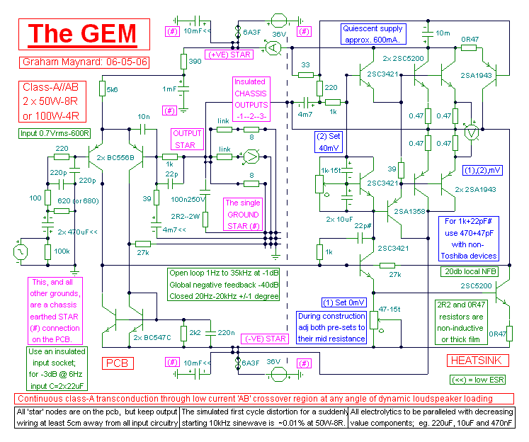

Hi Lynn,
Maybe the tube filaments should have a degree of current control as in receivers where stability and purity of local oscillators were controlled by barretors. Same could apply to maintaining optimum operating conditions for amplifier tubes.
I built an electronic 'barretor' 25 years ago when these iron filament devices started to become very expensive, and this should still be easy to do. The filament warms more slowly too, so should have extend tube life with fewer strained hot spots.
I worked for longer than I dare say attempting to get sliding bias to work. The bias shifts unequally for first and second half cycles and thus there is always on-going dynamic error.
Quad’s current dumper uses class-A to overcome SS biasing irregularities, and is good, but it does not satisfy your HF bandwidth requirement.
This was why I developed the GEM where the class-A acts at RF speed to control output linearity through power crossovers which would not otherwise be smooth. One version attached.
This amplifier must be constructed as per the wiring diagram and as if an RF amplifier. Not using ‘conventional’ single board and single ‘-‘ve rail tracks. More details here.
http://www.gmweb2.net/Documentation/GEM document authored by Graham Stephen Maynard.htm
Only after finishing this amplifier could I be sure of where I was going with LS constructions.
Cheers ........ Graham.

Wouldn't call myself a specialist on amp design though have quite some experience in valve and solid state amps as well as having done a lot of investigation in PSU stabilisation
To me the sonic difference between true class A and A/B does not come from crossover distortion at the first point.
This was also discussed – and measured - in some detail at Earl's thread "Geddes on distortion measurements"
http://www.diyaudio.com/forums/showthread.php?postid=1330458#post1330458
http://www.diyaudio.com/forums/showthread.php?postid=1336279#post1336279
where I was able to show that crossover distortion disappears in the noise – 50 / 60Hz PSU clutter mainly for usual amp designs .
The main sonic difference between true class A and class A/B IMO is exactly what costs money – the waste of energy to keep silicon in a small temperature range during operation and as far as possible away from thermal transients.

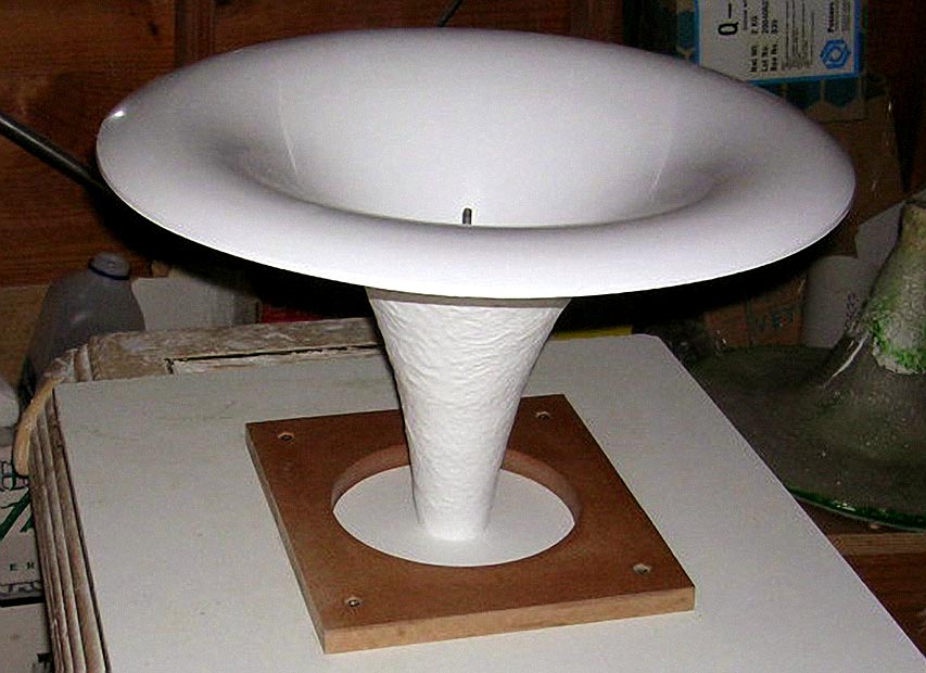

Progress Report from Oz
Here's a picture of the first AH-425 awaiting the cast flange, which will have 7 mounting holes - an inner 3 (3.25" bolt circle diameter) for Altec/GPA 288, 290 and 299 drivers, and an outer 4 (4.0"/102mm bolt circle diameter) for drivers like the Radian 745P, 18Sound 1460A, and BMS 4594ND. (All of these are large-format compression drivers with 1.4" exits.)

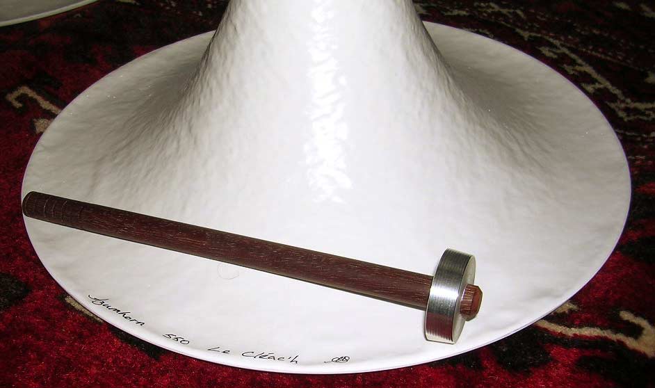

Alignment Tool
I requested that Martin make an "alignment tool", so the centering of the horn on the driver wouldn't be dependent on the precision of the mounting holes on the flange. Here's what he came up with - this allows the driver and horn to be test-fitted to each other (note the flare that matches the throat of the horn and the exit of the compression driver), and when exactly centered, the mounting bolts can be tightened down, and the alignment tool removed.
If the tool gets stuck, the bolts can be loosened, the mounting holes in the cast flange can widened just slightly, and the assembly can be re-mounted again so the alignment tool slides out easily. If the tool is tipped to one side or the other when the bolts are tightened, that tells which mounting holes should be opened up so the compression driver and horn can be exactly centered when the bolts are tightened.
The whole centering process will have to be done a bit gently, since you don't want the hard surface of the tool to deform the softer fiberglass of the horn - I'd rather test-fit the mounting several times to make sure the alignment is exact as possible, then tighten the bolts once it all lines up.

Why not just put the horn/driver assembly upside down?
I mean, driver at the bottom, horn mouth face upward. So you may adjust the alignment by just looking at the throat.
