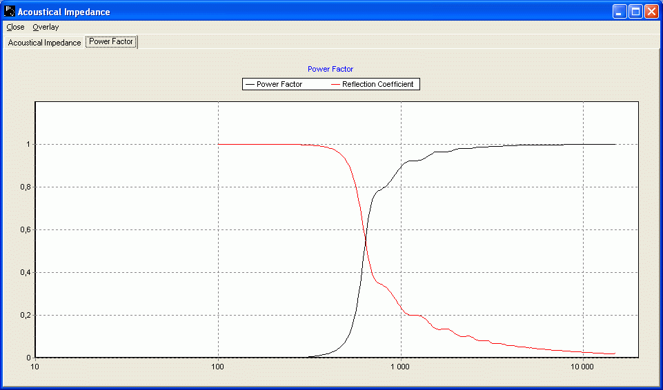

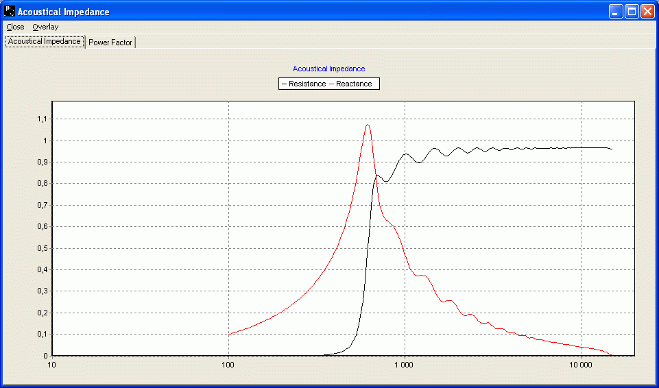

AH-550 Throat Impedance
The black line is the resistive term, the red line is the reactive term. The flat portion of the black line represents the region where the diaphragm of the driver is in constant-velocity mode (direct-radiators primarily operate in a constant-acceleration mode).
To expand on this point, constant-velocity drivers increase the diaphragm excursion at a rate of 6 dB/octave as the frequency is decreased, while constant-velocity drivers increase their excursion at a rate of 12 dB/octave as the frequency is decreased.
One of the most important functions of a crossover, aside from driver integration and equalization, is control of excursion. Many designers forget that direct-radiator tweeters operate in constant-acceleration mode, thus excursion continues to increase below the crossover point if a 6 dB/octave highpass filter is chosen. The tweeter is in the awkward situation where excursion continues to increase at a 6 dB/octave rate in the region between the crossover point and the Fs of the tweeter - excursion only decreases below Fs. Although the acoustic output of the tweeter is decreasing in the two-octave band between Fs and the crossover, the excursion is unfortunately increasing. (This is why I've always avoided 6 dB/octave crossovers, and prefer Gaussian or Bessel highpass filters of moderately higher order, typically 12 dB/octave.)
This unwanted increase in excursion is the source of an annoying intermittent distortion in many high-end loudspeakers with minimalist or linear-phase crossovers, since the tweeter excursion is excessive in the very critical 500 Hz to 2~3 kHz region. The problem is especially troublesome because orchestral music has the maximum spectral energy centered around 500 Hz, the same as the Fs of many tweeters.
Similarly, with a horn speaker crossover, the excursion curve has to be kept in mind - the excursion of the diaphragm increases many times once resistive horn loading is lost, which is why I'm seriously considering a notch filter tuned to the Fs of the compression driver - not so much as to twiddle with the response curve, but to keep unwanted out-of-band excursion to a mininum.

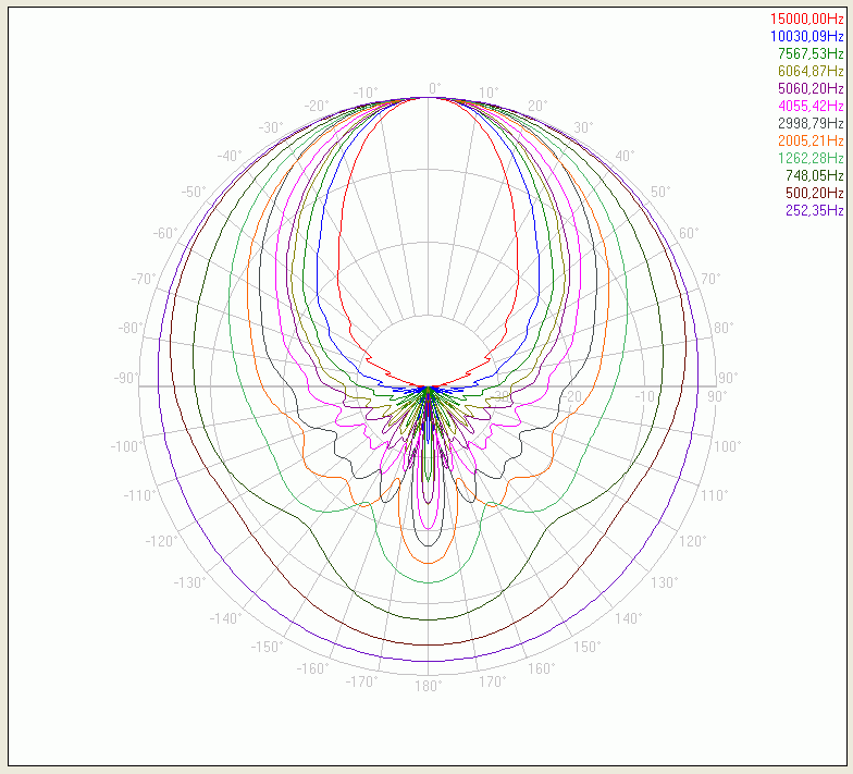

Lynn Olson said:
Run time for the AH-550 was 28 hours, simulated 100 Hz to 15 kHz in 250 steps. Here's the polar diagram:
Just a guesstimate, but looking at the dispersion pattern I'd say a highpass some where between 748 and 1262 (..the steeper the slope the lower the freq.).
Allow for a "rising response" on-axis (0 degree) and a targeted flat response to between 5000 and 6000 off-axis for the "listener's axis". Lowpass crossover between 5000 and 9000.
To expand on the point of the AH-550 post, many, if not most, modern high-end speakers suffer from poor excursion control of the tweeter - thanks to 6 dB/octave crossovers, or crossovers that are simply too low (so the polar pattern looks prettier) - combined with largely unfiltered upper-mid breakup from a rigid-diaphragm midrange or midbass driver. The result is harsh, grainy, and rough sound in the most critical part of the spectrum - 500 Hz to 5 kHz, something even a Sears Silvertone 5-tube AM table radio would get right.
This seems to be an almost generic problem - many of the rooms at the last RMAF had speakers with this obvious and rather gross combination of design defects. If you see me striding right past a room, speeding up as I go, that's why. These were problems I avoided in my first design back in 1975, so I'm not terribly sympathetic to seeing it become even more widespread a third of century later. This is why I grouse about "loss of knowledge" in the hifi biz.

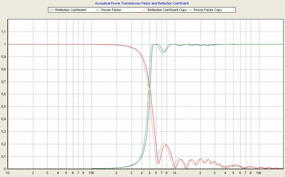

Kolbrek said:
Using BEM I have fund that extending the LeCléac'h contour to 270 degrees removes practially all the ripple in the throat impedance seen in the plots for the AH-160 and AH550.
Bjørn
Bjorn
I would concur with this as it is also what I have found through experience. What the "enclosure" does beyond 90 degrees can be very important to the resulting performance - even more so in the far field than on the impedance (which I generally don't care about). I can attest to the fact that an enclosure for the waveguide is far better than NOT having one and that the larger the face of this enclosure the better the performance. This should not surprise anyone. But since the face and the enclosure does have to be limited in size, it must have rounded edges as this too is a strong benefit. I really don't understand, from an acoustical point of view, why people do not enclose the waveguide. This is not a good thing for performance. But of course, if the appearance of the waveguide is a major attribute then "showing it" is probably desirable, but I would take sound quality over apperances any day - but maybe that's just me.
