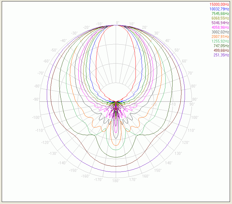

Well, here's the polar plot for AH-425.
Bjørn

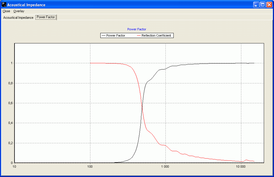

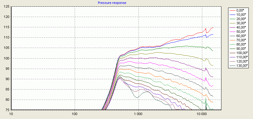

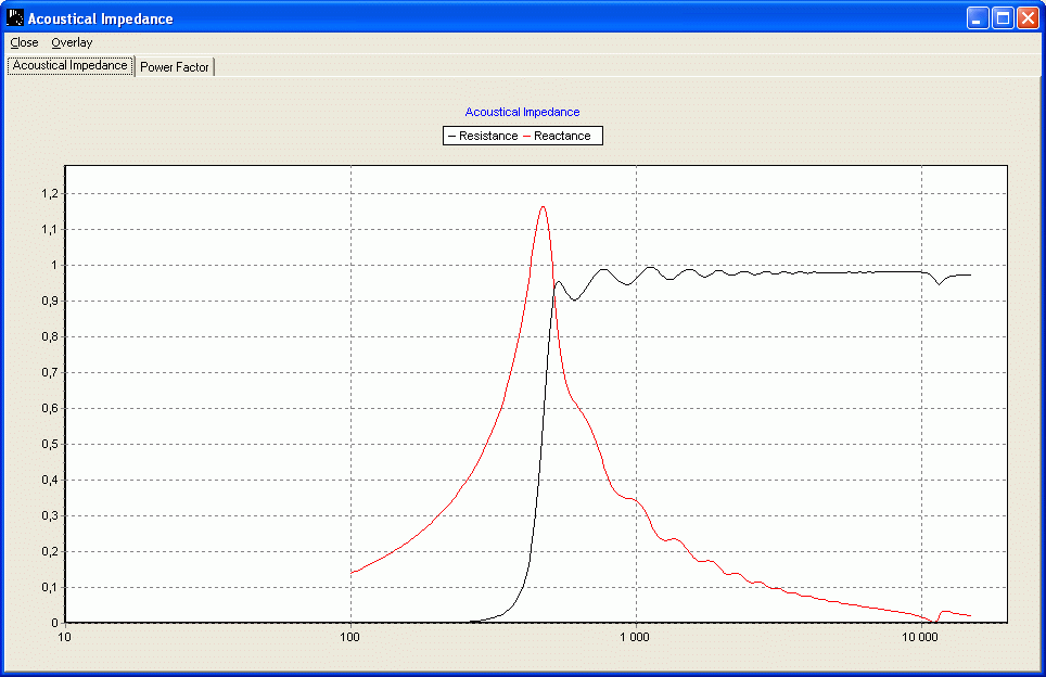

Finally, here are the frequency response curves without driver for the AH-425. This is the SPL at a 3m distance from the horn mouth, at different angles, for a constant volume velocity of 1m/s at the throat. The SPL response will of course be different when a driver is used, and not a constant velocity source, but the relative levels will be the same.
There will however be some differences due to differences in the velocity distribution at the throat, but this simulation does at least give you a general idea of how the horn performs. In the simulation a plane wavefront at the throat, with uniform velocity distribution, is assumed.
Bjørn

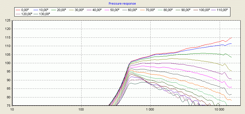

Recently I have also been able to simulate horns in BEM as thin shells, which is more like how the Azurahorns are made. The difference in throat impedance is small, the shell has slighly more ripple.
But there are larger differences in the frequency response curves, they are not quite as smooth as the simulations where the horn has been enclosed in a cylinder.
Attached is the frequency respone plots for constant throat velocity (no driver), 3m distance, for the shell version of the AH-425.
Bjørn
