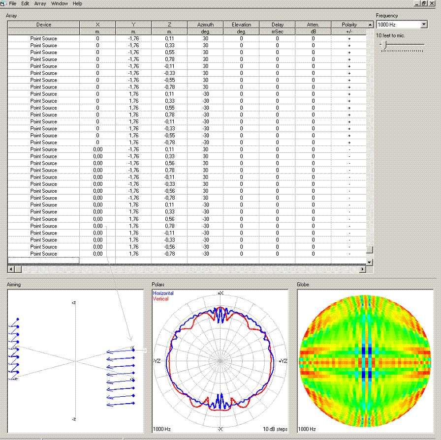

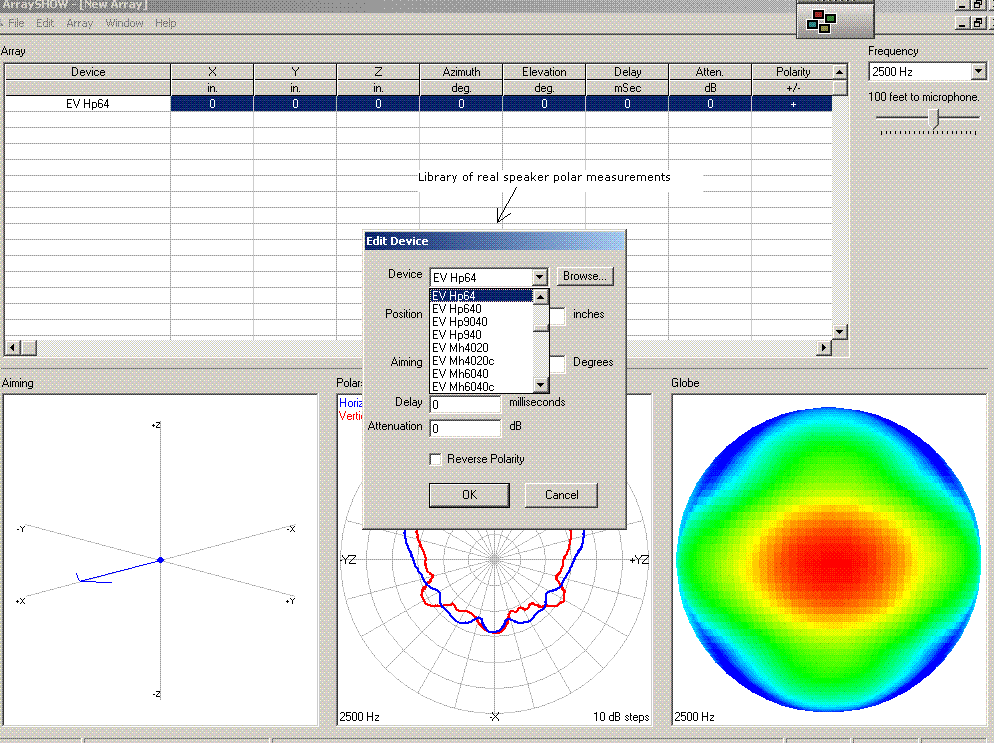

Hi all,

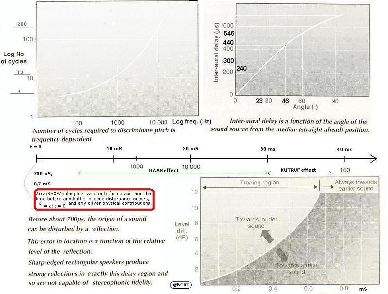

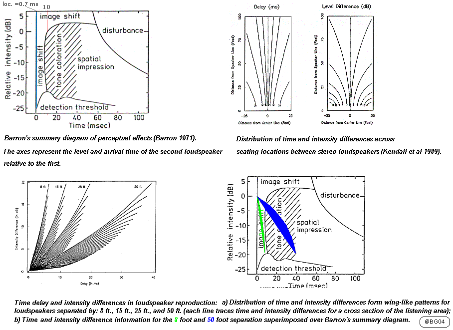

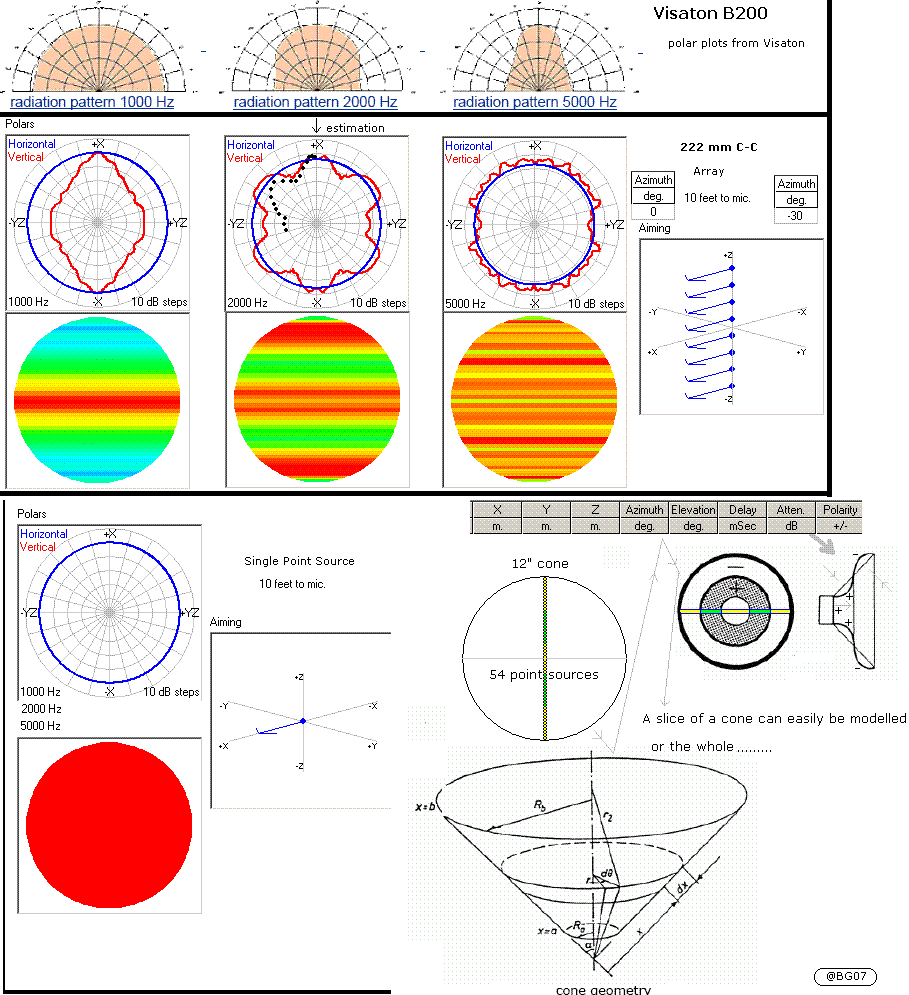

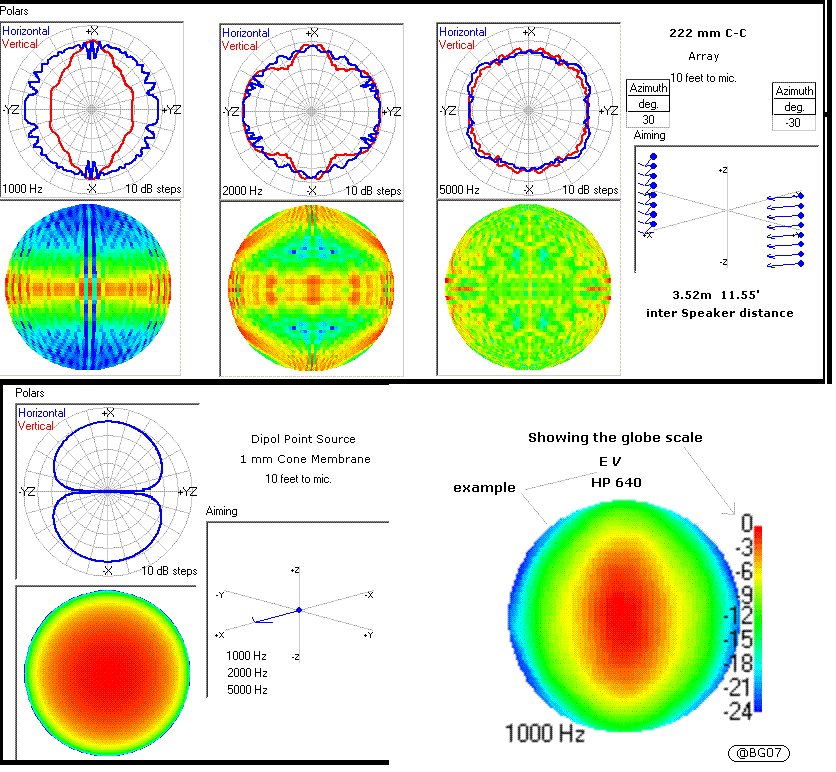

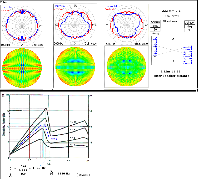

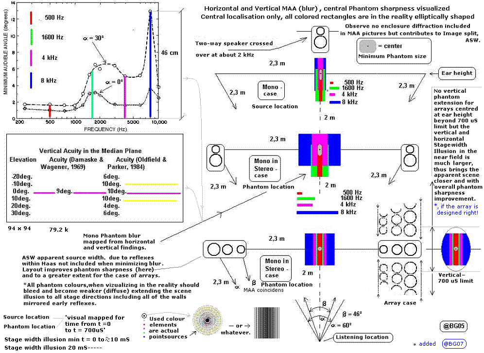

A lot of questions … For the moment Im too occupied to write extensive explanations, but if of any help; The ArraySHOW program is free and available from here:
http://www.electrovoice.com/tech-library.php?pt=3
Be sure to get version 1.1 build 63 as it works well almost without bugs.
Some further reading can be found at: http://www.prosoundweb.com/install/synaudcon/tt26_3/tt26_3.php

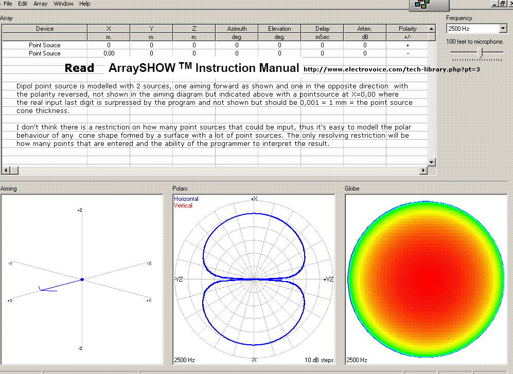

The main purpose of this program is the use for speaker set-ups using polar data from real measurements.
I mostly use the provided point source element for other various purposes like the transferring of my own real driver polar measurements to ArrayShow ….
Here is a link that might give an inspiration, addressing the part of ‘Behaviour of the cone in the frequency range’:
http://www.far-audio.com/modelisation.php

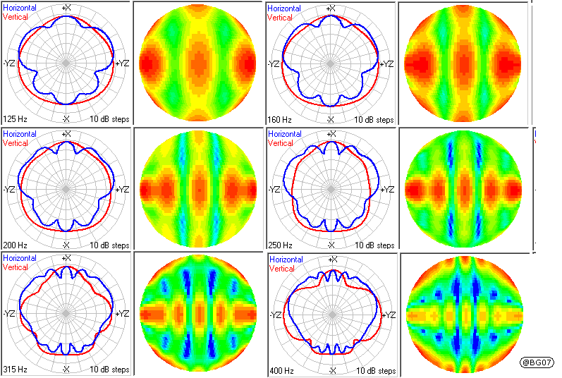

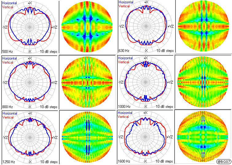

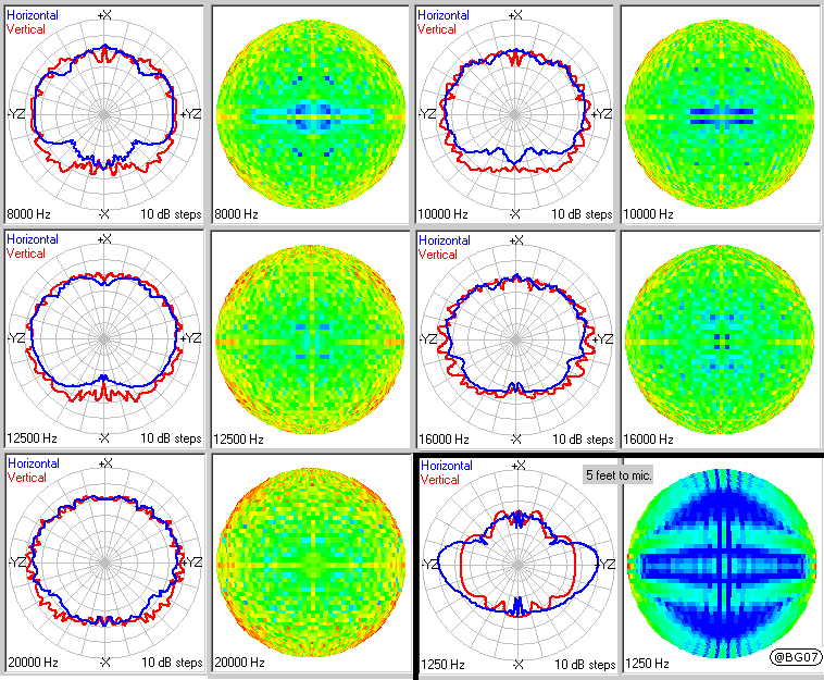

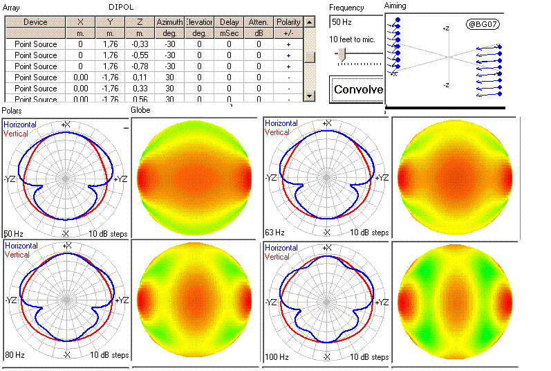

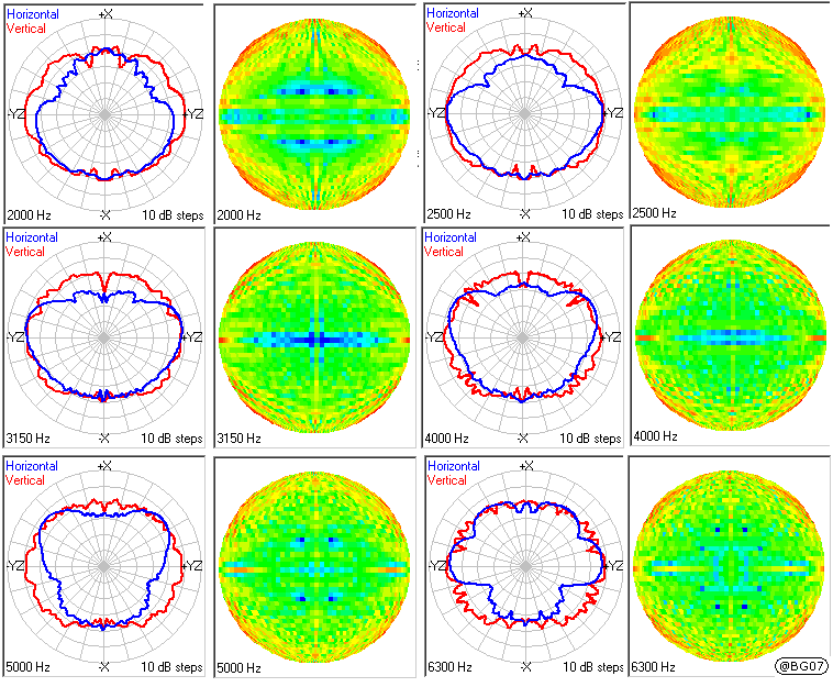

Im sorry you’ve found the resolution of my gif’s to low. I cut the first gif picture into 5 pieces and added a bunch. See the submitted pictures.
Tell me if some one wants any of the other to be magnified. It will take some time, as I don’t have saved any higher resolution copies, I have to redo all.

Good stuff, especially the last three charts! I noted the comment in the last chart about reflections in the 0~700 uSec region degrading stereo image perception - exactly right! Those distances aren't large - that's 10 inches or 25 cm, as you like.
Unfortunately, not only are sharp-edged speaker cabinets the offenders here, but so are closely-spaced arrays, when you work out the arrival-time discrepancies of a straight-line array. That's why I only want to use all of the drivers together at the lowest frequencies (below 125 Hz), first low-passing the 15" driver closet to the floor, then low-passing the driver above that, etc. I'd like to thank Zaph and Jeff Bagby for the "cascade" crossover that would be useful for the 2.5.5 ... n LF array.
Preventing reflections in the 0~700 uSec region is also one more reason to use curved edges on a dipole as well as heavy wool felt on the back surface and vertical mounting struts.
