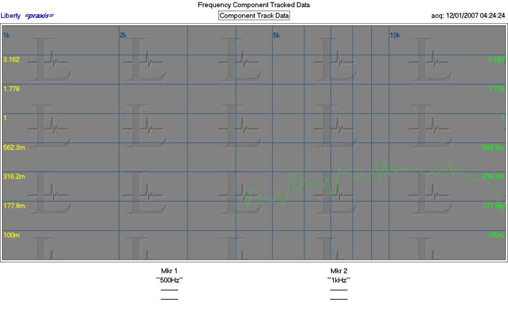

From the RAAL page (70-10):
The CSD looks really breath taking.
Are there any measurements on harmonics (2nd 3rd and higher ) at at least 90dB of more?
Any guess what the max-SPL at crossover frequencies could be?
Any FR that shows the 100kHz claimed?

Yes, the CSD of the RAAL ribbons are exceptional.
But there is also harmonics and max – SPL that matters among other – usually not an easy task for transformer driven speakers with very limited excursion like "real" ribbons.
Though I see it obviously works, to me it always seems kind of a miracle how a ribbon – having no suspension at all – will last for longer than a single sine wave.
We have to keep in mind that when the ribbon is moving it also MUST have a independent LINEAR force that brings it back to its centre position. With a suspension less construction the only mechanism you have for this is the flexibility of the aluminium foil itself. Aluminium - as any other metal - is very restricted in its fully reversible flexibility when pulled.
One other thing that has to be kept in mind is that the excursion of a ribbon is not restricted mechanically in the same way as a conventional speaker. A normal speaker runs definitely out of excursion when the VC reaches the bottom plate whereas a ribbon does not have that mechanical restriction to a "save operating area" making it prone to over stress of the foil.

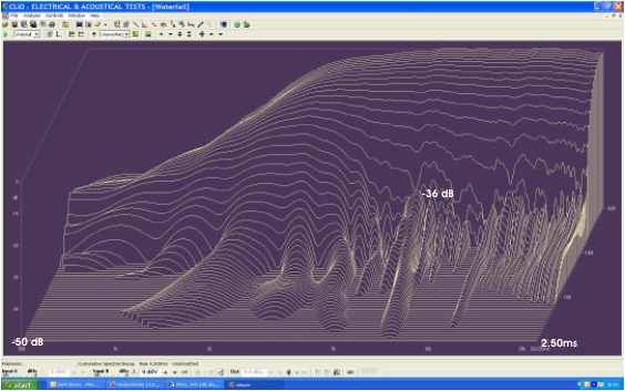

Someone may be interested to see RALL 140-15D waterfall

Yes, the CSD of the RAAL ribbons are exceptional. But there is also harmonics and max � SPL that matters among other �
Here you are 95dB appended (manufacturer data)
