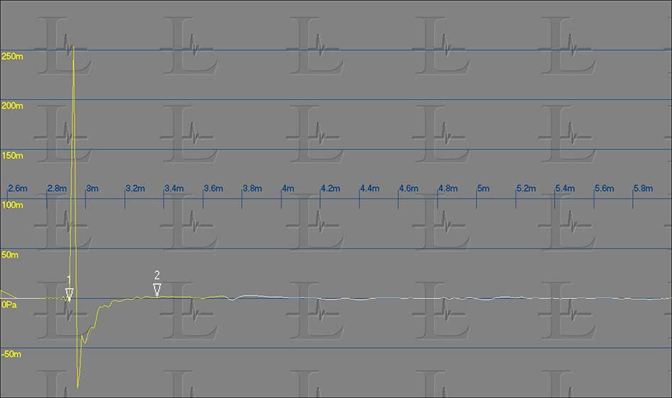

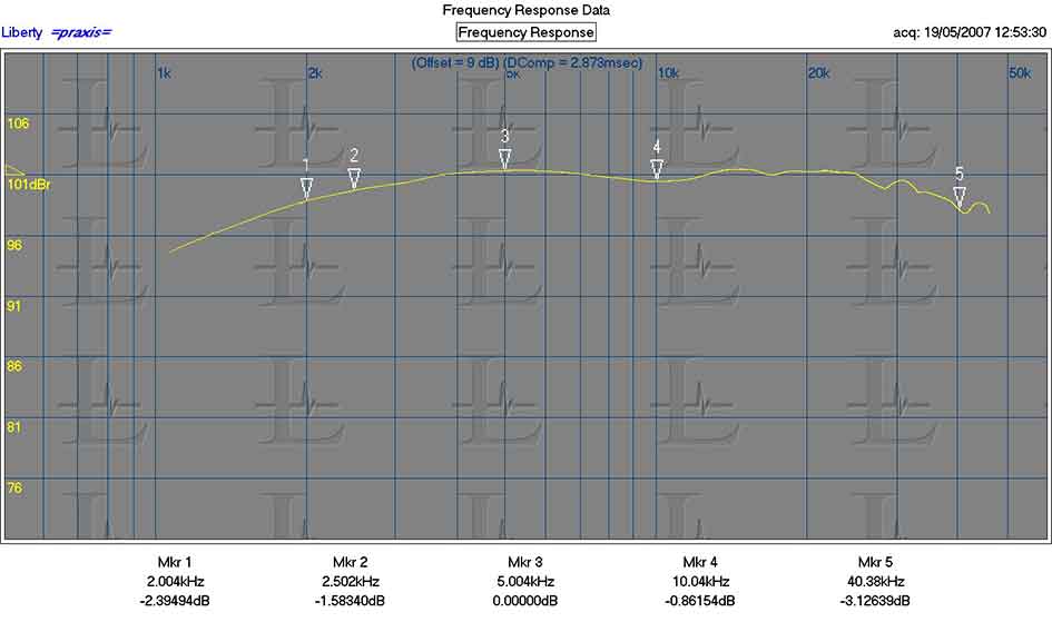

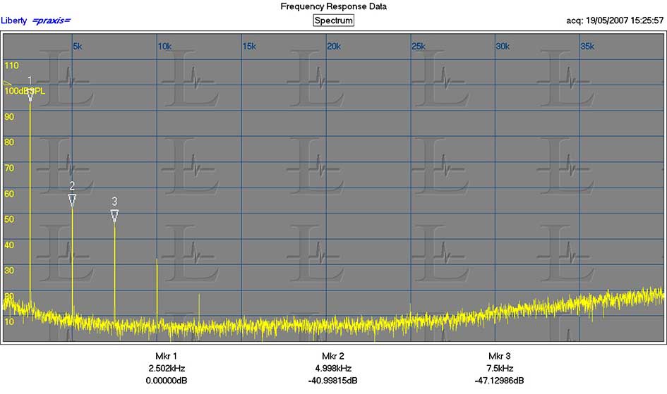

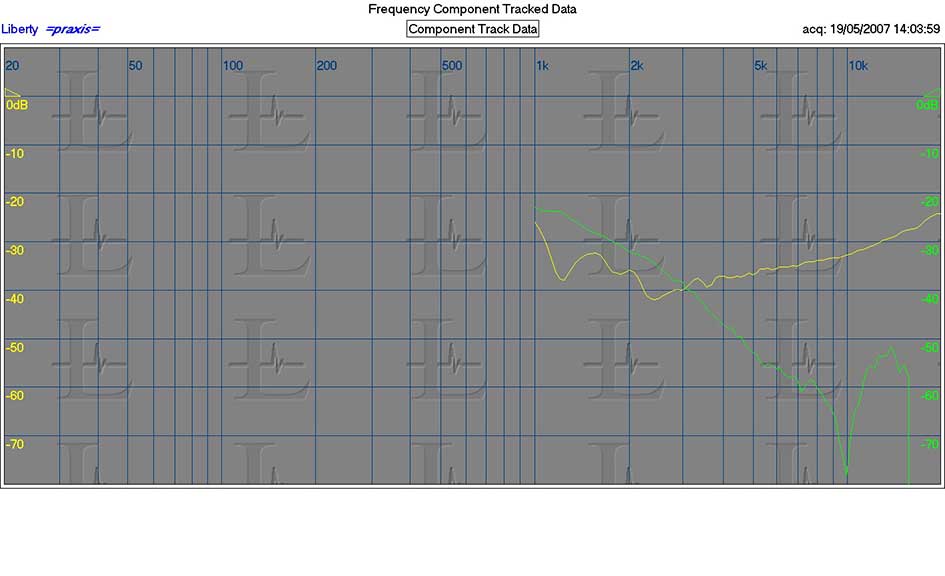

Good News: Studio Monitor RAAL Ribbons Are Out
Just got off the phone with Aleksandar Radisavljevic of RAAL, and he's making the double-high version of the 140-15 ribbon tweeter available to us DIY'ers and the prosound studio-monitor builders. The new tweeter is essentially two 140-15's stacked on top of each other with a new faceplate and newly designed foam dampers on the ends.
Let's get the bad news out of the way first: vertical dispersion is about 15 degrees as measured at 1 meter, although the RAAL foam pads help smooth the edges of the vertical polar pattern. The horizontal polar pattern is as wide as the other RAAL models. The other slightly bad news is the 4 ohms impedance - although this is completely resistive and non-reactive.
The good news: VERY impressive specifications for efficiency (100dB/metre), distortion, frequency response, impulse response, and headroom.
How much headroom? With a 2.5 kHz 2nd-order LR highpass filter, and powered by a 120-watt amp run into heavy clipping for an hour, no damage or specification change to the diaphragm. With a 200-watt amp run into less severe clipping, the driver delivers 121 dB at one metre, again, with only a 2nd-order filter at 2.5 kHz. THAT's the kind of spec I've been looking for.
Here's the first graph, showing frequency response as measured at 1 meter, with 5 dB/div.
