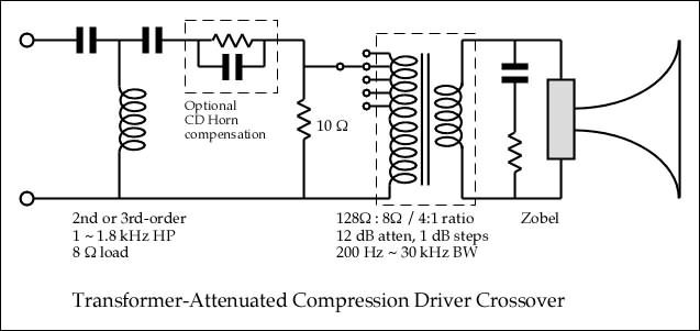

I was thinking of a sealed box, actually, since the feedback servo takes care of most of the distortion. The primary benefit of vented is substantially reduced excursion (and distortion) close to the vent frequency. With servo, that benefit mostly disappears, leaving increased SPL as the remaining asset - but with the drawbacks of vent coloration and a 4th-order highpass characteristic.
In a servo setup, what are the sealed-box DISadvantages? Curious to know.
It is interesting that Rythmik is addressing the same concerns that I'm looking at, just in a different frequency band. It does make you think about custom drivers for the Bass array in the OB, although that's a project for another day.
Ah - but the servo does NOT take care of most of the distortion - at least not around resonance. Think of it more as:
1. A very good motor design with triple shorting rings that lower distortion above resonance. The Dayton HiFi sub drivers from PE are largely comparable here.
2. Unlike the Dayton drivers - transient capability for an underhung, long gap high excursion design with a lossy surround, is radically improved *except* near resonance (..and even there its improved somewhat).
Basically the servo is increasing driver "control" both in the mass controlled and compliant controlled region. Its more effective in the mass controlled region (no surprise there), but while being less controlled at the lower end in the compliance region - a servo is perhaps better here than most designs. At resonance though, (and near resonance - which is "q" dependent), its still not very good.
Anyway..
Any given design shifts driver resonance up depending on driver param's and cabinet size.
The first question then is:
Where is the resonance in relation to the operating passband?
If possible we do NOT want this in the range of fundamentals. IF thats not possible we would rather have:
1. a narrow "q" design (usually a low qts value), and/or
2. a mechanical limiter.
Because we are operating the sub at higher freq.s - pushing the resonance up beyond our crossover isn't really an option (..and even if it was compliance related distortion is still a problem even with a servo - and then there is the excursion vs. spl problem and a distinct potential to "bottom-out" the driver).
None of the drivers are particularly narrow "q" designs - the lowest being the DS12CV with a qts of .327. So we move to a mechanical limiter.
Now the servo IS a mechanical limiter.. to an extent. I liken its capability to that of a "fine adjustment" control. What we need then is a "coarse adjustment" control - one that is specifically designed to keep the driver "in the gap" at and near resonance (..which is hard to do electrically). Of course a ported design provides this "coarse adjustment" control.
A ported design mechanical dampens and limits a driver's operation (..at least where the port air-load is mass controlled - i.e. above port resonance). It is however crude and "lossy" when compared to a servo (hence the "coarse adjustment" designation).
Now to get "maximum" value from the port design it needs to be "tuned" at *least* an octave away from the in-box driver resonance, and preferably further than that. (..again, its basically a extending mass controlled character to lower freq.s.) If its to close to the driver's resonance then you are potentially compounding the error by adding poor driver control to poor port control.
Of course at, (and particularly just below *port* resonance), the port is horrible. Linear and non-linear distortion are very poor in this region. The best thing you can do here is move it out of your fundamental range, (and even as far out into the harmonic range as is feasible). (Understanding of course that this puts additional excursion & thermal strain on the driver.. the lower the port tunning freq. is.) Another reason for a lower port tunning freq. is group delay, push it low enough in freq., (half octave + below any fundamental), and it won't be an audible problem even if at resonance its hovering a bit above 50 mil. sec.s. More importantly, combined phase has a nice gradual rotation in such a design (in the region above resonance).
A few more notes on Ported designs:
1. There is an obvious constraint on port tunning and port length - especially when factoring in a larger port "area". Unfortunately..
2. The port diameter should be large to keep the "slug of air" in the port and limit its excursion. (..otherwise you'll suffer from excursion limiting that will limit output at higher spl's.) Don't think that multiple ports vs. one large port are comparable, they aren't. While multiple ports have greater surface friction and reduce air speed and ultimately port turbulence, they do not decrease air excursion to the same extent (..and of the two decreasing air excursion is more important for most sub designs).
3. A good port design is preferable to a PR.. Linear decay behavior above resonance is usually a LOT better - in fact it may be better than the driver anywhere near this freq.., at least for the first few mil. sec.s (..which seem to have the largest effect on perceived clarity/transparency).
Need to chew on this for awhile.
Feedback systems are nothing more than input/output comparators. The Rhythmik is a feedback system that compares the input voltage of the amplifier with some sort of analog of driver acceleration (which directly corresponds to sound level). Since their sensor is not an accelerometer, there must be a conversion from sensor output (velocity?) to acceleration - I'm guessing there's a differentiator in there, as well as FR shaping to the desired contour.
The feedback summing node itself has no intelligence, and automatically compares input voltage to a phase and frequency-shaped feedback signal. Rhythmik doesn't disclose the feedback ratio itself, but it can't be too much (10~20 dB?), since the system is limited by stability criteria - this would be most troublesome at the top end of driver response.
I can see how the system operates in a closed box, since there's a 1:1 relation between driver acceleration and total sound output. Put in the shaping network to simulate the accelerometer and the desired frequency response, and boom, feedback will accomodate us. Not perfectly, but if there's 20 dB of excess gain (probably not that much) we'll see a 10:1 improvement in distortion.
Things are straightforward with a closed box, since the sensor is measuring real sound output, and correcting for distortion, level, and FR shaping, just like it would in an amplifier. Just like an amplifier, the degree of correction is limited by system-stability considerations - and just like an amplifier, full-power oscillation would probably destroy the speaker driver, so the design must be conservative.
Where it gets kinky is a servo-feedback vented system. At the vent frequency, most - 80% or more - of the sound is coming from the vent, not the driver. The Rhythmik system has no way of directly sensing the vent output - there's no mention of a vent microphone, which would be the only method that would work.
So it has to fake it, with a network in the feedback loop that simulates the vent, probably by peaking the feedback signal where the driver sensor output starts to drop thanks to the box frequency restricting driver motion. So the feedback network needs to be critically tuned to the Q and Fb of the vent/box system, otherwise system stability will be degraded due to excessive phase shift.
It bothers me that the servo-feedback vented system is not actually directly sensing the total output level, unlike the closed-box system. The proportion of system output that is coming from the vent is simulated, not measured directly.
This indirect approach seems to defeat much of the benefit of feedback. The whole point of feedback is accurate comparison of input and total system output, yet there's no way to sense the 80% or more of sound output coming from the vent (at the box frequency). It can't detect vent turbulence, it can't detect vent rectification effects, and the exact ratio of driver/vent output is only a mathematical approximation, not a direct measurement at the sensor. As we know, small-signal behaviour is not the same as large-signal behaviour, with the driver Qms, Qes, and compliance shifting fairly dramatically with high-level drive - the notorious in-and-out driver "breathing" we see with pulsed high-level drive being only one example.
The whole servo-feedback vented-box system just strikes me as kind of squirrely, while the action of the closed-box system seems simple and direct, since the sensor is directly sensing the total output waveform. With a vented system, it's only guessing what's coming out of the vent.
P.S. I am complete agreement about passive radiators, which seems the worst of all worlds - a vent with suspension nonlinearities thrown in for free. The finite compliance - the source of the nonlinearities - also adds a zero in the response around 1 Hz, which really gums up the transient response in a system that's already a 4th-order highpass filter.

Nice thread. The directservo configuration uses a combination of sensing feedback and current feedback. The purpose of the current feedback is to prevent local high Q peaks that can lead to instability at extreme operating conditions. It also provides a means for graceful degradation (the accelerometer based design does not have this, which is covered by our patents). In the vented box, it turns out the same concept can be used to flatten the output around the tuning frequency. For simulation, one can take a regular driver, keep all other parameters the same except with the Re value reduced to 1/3 to 1/4 of its original value, update the Qes and Qts values, and plot the FR. You can see it produces a basically flat frequnecy response with some shelf-up characteristic at mid bass. Our servo network can flat that out too. If the result still have slight peak at the tuning frequency, we uses a 2nd order HP to make it a flat 6th order FR.
Most people have a very narrow interpretation of the servo. In my view, servo is based on the principle of remote sensing. As long as one can insert a 10ohms resistor into the speaker wire and still have the same FR (max output will change though), that is servo. It does not need to have sensing feedback from all radiators. The advantage of this remote sensing configuration is that it increases the cone movement control, together with all other benefits I put on the web site. Reducing the Re to its 1/3 value is like using a magnet 3 times as big.
I once filed a patent application for a servo based on PR with sensing feedback from both active and passive radiators. It is mathematically sound and perfect. But I cannot get it to sound right, which to me is far more important. I think I figured out why it will never sound right. Later in the process the patent examiner incorrectly cited a Japanese patent, I didn't bother to pursue further.
Personally I like "sealed" servo over "vented" servo. I can voice the latter with a couple of different components to sound close to sealed. I am constantly puzzled by this, BTW.
Brian
Brian
Rythmik Audio
A big thanks for chiming in, Brian. I was attempting to read between the lines on your website, trying to figure how "Direct Servo" really worked. With no accelerometer or microphone, a sense coil appeared to be all that was left, just as shown in the animation. Combining VC current sensing with smart limiting looks like an elegant way around some really nasty stability issues that have long troubled active-feedback woofer systems. If the servo has the ability to synthesize an Re 1/3 that of the real value, I'm guessing we're talking about 10 dB of direct servo feedback.
If I read your letter right, the VC current sensing is used to evaluate the proportion of woofer vs vent radiation by analyzing the skirts and depth of the impedance minima at the box frequency, and uses that additional information to compensate for the big drop in voltage from the independent velocity sensor.
I get the impression an additional circuit within the feedback board is acting as a multiplier or some kind of dynamic level-sensor, and applying this shaped, signal-processed voltage to the summing node of the feedback network. All this is pure speculation on my part, but something like this would have the "adaptive" properties mentioned on the website. It would be intelligent feedback, able to sense and avoid the disaster of oscillation, and also smart enough avoid damaging the driver from excess heat or excursion.
If this extra circuitry is there, I imagine you've had a lot of fun looking at the dynamic error terms on a scope while playing music. If my guess is right and you've been looking at the dynamic error terms, the difference between sealed and vented systems was probably rather enlightening, and well outside the limited information in the published literature.
P.S. My instinct, having thought about it a bit more - is to go with a pair of 12-inch sealed subs, one per channel. Small cabinets, less annoying box modes. Keep it simple.
It is actually simpler than that. I am not a big fan of complex audio systems, which is very different from any other industry.
I hope I didn't mislead you. The term adaptive is merely to describe the difference between the EQ effect from servo vs the EQ effect from LT. There is no complex system in there. I normally advice against complex systems because they are harder to analyze.
Brian

That's reassuring, and refreshing, too! I'm not going to poke any further with groundless speculation about DirectServo and what's inside. What matters is that it works, and works on the problems that have troubled woofers for many decades.
I really like the appeal of servo feedback versus Linkwitz Transform. The feedback is just saying, "do this", and the desired FR and distortion improvement happen automatically.
With a Linkwitz Transform, you get the desired FR, but only at small signals. Large signals skew the Theile/Small parameters, perturbing the filter alignment. Distortion is also magnified due to substantially increased excursion, and you flirt with destruction of the driver if you get greedy and ask for too much.
The alignments that really bother me are the mathematical stunts like 6th-order active-equalized vented systems, or even worse, bandpass systems. All of these rely on linear small signal models - to implement rather tricky high-order filters. All it takes are suspension and magnetic nonlinearities to creep in and the model falls apart.
The servo thing is cool.
Years ago I used to tour with a rig that had processors that plugged in between the amps and the speakers. So it was sensing the current on the speaker lines, then looping some info back to the amps.
Worked pretty well, IIRC. Mostly it would just compress if the system was run too hard. Kept me from ever blowing it up, though!

Here's the HF crossover for the compression driver, using a minor variation of the Klipsch and ALK crossovers.
The transformer (or autoformer) has some interesting advantages compared to an L-Pad:
1) The load as seen from the HP filter falls in very narrow range between 8 and 10 ohms, no matter what the compression driver is doing (the transformer impedance ratio is the square of the turns ratio). This essentially gets rid of the interaction between the triple impedance peaks (induced by the horn cutoff) and the crossover. The crossover is so insensitive to the compression driver it makes very little difference if the driver is 8 or 16 ohms; both look pretty much the same on the other side of the damping resistor.
2) The source impedance as seen from the compression driver is equally favorable. Instead of seeing the series impedance of the crossover and the optional equalizer, it sees the 10 ohm damping resistor divided by 16, which equals 0.625 ohms. This virtual source is in parallel with the amplifier source impedance, so the source impedance is actually well below 0.625 ohms in the passband of the crossover. The driver behaves very close to a multi-amped system in terms of source impedance (damping factor).
3) The transformer is not going to be particularly large, since there is no requirement to handle low frequencies, nor does it need to handle any more than 50 watts (under the most extreme conditions). The Klipsch autoformers are tiny, less than a cubic inch. I'll be asking Bud Purvine and Dave Slagle to make this transformer for the project - it isn't that different than prosound 70-volt distribution transformers, just a higher-quality application.
4) The inductance compensation (Zobel) is there to be nice to the transformer, giving it a resistive load beyond 100 kHz. This simplifies the transformer design, and makes it easier to get good square-wave performance. The Zobel also simplifies the crossover design, as well as making a gentler ultrasonic load for transistor amps with marginal feedback stability.
