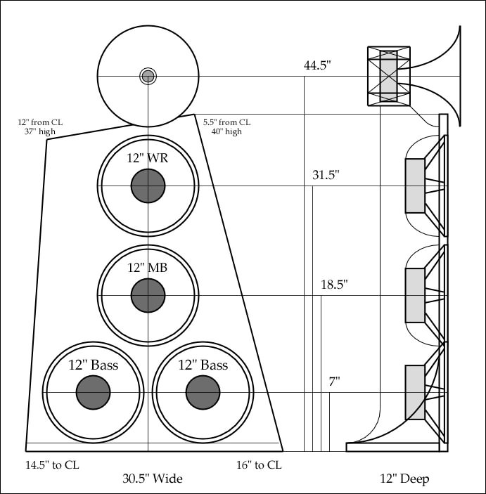

Stepping back a few steps and looking at the larger picture, the overall goal of the project is low intrinsic distortion and spacious sound. This was the goal with the Amity, Aurora, and Karna amplifiers, and they were met.
It's not so easy with loudspeakers, which usually have low distortion, lots of headroom, or spacious, wide-open sound. Electrostats have low distortion and spacious, almost distant, sound, but there's no headroom. To my perceptions at least, horns have an up-front sound that is thrilling in one way, but not so good at spatial impression (room size, height, ambience, etc.). As an old-time quadraphonic guy, this is important to me, part of what stereo is all about (not a mono fan at all).
The project as it sits almost splits Magnetar's suggestions down the middle: dipole from 70 Hz to 1.2 kHz, and something like the Radian 745PB (3" diaphragm, 1.4" exit) for the high frequencies. But there's a method to this: if we want constant directivity when transitioning from a 12" driver to a 90-degree horn, we can follow Geddes' example and cross where the diameter of the woofer equals one wavelength. Thus, 1.2 kHz (in practice adjusted for best phase match between LF and HF drivers at the crossover frequency).
I'm still considering a rear horn, as well, on the rear side of the baffle, tucked between the midbass and widerange driver. I don't think it'll need to be identical to the front horn, but made from similar diaphragm materials, at a minimum. If the Radian 745PB is on the front, the Radian 465PB on the back might be a good companion, running at reduced level (-6dB), and with a crossover slope and frequency designed to maintain constant power into a sphere. This can be confirmed by measuring off-axis all the way around the speaker, and more importantly, total power into the room, as measured on a flat surface.
You can see where this is going. Low IM distortion, ample headroom, and constant dipole directivity from 70 Hz to 20 kHz. In the below-70 Hz region, stereo subwoofers are essential for maintaining spatial impression, preferably placed as widely as possible, even at the sides of the listener. It might even be desirable to have four subwoofers, at each corner of the room. This would maximize the left-to-right velocity component, which is responsible for LF spatial impression.

Hmm ... thinking about the waveguide/WR driver comments made earlier. I have a utilitarian view of horns - I'm not really a horn fan, and haven't really warmed to their sound that much. I appreciate the efficiency and low distortion, but don't like the HOM, horn-edge diffraction, and other time/dispersion maladies - and those are very difficult challenges that a lot of smart people have been working on for a long time.
The HF horn is there - well, because aside from the exotic prosound ribbons, there is no alternative if you want 97+ dB/metre efficiency and low IM distortion. I don't see a vertical line array of dome tweeters as a realistic alternative, with their intrinsic problems of non-synchronous arrival times at the listening position.
But a horn for frequencies lower than the HF horn is an esthetic choice, not a technical one. Below 1~2 kHz, arrays of direct radiators can do the same thing, but with somewhat different tradeoffs. The midbass horn will have (much) lower IM distortion, but at the expense of (inevitable) HOM modes and associated transient disorders. The cone array will have better impulse response and broader dispersion, but not as clean IM distortion. You pays your money and you takes your choice.

The Story Continues ...
This is a Quad-12 array, more attractive looking than the previous drawing, and it offers the possibility of one 18Sound 12NDA520 or 12ND710 (the latter available in 8 or 16 ohms) for the widerange driver, one ToneTubby 12" Alnico in 16 ohms, and two ToneTubby 12" Ceramics in 16 ohms.
In terms of connections, the HF and 12" WR share a high-quality amplifier, the 12" Midbass and Bass share an amplifier (possibly a 35~60 watt tube amp), and the subs are independently powered.
If the 16-ohm ToneTubby's are chosen for the MB and B drivers, the Bass drivers can be wired in parallel, low-pass filtered by a single series inductor, and the 2x12 Bass array (with filter) wired in parallel with the single 16-ohm MB ToneTubby. At the lowest frequencies the combined impedance is about 4.5 ohms, the efficiency is about 103 dB/metre, Fs is 78 Hz, and Qts is 0.85. For the cost-conscious, no, it's not a cheap speaker, but the ceramic ToneTubby's are half the cost of the Alnico version - and TT themselves recommend mixing-n-matching the two flavors.
Downsides? I wouldn't expect a lot of linear Xmax from guitar speakers - although I can say from personal experience a single widerange ToneTubby plays really loud, and with none of the usual cone-breakup crud. A 3x12 array of these things would probably put you on stage with the musicians.
