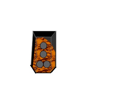

Finally, a suggestion re: cosmetics: Another of my thought experiment speakers :)rolleyes:), never built, was an OB with a trapezoid baffle shape, but folded back around a square cross-section "wireframe" column (using wood of course). The areas of the column that should be left open would be covered with black speakercloth. That would give the appearance of column speakers while preserving the OB character, and with a trapezoid foldback you'd hardly have much cavities in the back to watch out for.
Ugly sketch attached.
re: aesthetics. I was thinking of making a more visually appealing shape in wood or colored baffle and using clear lexan for the rest of the baffle, or in front of the solid baffle. This way you have acoustically the better shape while visually a more pleasing shape.
Its not my idea really as I have seen this done by someone on another forum and the results were quite nice.
