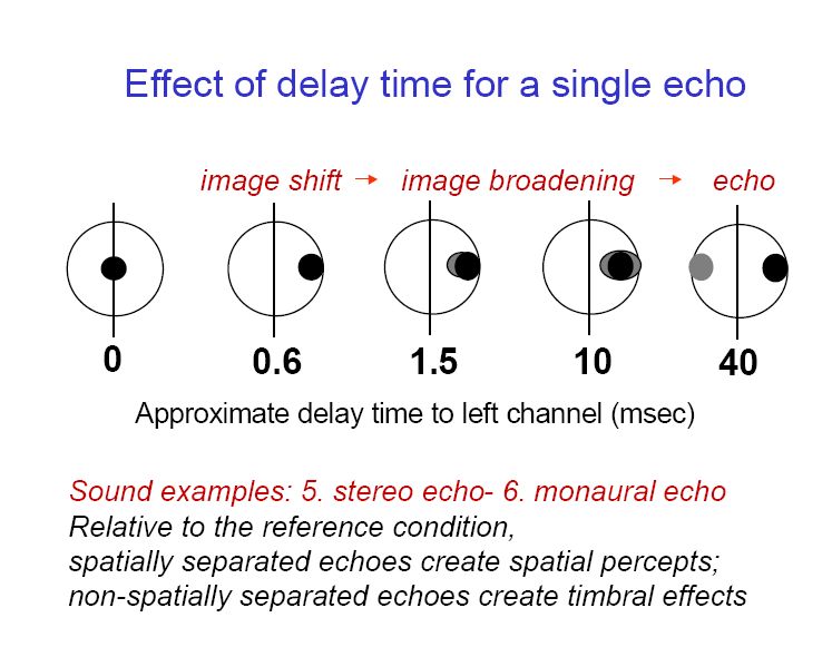

Somehow I doubt that the shape of the wavefront has something to do with perception of size. The mechanism that gives us the apparent source width of a low frequency source according to conventional wisdom, AFAIK is the envelope of the LF signal. In other words it is the higher frequency part of a real world signal, and its spread-out arrival time to our ears if the source is large, that conveys the size.
This also explains why stereo sounds larger than mono (directional clues nonwithstanding) and why line sources may seem to sound larger than life. Both have to do with large arrival time differences, in stereo it's L vs. R, in a line source it's the higher vs. the lower part of the line. And even a mono source that is physically large should sound "larger" than a small mono source.
So why would horns sound "large" then? Same thing: mouth diffractions from a physically large mouth, generating arrival time differences for largeness perception. An artefact in other words.

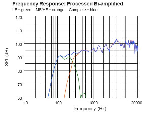

See a single EAW KF-730 satellite measurement. It is crossed and processed for fitting in a usually no less than 8 cabinet array.

My point is that the near field shortens the lower you go in frequency and this correlates with your (right by my reckoning) assumption that the transition is gradual in reality and not infinite. In practice I have never experienced anything infinite or anything mathematically absolute in nature. All stuff averages out in certain tendencies and no absolutes or infinity.

FWIW I finally found the sketch on time delay perception, from a presentation by Begault et al., attached.
