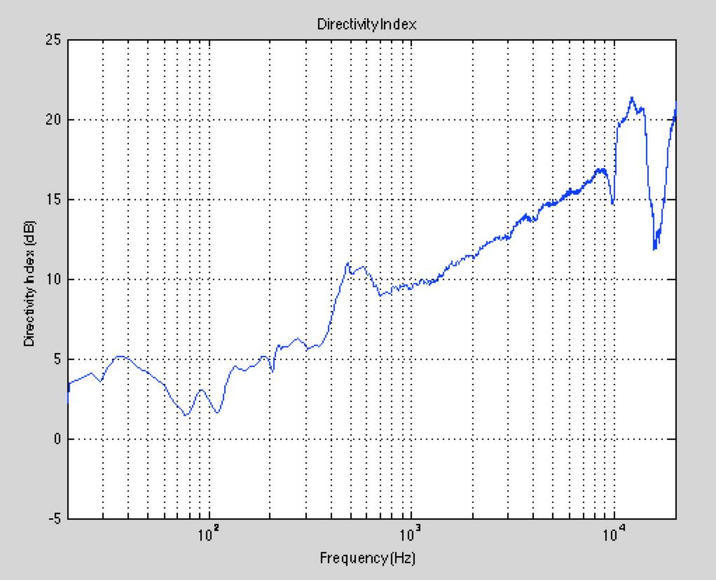

I have been thinking of the problems associated with the change in directivity-index when a horn (any horn) is crossed over to a direct-radiator bass driver. Constant-directivity horns stay close to 90 degrees over the working range, while the JMLC is variable-directivity, but even at the lowest working frequency, the JMLC directivity is still something like 120 degrees or so. No matter what kind of horn is used, the back half of the sphere is largely dark.
In contrast, the bass driver is directive at the crossover frequency, but an octave lower, it's getting close to omnidirectional. In the space of an octave, the DI has gone from something like 4~6 to close to unity. That has to be audible, no matter what the on-axis frequency response is. Walk around a horn/direct-radiator hybrid, and you hear rumble-rumble, and no HF at all, when you walk around the back. The bass is omnidirectional while the rest of the frequency range isn't.
The only ways I can think of to make the bass range more directional (so it corresponds roughly to the lowest DI of the horn) is a pretty large bass array (which are notoriously prone to lobing), the aforementioned dipoles (with all of their problems), or a bass horn (where size, weight, and cost are traded against the cutoff frequency).
The only other way might be a cardioid bass radiator, which gets us into weird territory pretty fast. Following the example of microphones, that might involve an omni (closed-box) in close proximity to a dipole, with some tricky time and phase adjustments between the two.

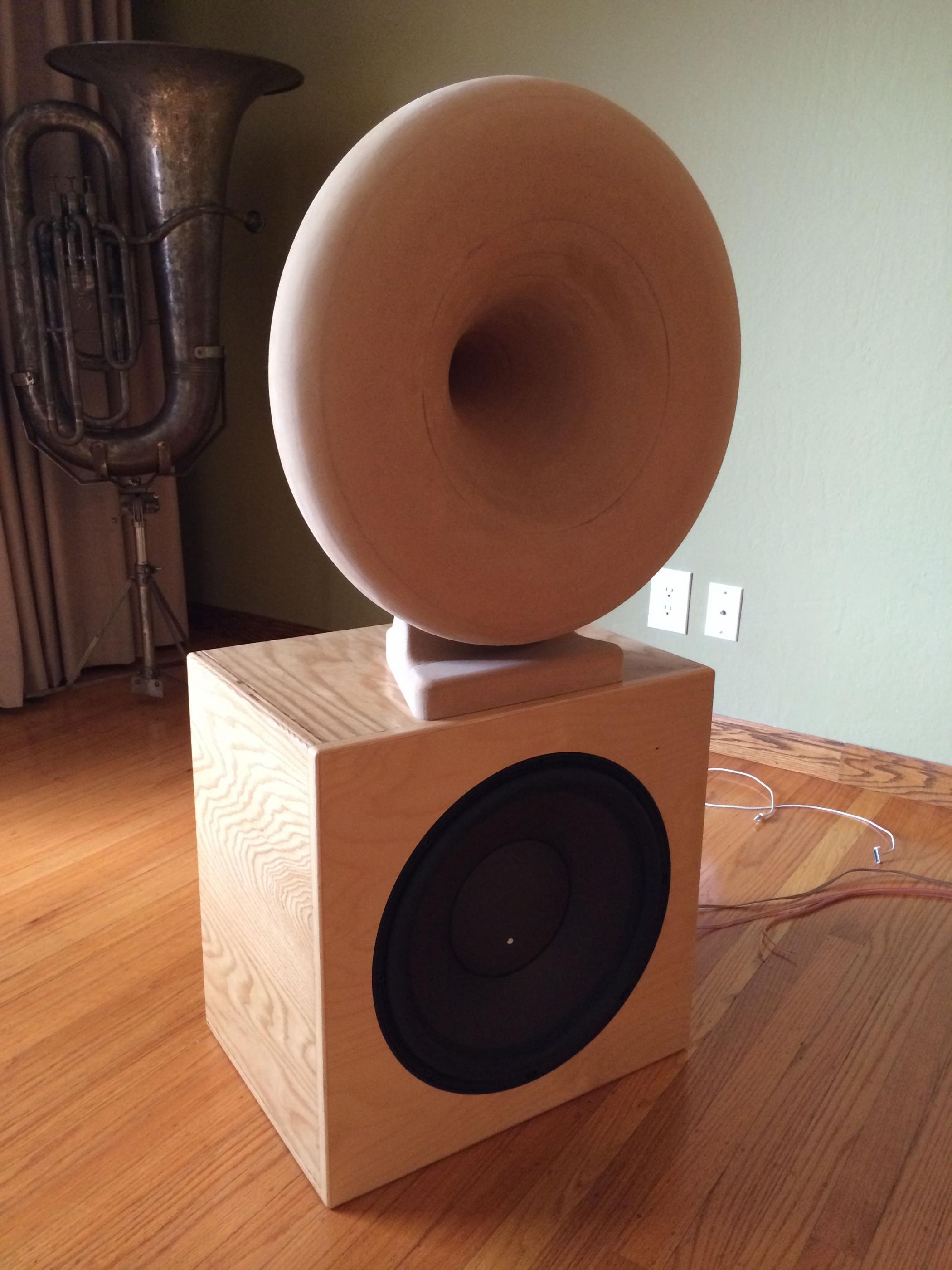

If you make the horn about the same size as the woofer (or a bit bigger for a LeCleac'h with a full round over), the DI should match pretty well through the crossover. I'd imagine that's pretty close to what you have. This is what I am listening to at the moment and the DI is almost a straight line from where it's omni at LF to whatever it is around 10k (due to using a 1.5" throat JBL driver). There's just a bump due to the vertical separation at crossover which I think I could get better in my system by massaging the crossover a bit more. I've only taken one cut at it so far and am waiting for another go until I upgrade my woofers. The horizontal match is about perfect.

Wow! Very elegant system, I'm impressed. Looks gorgeous, too! Your measurements show a very smooth increase in DI, as I'd expect from a JMLC profile. One of things I like about a JLMC is the very smooth edge of the pattern, with a soft decay, and the smooth change in DI with increasing frequency. It is very much not a PA speaker.
What I was mentioning in the previous post was the DI between the LF range (100 Hz to 500 Hz) versus the DI in the MF/HF range (1 kHz to 5 kHz). This is most obvious when you play music and walk around the speaker. A JMLC has the merit of no sharp changes as you walk around (with conical horns, I hear a blink-on and blink-off effect at the edge of the pattern), but things are very dull indeed when you're directly behind the speaker.
Why do I worry about extreme off-axis sonics? Well, the first 20 milliseconds are dominated by first, second, and a few third reflections from the back and side walls, and the floor and ceiling. The reflection off the back and side walls are from extreme off-axis emission angles, 90 degrees or more. The net result is that most reflections off the back and side walls are much duller-sounding than the first-arrival wave from the front of the loudspeaker.
The total room spectra (all of the reflections summed over 3 to 20 mSec) are duller sounding than the on-axis response of the loudspeaker, since most of the reflections originate from emission angles that are well off-axis, and these have little HF content. (Conical horns are strong to +45 and -45 angles, but drop like a stone outside that, and emission at +90 and -90 are well down in level, and sometimes very uneven in response.)
This creates a minor problem in subjectively equalizing the speaker so it sounds flat. Although the direct sound dominates the overall spectral impression, the room reflections play a role as well. I equalize a speaker so pink noise sounds flat, but that won't necessarily be the right EQ for music. Pink noise is a good method for subjectively assessing low-level CSD resonances, but it doesn't tell you anything about transient response. That's where a series of clicks or certain types of percussive music (including piano) may be more informative.
